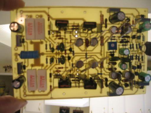

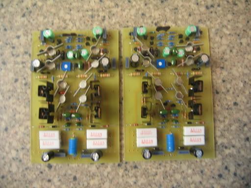

Well, I finished populating my boards.
Here are a couple of pictures.
Now on to drilling the heatsinks and building the PSU. 😀

If you look at my boards you'll see that I opted fopr the two polar caps. Not sure why. You'd think if the guy who designed the amp said to use less I would, but I didn't.
Blessings, Terry
Blessings, Terry
That last picture looks smashing, Terry.
Maybe one day i'll build an open view amplifier with a couple of bright high power leds under the pcb to see the board traces.
I could watch the tube amps i built when they were glowing for hours.
