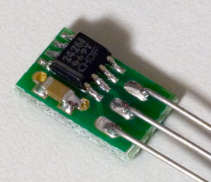

Does anyone has an idea if it´s worthwhile to change the TLE2426 to a package type with Noise Reduction Pin?
The ouput noise voltage will drop from 120µV to 30µV and the line ripple rejection is improved.
A small adapter could handle this like on the attached picture.
