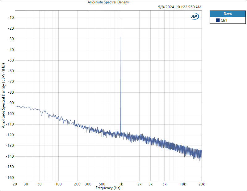

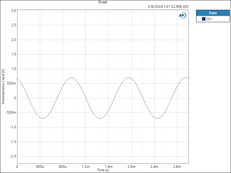

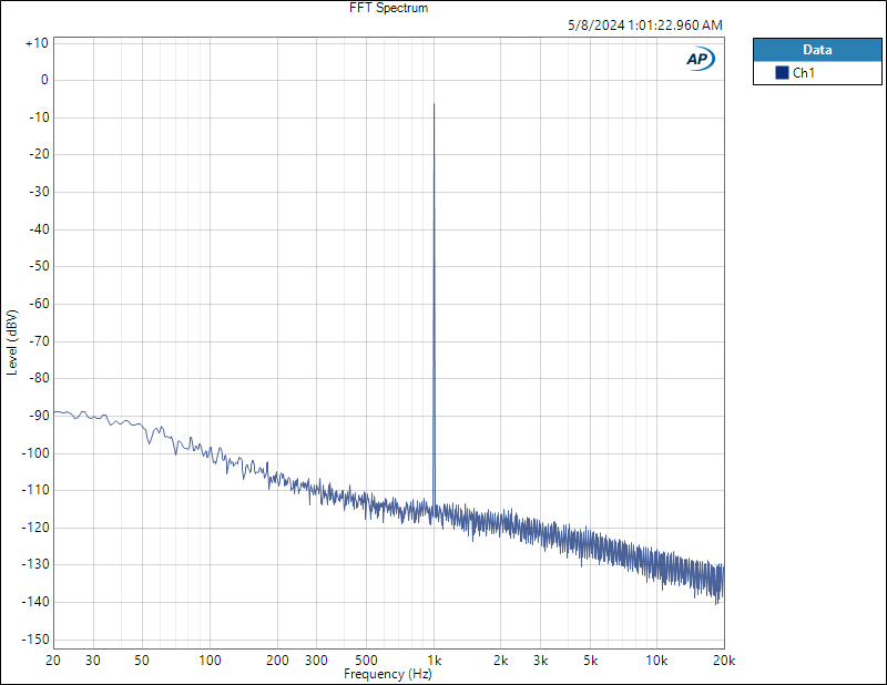

Hello @6L6 and All,
Thought that I would wake up this thread.
Looking for lower gain than the Pearl 3 that clocks in at 50dB on the low setting. I thought that I would give the Bugle a try.
I went on ebay and purchased a Audiowind A400 assembled PCB for about $40.
Just for fun I put together a perf board with the 7815 and 7915 15 +/- regulator power supply as used on the Pearl 3 PCB's. Turns out that the Bugle Per-amp uses Op-Amps without other noise sources like JFETS. Pluss the Op-Amps all on their own have high power supply noise rejection.
Since the early days Op-Amps have come a long way, they have low noise and distortion below the ability of the current crop of audio analyzers ability to measure without special tricks.
I replaced the Op-Amps that came with the Bugle clone with OPA1656's on BrownDog SOIC-8 DIP Adaptors.
With 5mVrms input the voltage output is 0.494Vrms.
The gain is 39.9dB
The THD+N is 0.036%
the SINAD is 68.3dB
There are no distortion peaks above the noise floor.
There are no power supply Harmonics above the noise floor.
At 40dB gain this RIAA Pre-Amp measures as good as any.
This Bugle clone sounds awesome. At 40dB gain there is plenty of headroom and there is no need to burn a lot of gain in the the volume control.
See the attached plots.
Thanks DT
