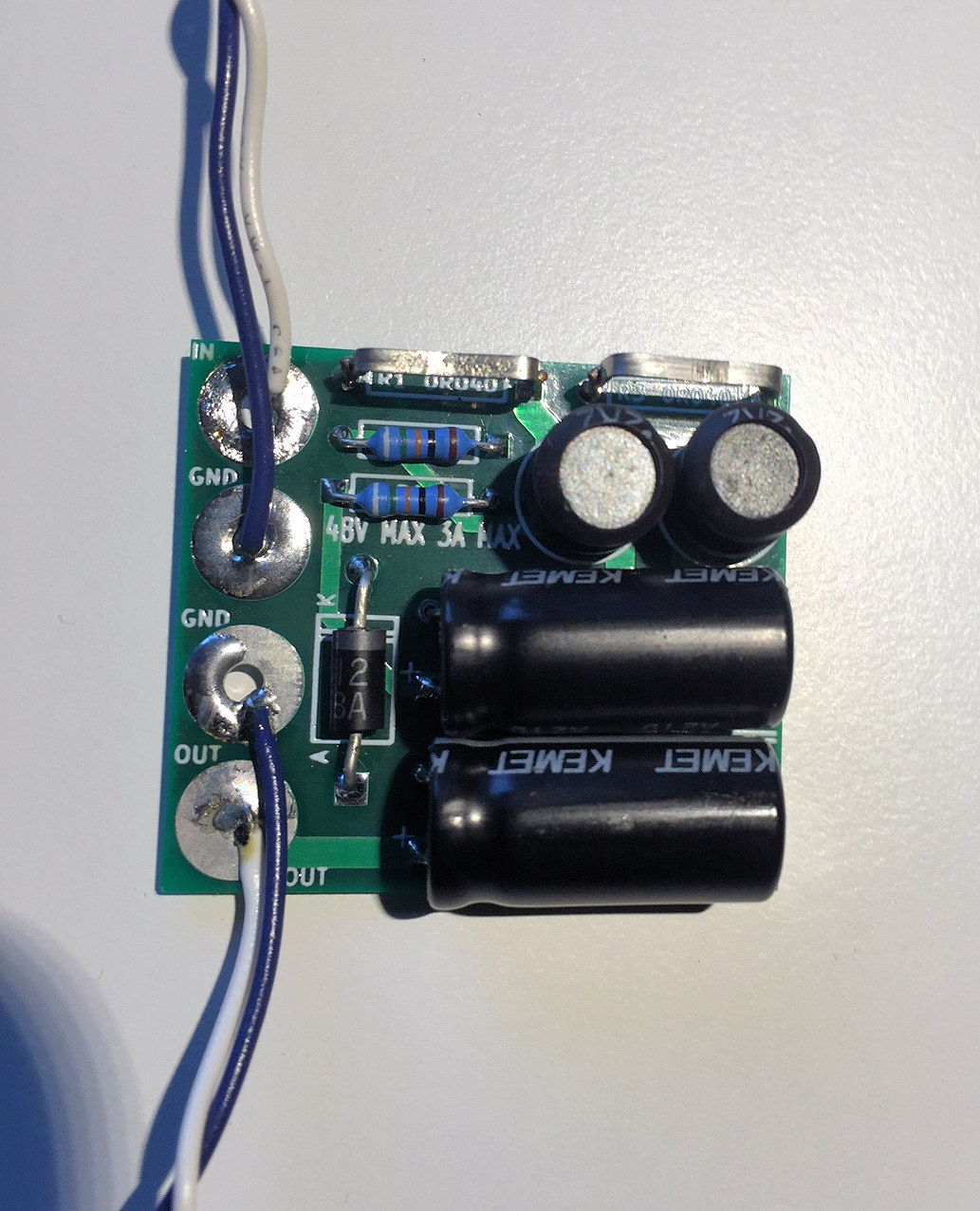

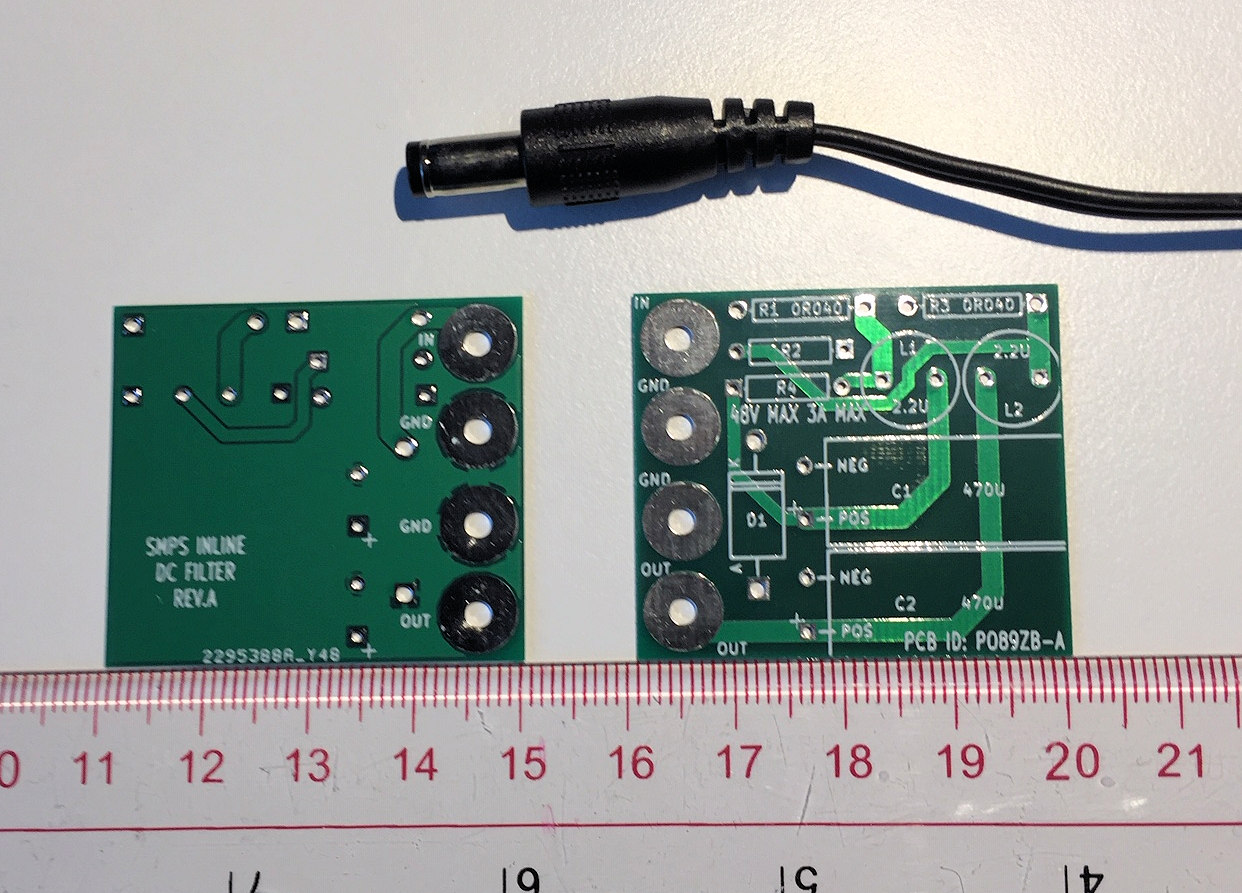

A very quick and inexpensive "hey let's give THIS a try" experiment, is to install an LCLC filter in series between an SMPS wall-wart, and the audio gear it powers. You just plug the barrel jacks together, don't even need to open the chassis. Several diyAudio members have reported great results when doing this with the Korg NuTube B1 linestage kit from the diyAudio store.
PO89ZB , an inline DC filter for SMPS wall warts . Preamps, HPA, Korg NuTube, etc

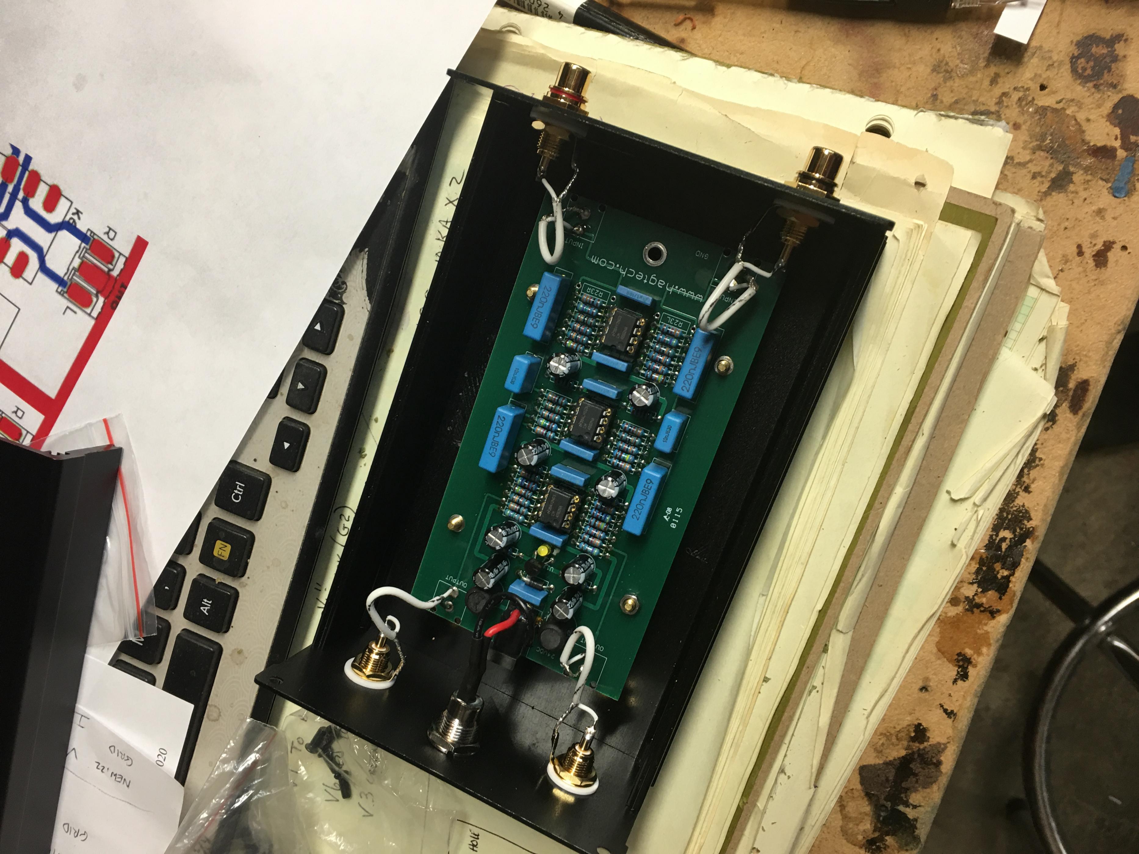

Seems the “Hag” picks up interference...regardless of supply so hard to determine. If I wrap my hands around it, it gets quieter but doesn’t go away....hummmm. Back to the shelf!
That's odd. Mine doesn't. My system is totally upset by the presence of a Raspberry Pi—weird robot gurgling in both channels on all inputs (not just the phono). If I power off the Rpi it's nice and quiet, even with lowly OPA2134 op amps. Hum is only audible if I stick my ear in the woofer.
What kind of case do you have yours in? Audio pcb and psu in one chassis? Mine is connected by an umbilical, both pcbs in black steel enclosures.
Oh well. Sorry to hear yours hums. That would be a deal-breaker.
Post 182....original case

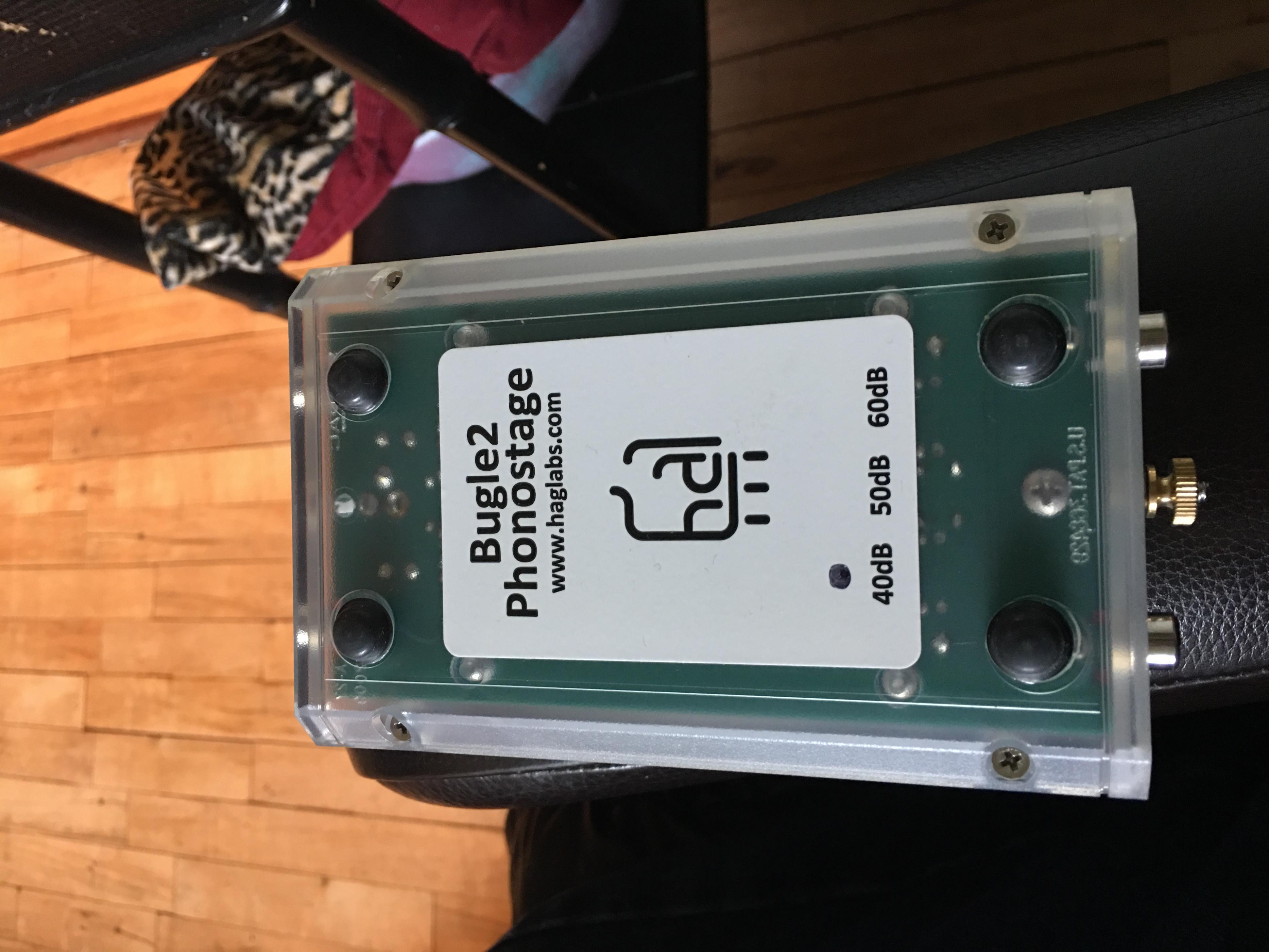

Ah, translucent plastic case = no shielding
Maybe if it was in a metal, shielded enclosure, with the signal grounded to chassis at the input?
I’m on it! Thanks
Better? Need to add ground stud, then ground case.
Absolutely! One has to wonder why Jim decided to reduce mfg cost so much that he used a plastic case?
Metal case, yes - which is grounded - would solve the problem.
But I wouldn't connect input signal ground to the case - I would use an earth terminal on the metal case and connect this to the earth terminal on another component (like a preamp) which has a 3-wire mains cord ... having the earth pin on the IEC input socket (or the earth wire in the mains cord) connected to the (metal) chassis.
Andy
