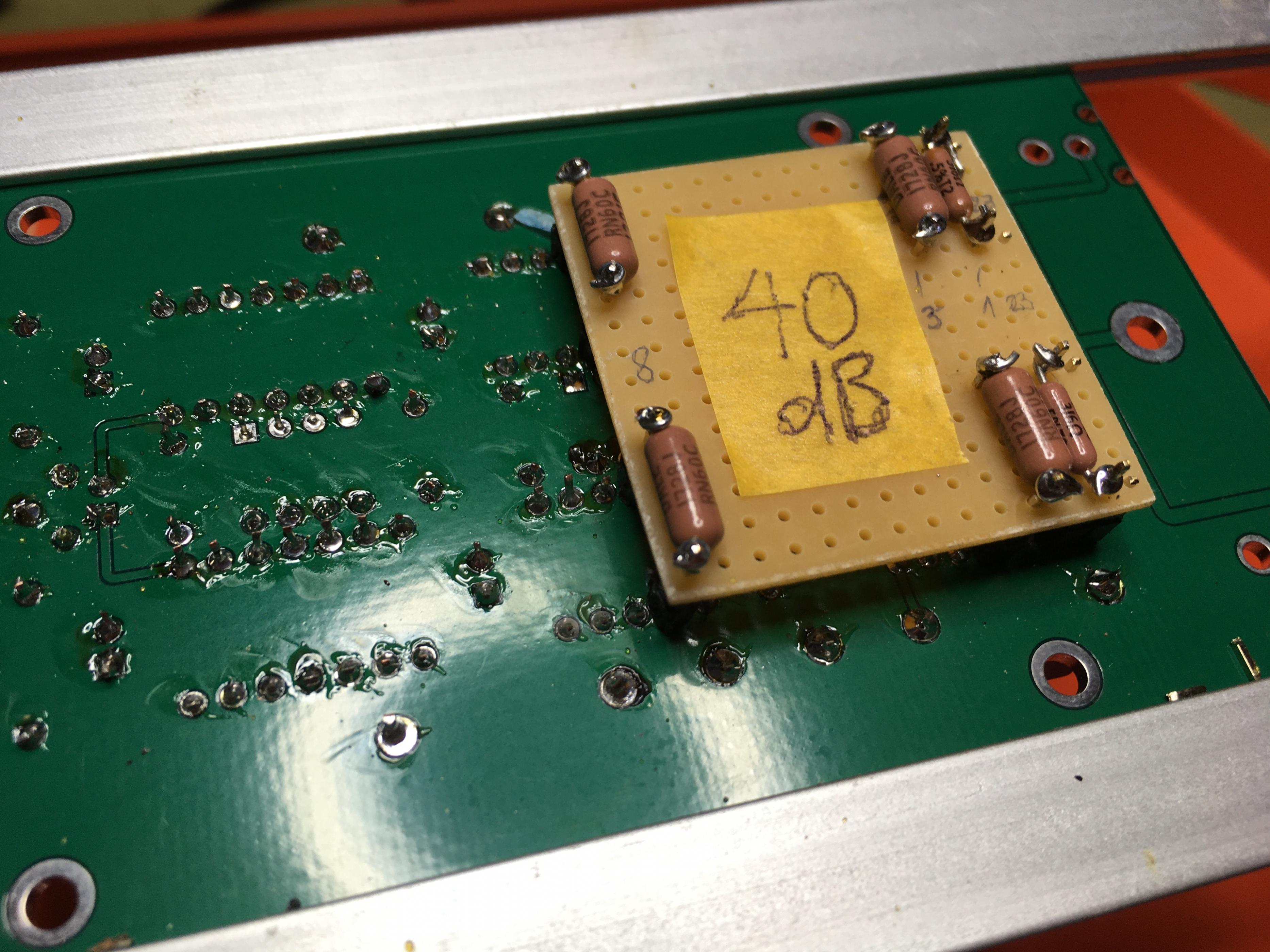

Because RN series are US MilSpec and 100% derated. So it’s a 1W resistor that says 1/2w on the datasheet.

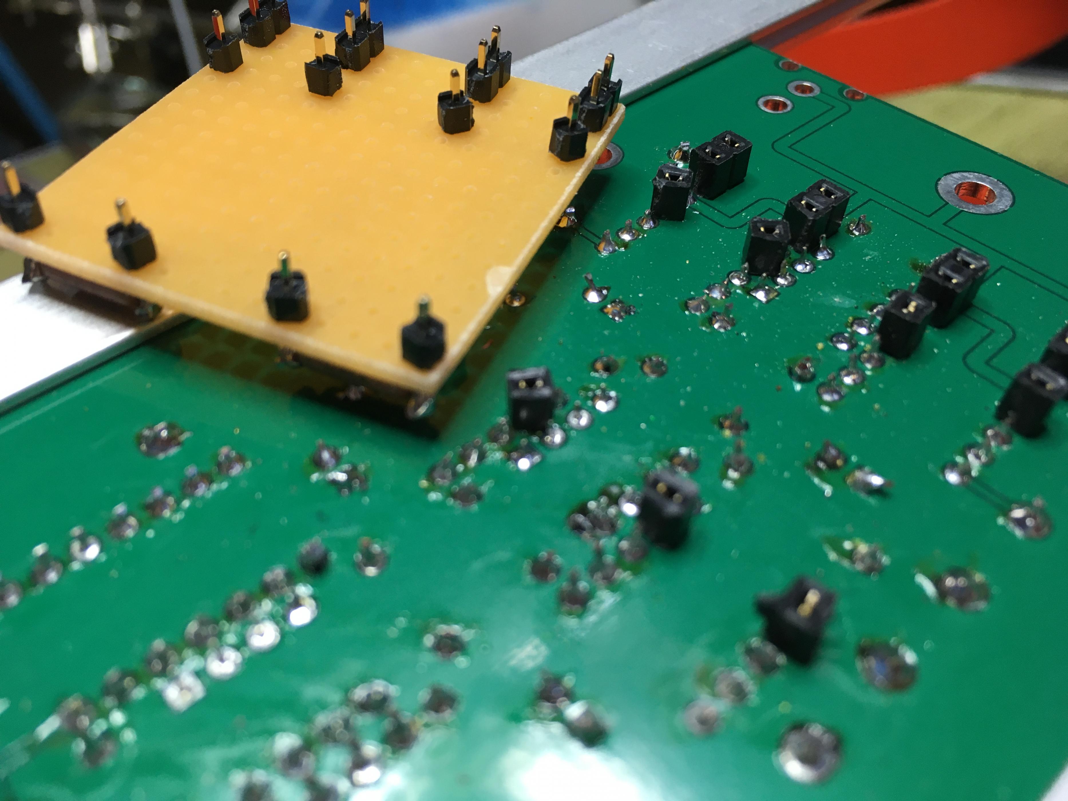

Those big buggers rather look like 5W 😀 although they're 0.5 (I double-checked)
I agree, they are enormous.
I'll call them the huge soundstage-resistor 🙄

Not much is left to be done, like, connecting the thing, making holes in the chassis, and probably one more thing I forgot.

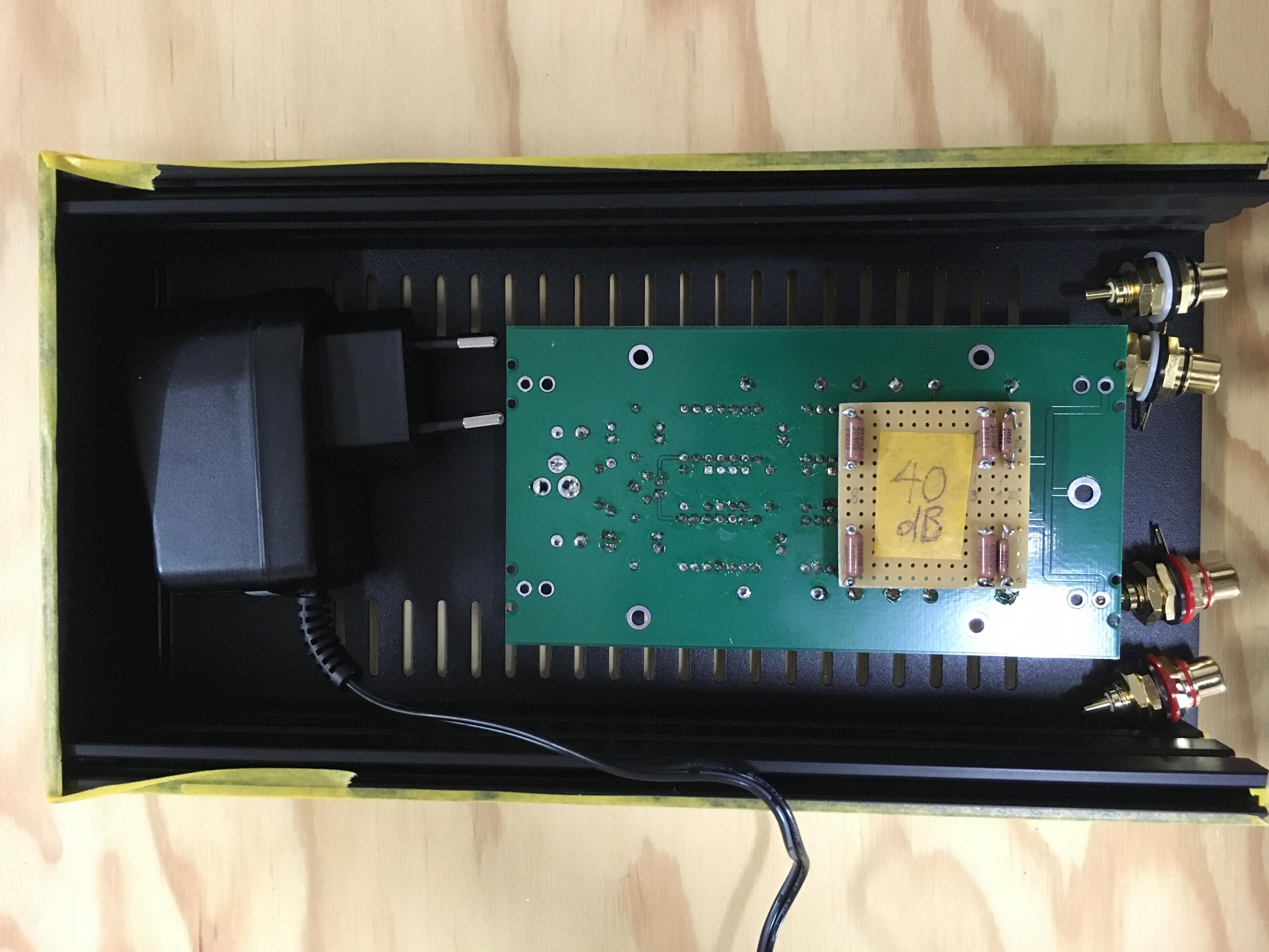

I had to get a different box because I tried to be smart. Having a little collection of medium to fine cartridges (ortofon bronze thing, a DL103r, a Benz Micro medium range thingie, I thought I'd be better off if I was prepared for resistor-rolling, so I made them onto (kinda) breakout-boards.
Of course I got my inspiration from 6L6's build
Since the chassis is way too big, I am thinking about placing the brick into it (behind a steel box?) and pull the cable underneath the chassis to avoid issues... bad idea?
