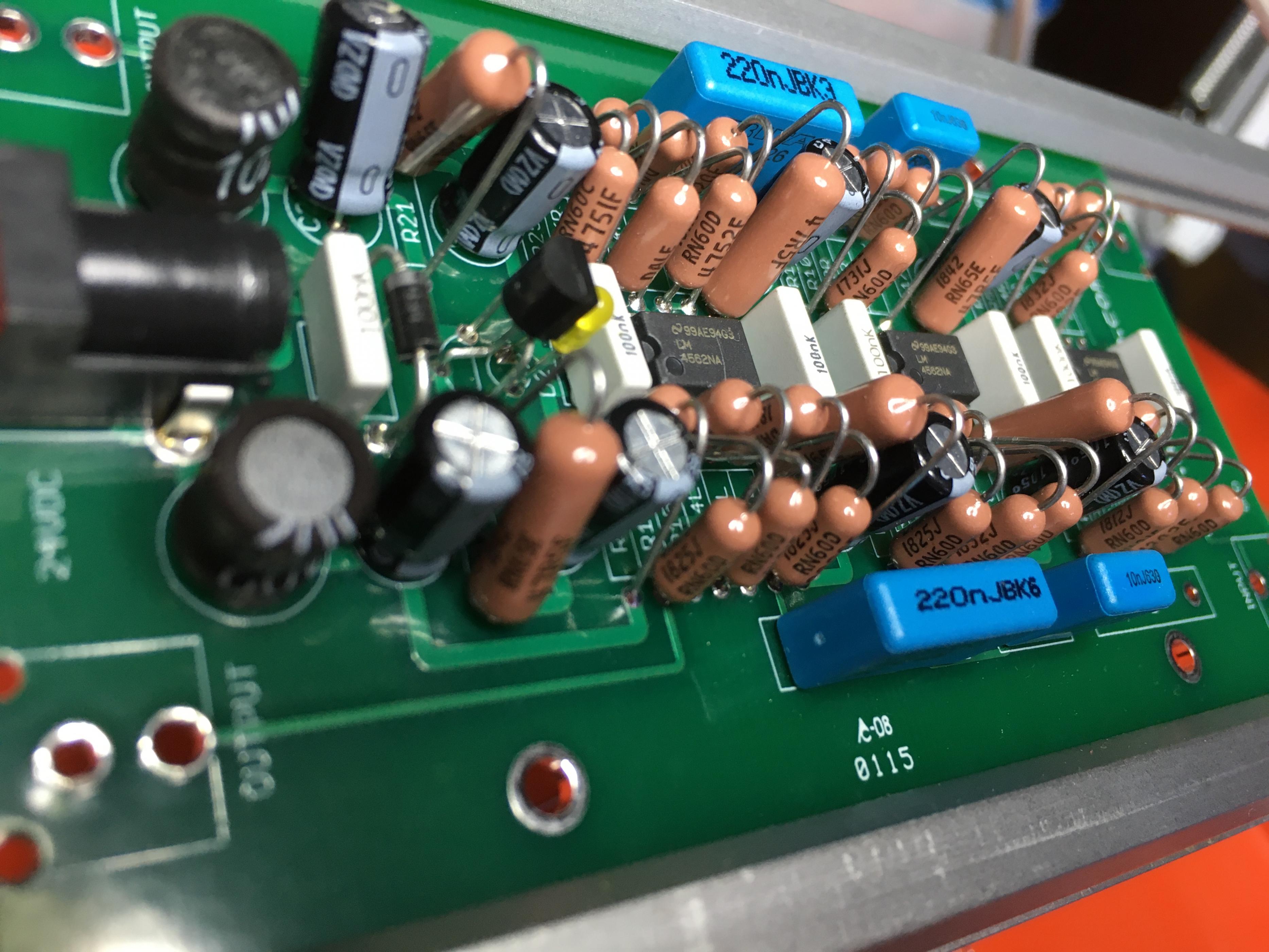

So I started my bugle 2. Can't wait to finish it.
Just wanted to chat: I tried to be smart and ordered Vishay RN60 for them (taking care that the values were conform to the BOM)—but, boy are them big! some even bigger than others, don't ask me why...
Had to line them up soldier-style, that looks hefty 🙂
Hi friends
I'm going to build another one. First one was on perfboard using affordable parts (Xicon resistors), this one will be on the official print with Vishay resistors. RND/CMF55, should fit better than the 60. Great little amp, this one.
I don‘t know why I didn’t went with CMF55. Maybe I thought they‘re 1/4W or so.
Just saw that they‘re tagged
« End of Life: Scheduled for obsolescence and will be discontinued by the manufacturer. »
Which is a pity.
