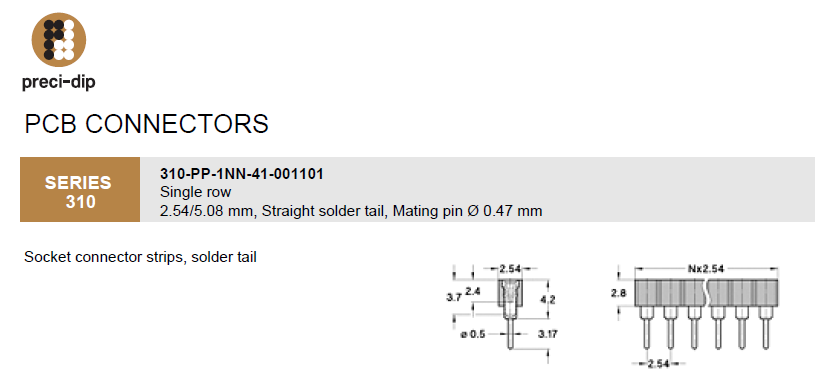

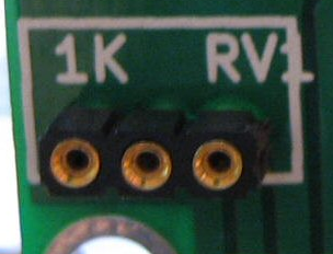

You can buy those pins separately, DigiKey calls them "Solder Tail Female Sockets" and offers them as part number 1212-1114-ND (a strip of 64 socketed pins). Lots of hobbyists call them "Breakaway SIP sockets @ 0.1 inch pitch". A drawing from Preci-Dip's catalog is below. I sometimes use these in my own PCBoards, here's a photo of a "socket" for a trimmer potentiometer that I made by breaking off 3 pins' worth. Naturally you can break off as many or as few contiguous pins as you like.As I am wanting to use this preamp with both MM and MC cartridges, it makes sense to have the resistors that set the gain changeable somehow. Instead of wiring up a switch, which would look kludgey no matter how it's done, I opted to use these pins. Stolen from a really nice DIP socket, they are soldered in, and now the leads from the resistors can be inserted and removed from those pins. A simple solution, and quite handy when I feel like using a low-output moving coil.
