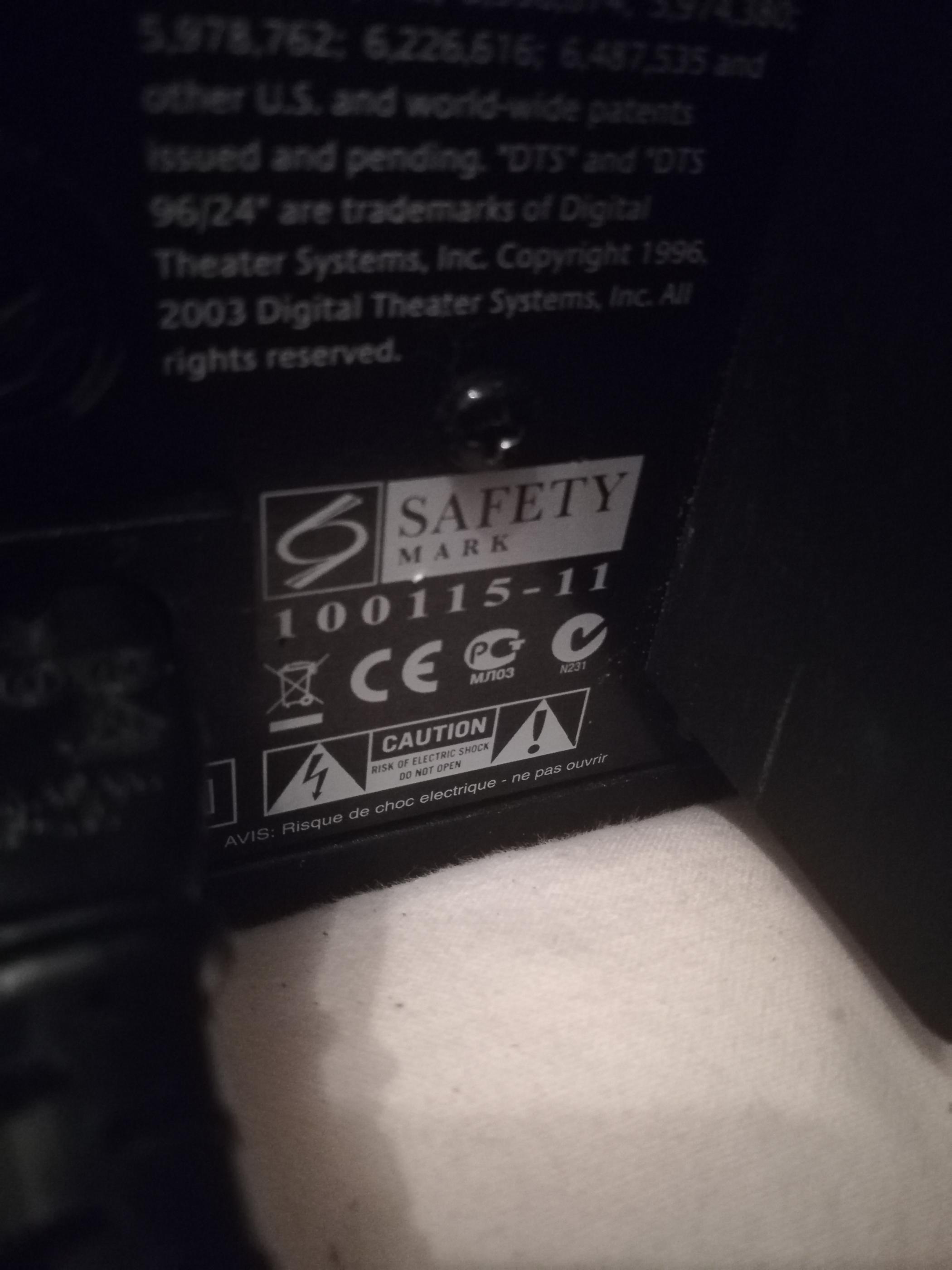

Hey so i have found my pid number it is r044. Is this pre 636 model? I am not sure because of the "R" letter in the front.

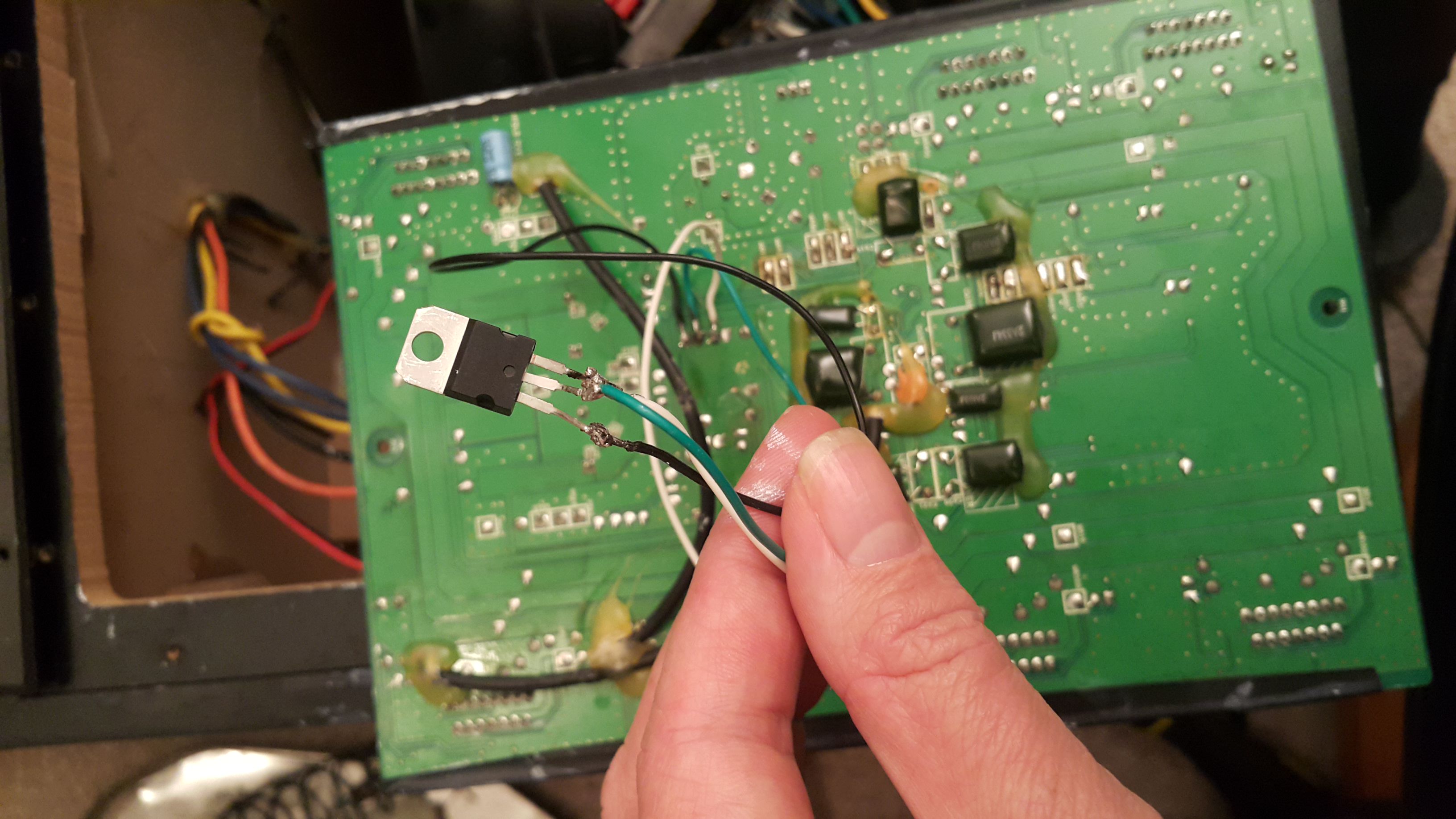

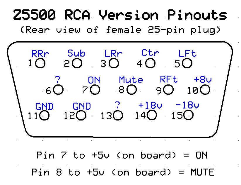

I bought a faulty Z-5500 with the intention of using it with my AV receiver. It's a spring clip version, PID R918.
Currently the Control Pod powers on, but the display shows all black squares and there's no sound.
I bought a Z-5500 15 pin -> RCA adaptor from ebay (£15), but this hasn't worked. The adaptor grounds pins 6&7 to 13. Pin 8 is connected to pin 10 (8V) with a 10k ohm resistor. The RCA output is from pin 2 and 13 (ground). So that all seems fine, but no luck.
I started testing the subwoofer board, and found the 15 pin connector has +8V (pin 10) and -18V (pin 15). But pin 14 has -0.6V whereas it should be +18V.
On closer inspection of the board, I noticed some blackening around a 78M18A voltage regulator. The output is -0.6V, so this seems to be my problem. The other voltage regulator (79M18A) outputs -18V.
My question is this: Do in need to find the exact model number voltage regulator? Or would any 18V/1A regulator be fine? What should I be looking for?

I was able to fix the issue with a new voltage regulator.
I couldn't find the exact model, so I bought a similar regulator with compatible specs.
Voltage regulators have a polarity (positive/negative) and input/output voltages.
I used a "L7818" positive 18V output regulator (ebay, £1). Input voltage is listed as 20 to 35V.
My soldering skills are pretty poor, so I ended up prising the old regulator off with pliers. Then I wired the new regulator on the opposite side of the board, and hot glued the cable safely away
I put it all back together with the 15-pin to RCA adaptor, and it now works with my AVR! Very pleased with myself.

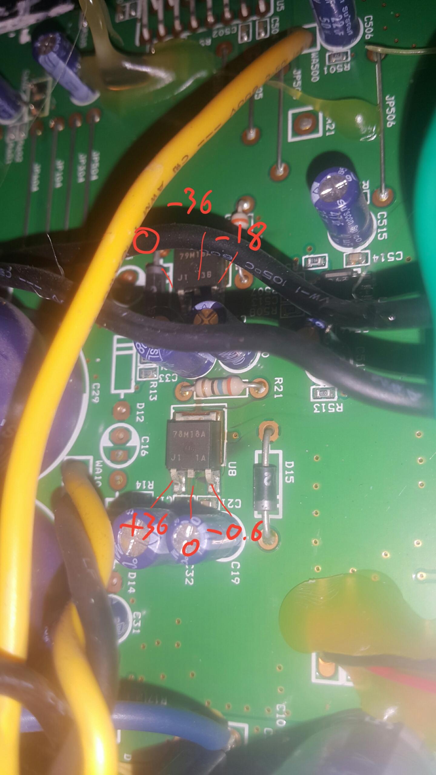

Unsolder the output pin of the 78M18A that is at -0.6V and lift it off the CB. Now measure the voltage at the lifted pin . If -18 then your problem is further down the circuit. If still 0.6 than replace the regulator with one of the same or larger current rating.
Thanks Stanley! Replacing the regulator worked, and I can now use the subwoofer with my AV receiver which was my original intention when I bought the system.
