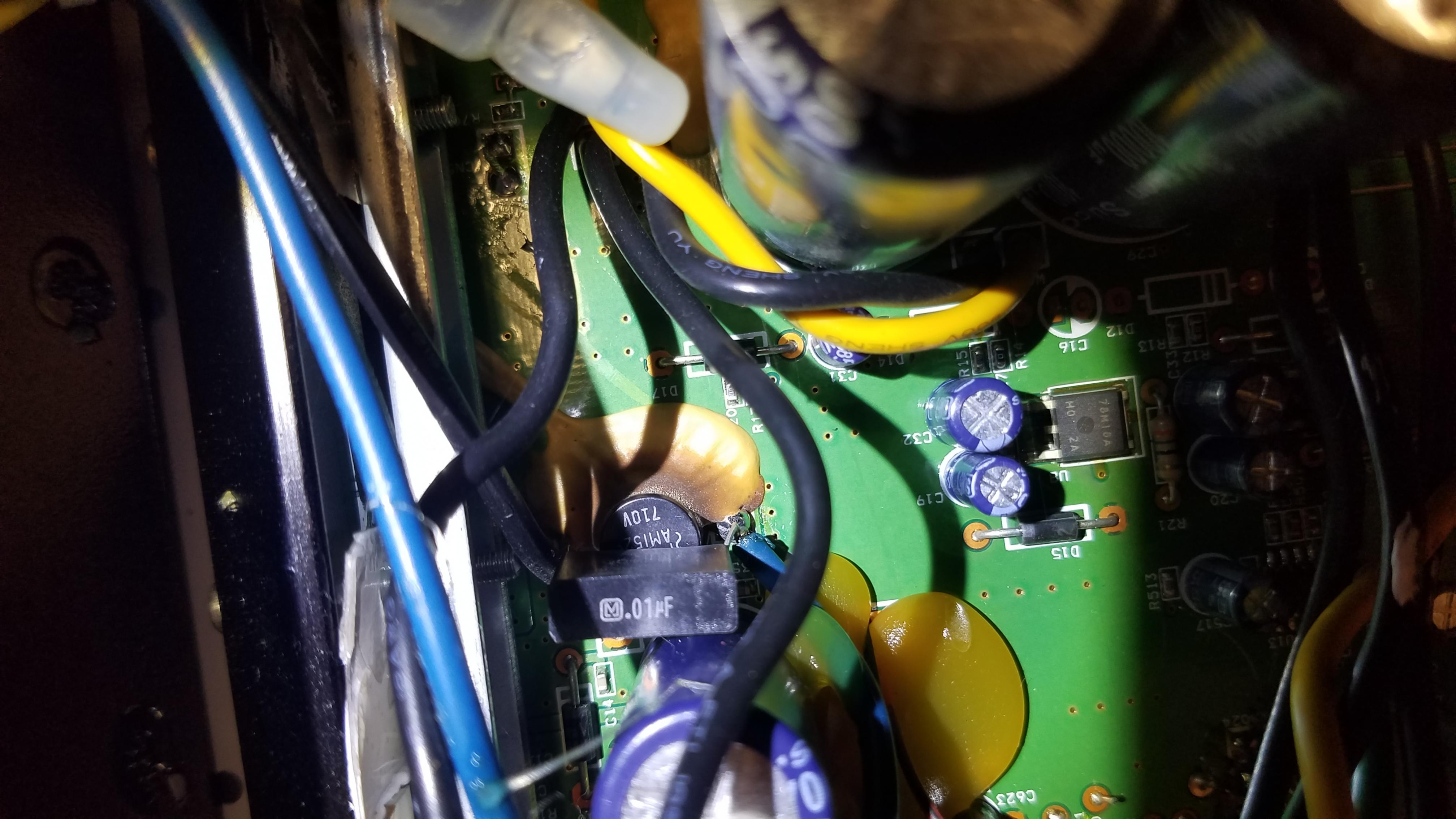

Thats the main problem why all Control Pod of a Z 5500 died's.
I repair number of these speakers and all have same fault.The under sized diode bridge plus voltage regulator after him.Replace this Bridge with higher current one and u ready to go long years ahead.

Yeah the black round part from second picture is bridge and that bridge give almost all voltages to the control pod and that bridge also give voltages to power on the amplifiers in whole system.
Wow. Mine thankfully doesn't look THAT bad. LOL
What should I order to replace it?
Do I need to replace the square capacitor (vreg?) that sits over it as well?
How about the blue can-type cap sitting next to it?
Item numbers or at least specs for parts that you know to be good replacements would be greatly appreciated, since you say you've fixed several of these.

I put these because i have them in my stash.
https://www.vishay.com/docs/88528/2w005g.pdf
U can replace them with any of the same footprint but use 2 amp or higher.

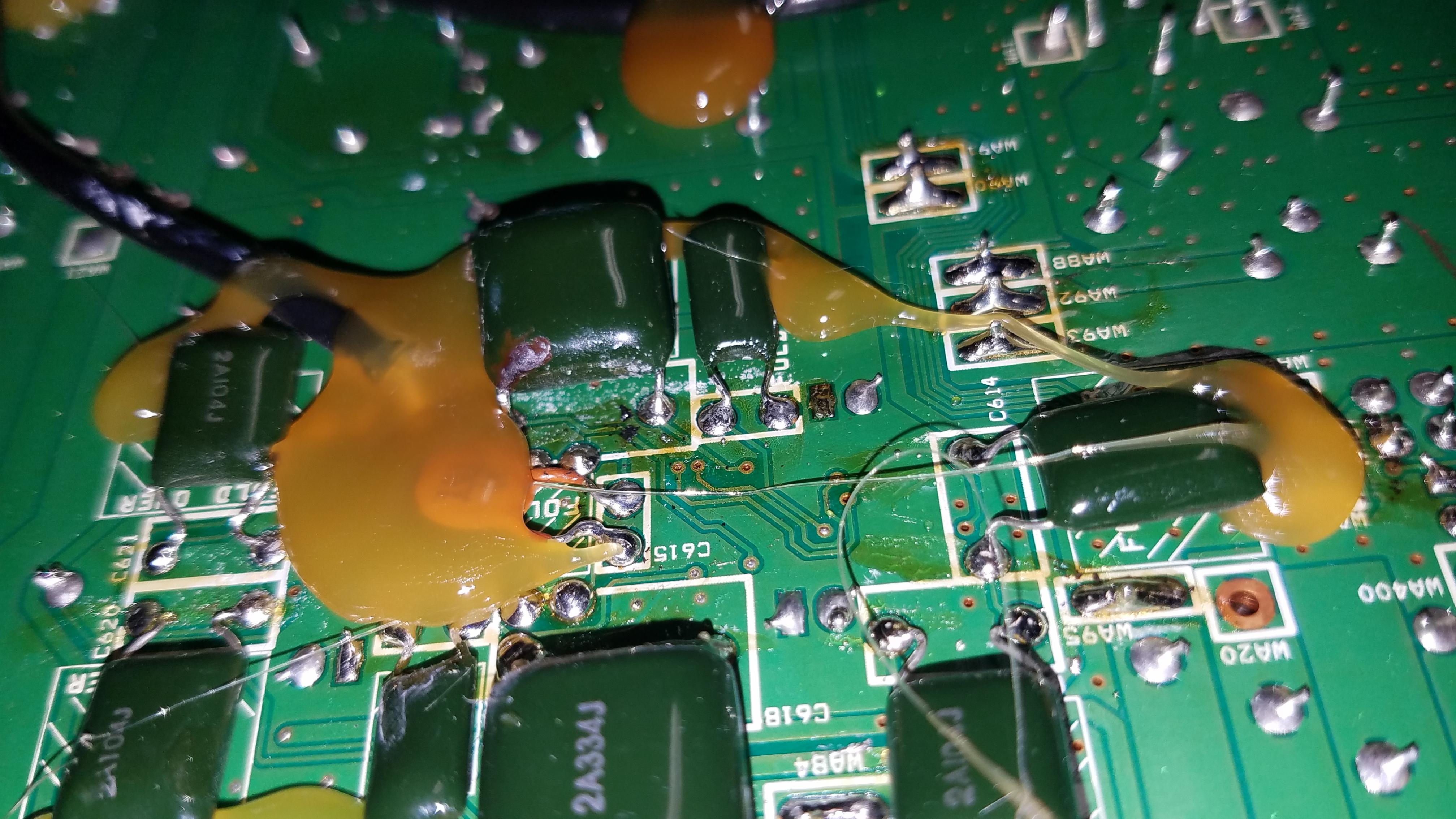

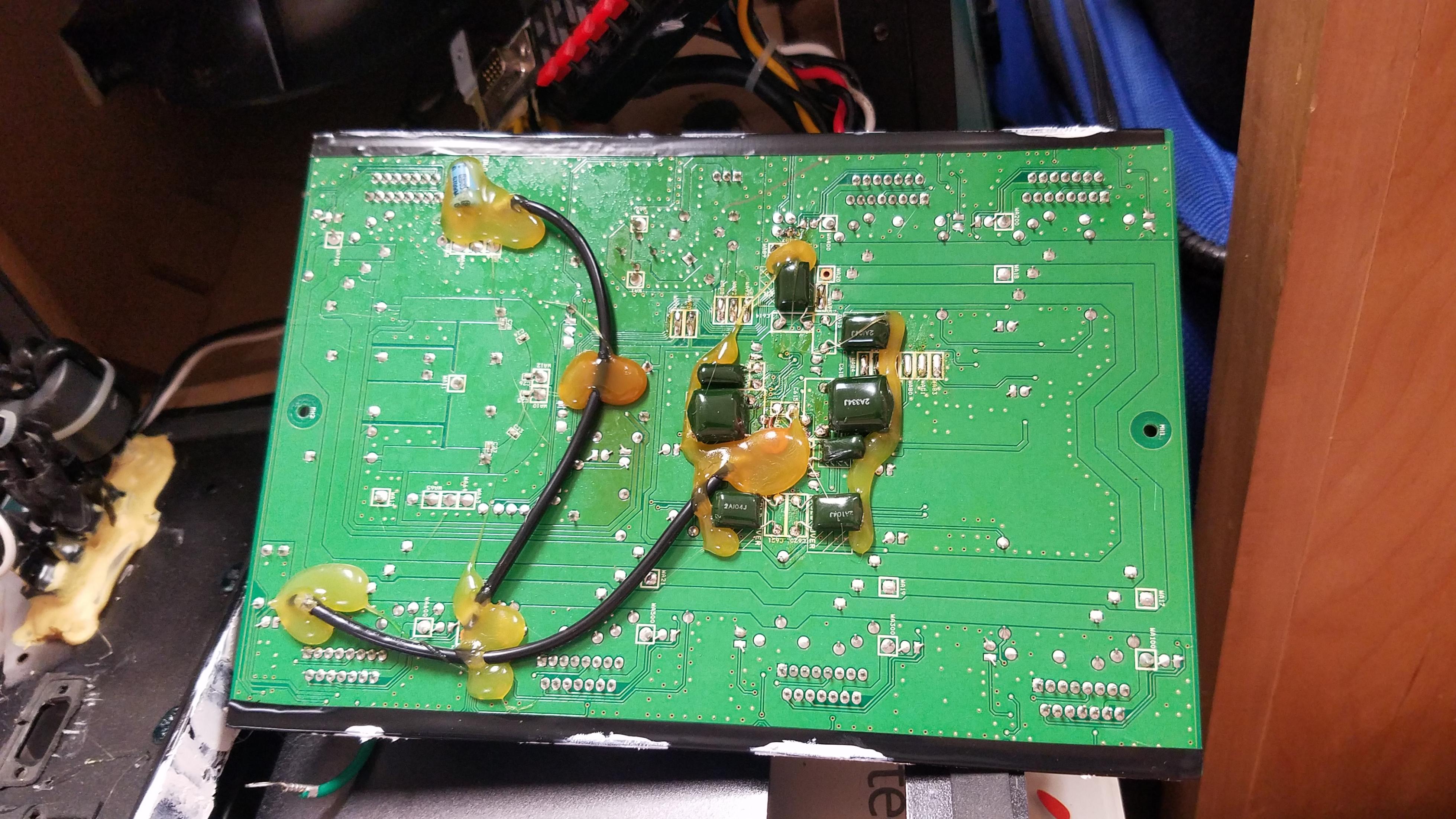

Ok, so after much head scratching, I finally got the board out so I can access the rear. Once my new rectifier gets here, this should be a fairly easy fix....maybe.
Now that I can inspect the back of the PCB, I see something that worries me.
What do you guys think? Is that a blown cap in the center of the 2nd image, or just discoloration of some sort?
