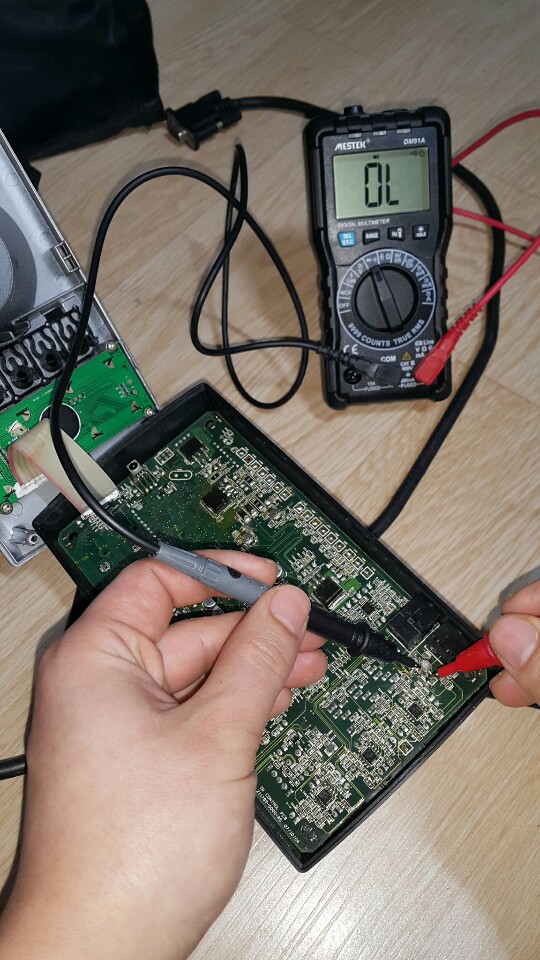

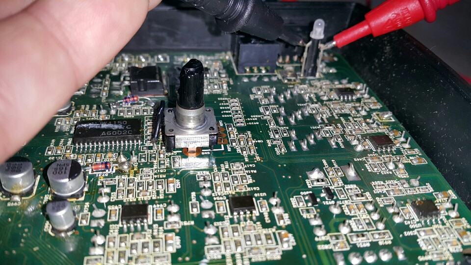

How to check the Red led light on control pod?
My z-5500 doesn't make the red led light on when i switch on powerbutton from subwoofer.
I checked pin 15 and pin 13 and got -18 volt on my VOM
and I checked pin 10 and pin 13 and got 15 volt instead of 8 volt.
so I think that the amp and speaker working fine but control pod is culprit.. easpecially I suspect the red led light diode..
But how can i check the red led light?
I uploaded the photo. my method is right?
