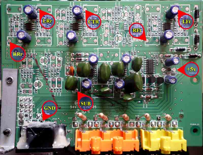

OK! I've got it working on the RCA version of the Z5500!

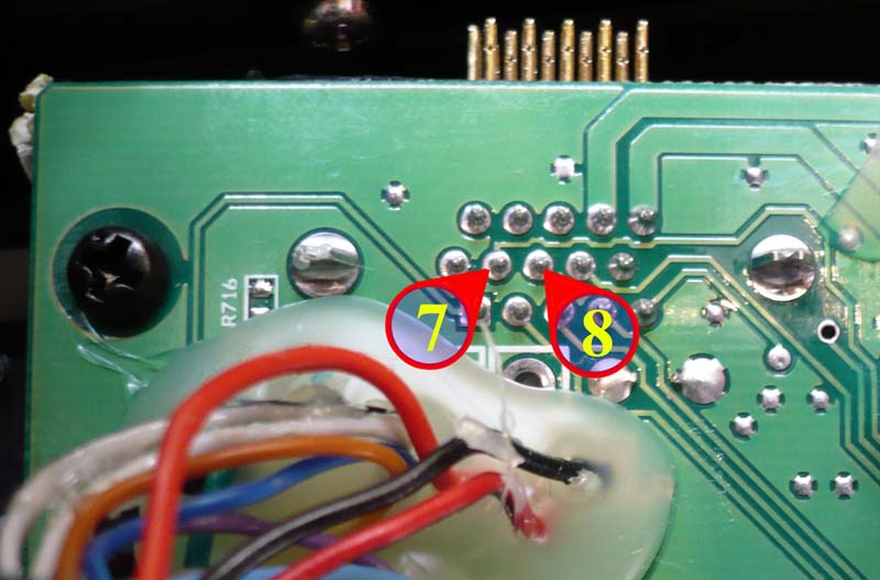

The trick is pin 7 and pin 8, both directly connected to the HCL139 chip. Looking at the truth table for these inputs on the 139 spec sheet, it seemed logical that these two pins should be responsible for the 3 states reported by Bob. BTW, +Vcc to this chip on the board is about 5 volts (a zener?). I also used the ground on pins 11 and 12 (13 isn't a ground on my version of the Z5500)
I tapped a point on the board with that +5 to enable pins 7 and 8: Pin 7 turns the amp on and off and pin 8 enables the mute function, which has a nice fade in/out effect. If pin 7 is enabled without pin 8, there's an awful turn on thump, so it's a good idea to enable 8 before 7, and then disable 8. I suspect it'll be better to use an SPDT, with the alternate logic state grounded.
I connected my generator to pin 2 (using 11/12 as ground) and I have TONS of gain on this channel! Pin 2 leads directly to a cap and LPF as Bob pointed out. I'm sure the other channels work, but I don't need them. I'll probably ground their inputs (should I use resistors or just ground?).
Thanks to all who contributed! If anyone has any questions, I'll be more than happy to discuss.

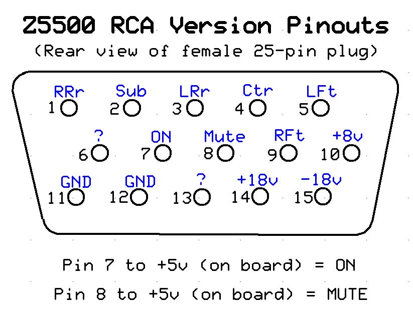

One more thing: here's a diagram of the pinouts for the record. The view is looking from the rear of the female DB15 plugged into the sub.
Thanks to Bob25 and lakata for the pinouts. Note that I haven't personally checked any inputs other than the sub.

Hi Tim,
Earlier in this thread there's two links to 2 YouTube videos that show 2 different Z5500 models: one has spring-loaded speaker wire connectors on the back, while the other has RCA jacks to connect the speakers to. If you look carefully at the videos, you'll also notice that the input board on both models is different as well. Mine is the "RCA jack" version. I don't know which is more recent, or if it's a "region" issue. So I made sure I pointed out that mine is the RCA version, as I can't be sure anything I found out about mine applies to the other, though I suspect they're very similar.
As for the +5v, if I ground 7 and 8 it doesn't turn the amp on, but +5 does. BTW I'll have to revise my previous post if I can: it turns out that once either 7 OR 8 is connected to +5, then the other switch will do the fade in/out when connected to +5. AND if I do connect these switches to ground in their alternate state, either switch will turn on the amp and there's no fade in/out mute at all. However, I do get the feeling that pin 8 is "thumpless", so I'm going to simply connect pin 7 to +5 and pin 8 to a SPST switch to +5 for the mute.
The only regulated power on this board is +8 and +/- 18, but there's a +5 for the control logic. I've put together a picture showing +5, ground, and the input pins going straight to the DB15, as mapped by Bob25 and lakata (BTW: "LFt is on the PCB, not the top of the cap...). The "easiest" place to tap pins 7 and 8 seem to be at the DB15 solder points on the underside. BTW the sub input capacitor is only a 0.1 uF so it has to be a high impedance input.
