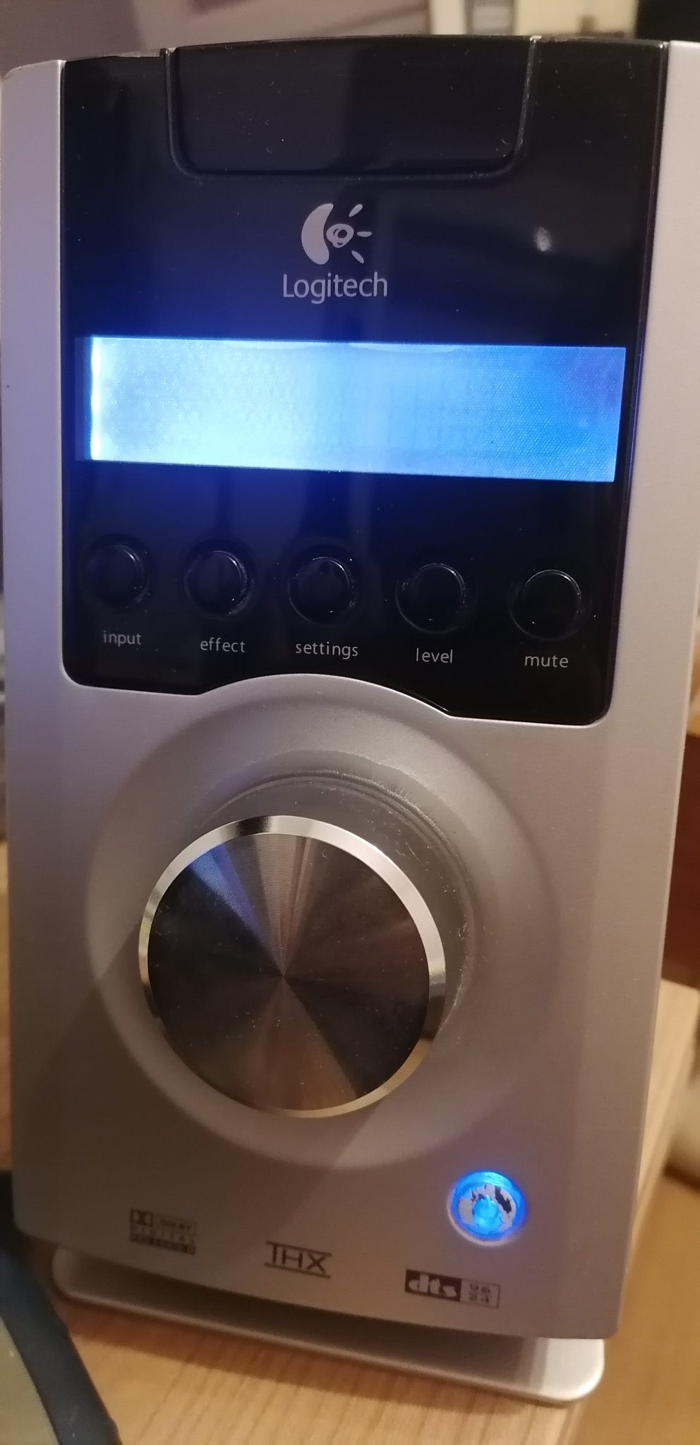

Hello everyone. I have a z5500 about ten + years and i like it.
First, the backlight of my Z5500's control pod LCD screen is broke. A classic and chronic problem. I solved this by changing the SMD LEDs. After this repair, the screen worked smoothly for a long time. But a few months ago the screen went completely gone. The backlight LEDs of the LCD screen are still on, there is no malfunction in the functions of the set in terms of sound, but the LCD screen is completely gone. That's why I recently ordered a new screen from China, thinking that the screen was broken. The new product arrived today, I installed it, but the situation is the same. I wonder which areas and parts of the pod's PCB and alos maybe sub should I focus on for repair? Which IC controls the display, I think it's Zilog Z80 but I'm not sure. I would like your experiences and suggestions. Thanks...

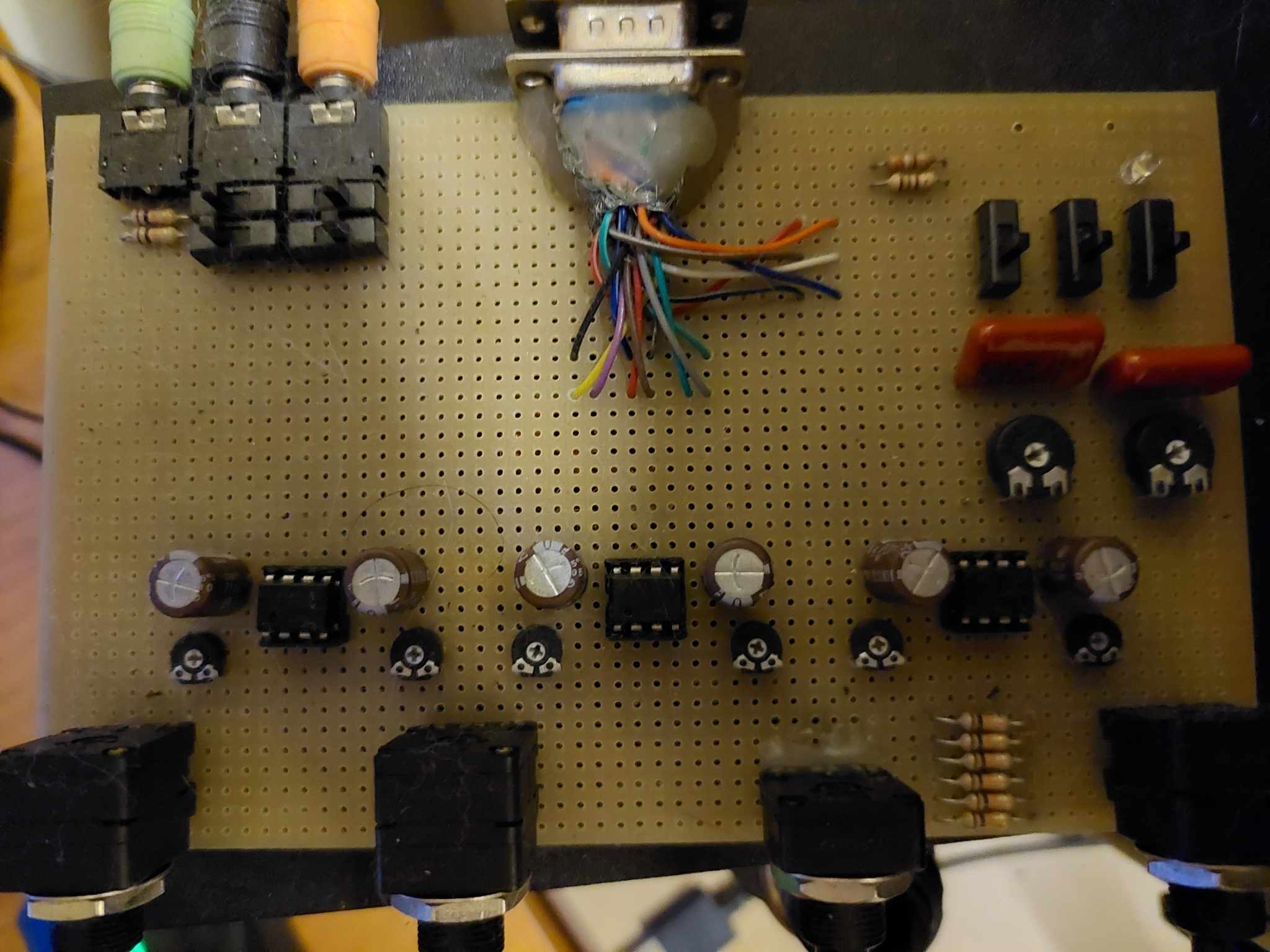

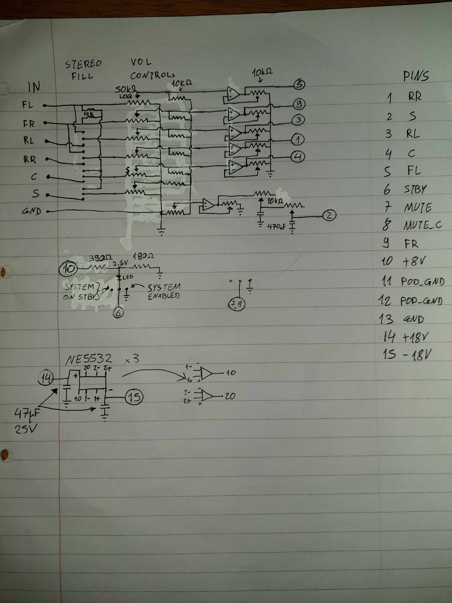

Hi y'all, hopefully you're all doing well. Had some questions regarding the bypass for the z5500. I was able to get in touch with another z5500 owner who had modded his main amplifier in the z5500 with better components and also built his own pre-amp board which replaced his main control pod. Below I'll post a schematic of his pre-amp. Let me know what y'all think. AND his custom built pre-amp also allows him to play his satellites are pretty much full range.

Hey @K4n0 sorry for a newbie question. That pre-amp board is the what you use instead the control pod (the board that is inside control pod unit), correct?
If the answer is 'yes', can you tell me if the schematics that you provided allowes me to use my optical toslink connection or I'll be forced to only use RCA connection?
Also, could you share some photos of how your 'new' control pod (with new pre-amp board inside) looks like now?
Thanks!
@twist3r sorry for the late reply.
No, this thread mainly discusses bypassing the control pod. In the thread you'll see multiple people building a bypass pod to get z5500 working again after the original pod dies. None of these DIY pods will allow you to use toslink/digital connection. This is for analog which can still play 5.1 surround movies but not dts encoded files.
My prevent comment was about another custom control Pod which someone had designed and built which would featured tone controls. But NO Digital Connections im afraid.
