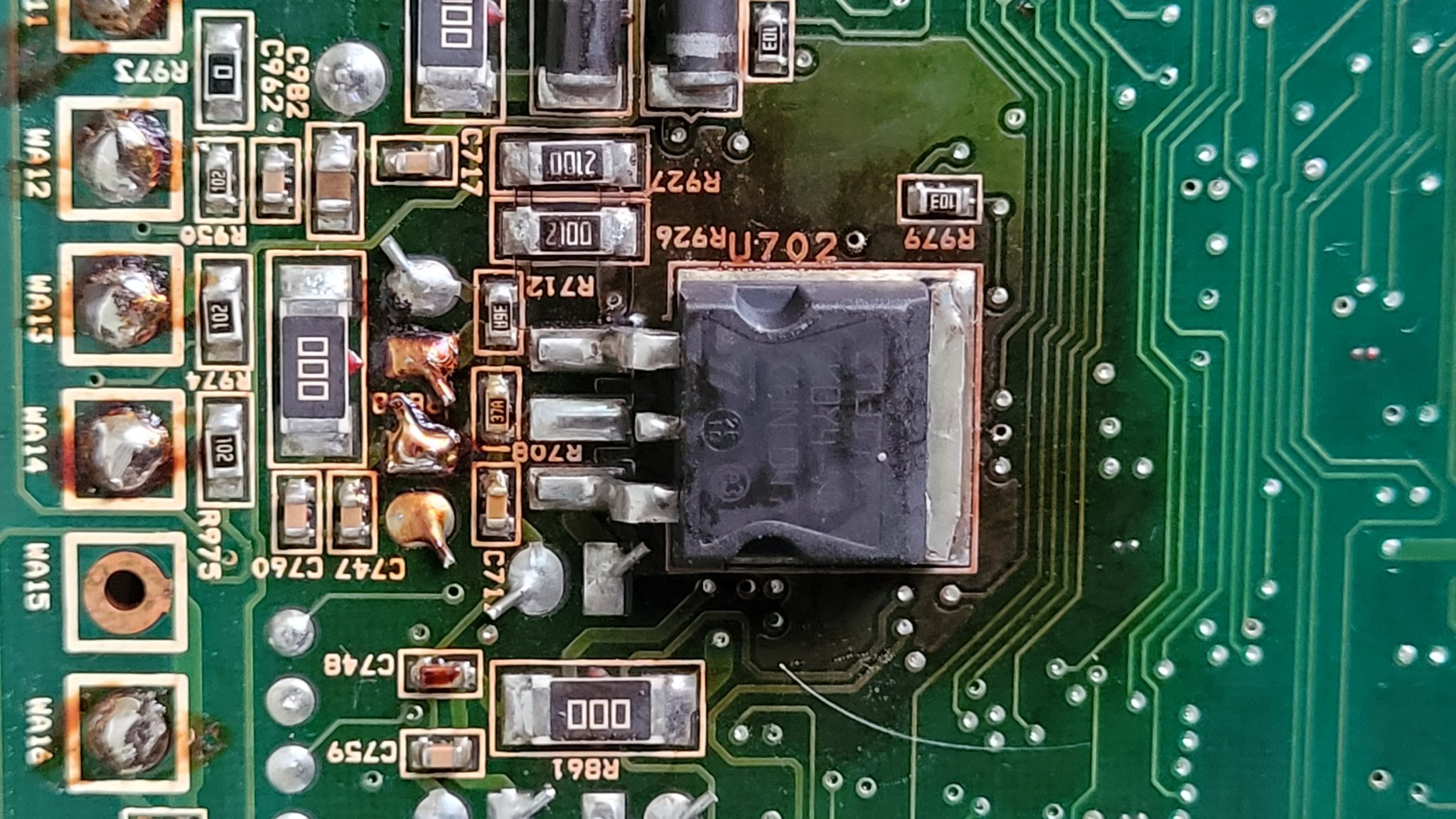

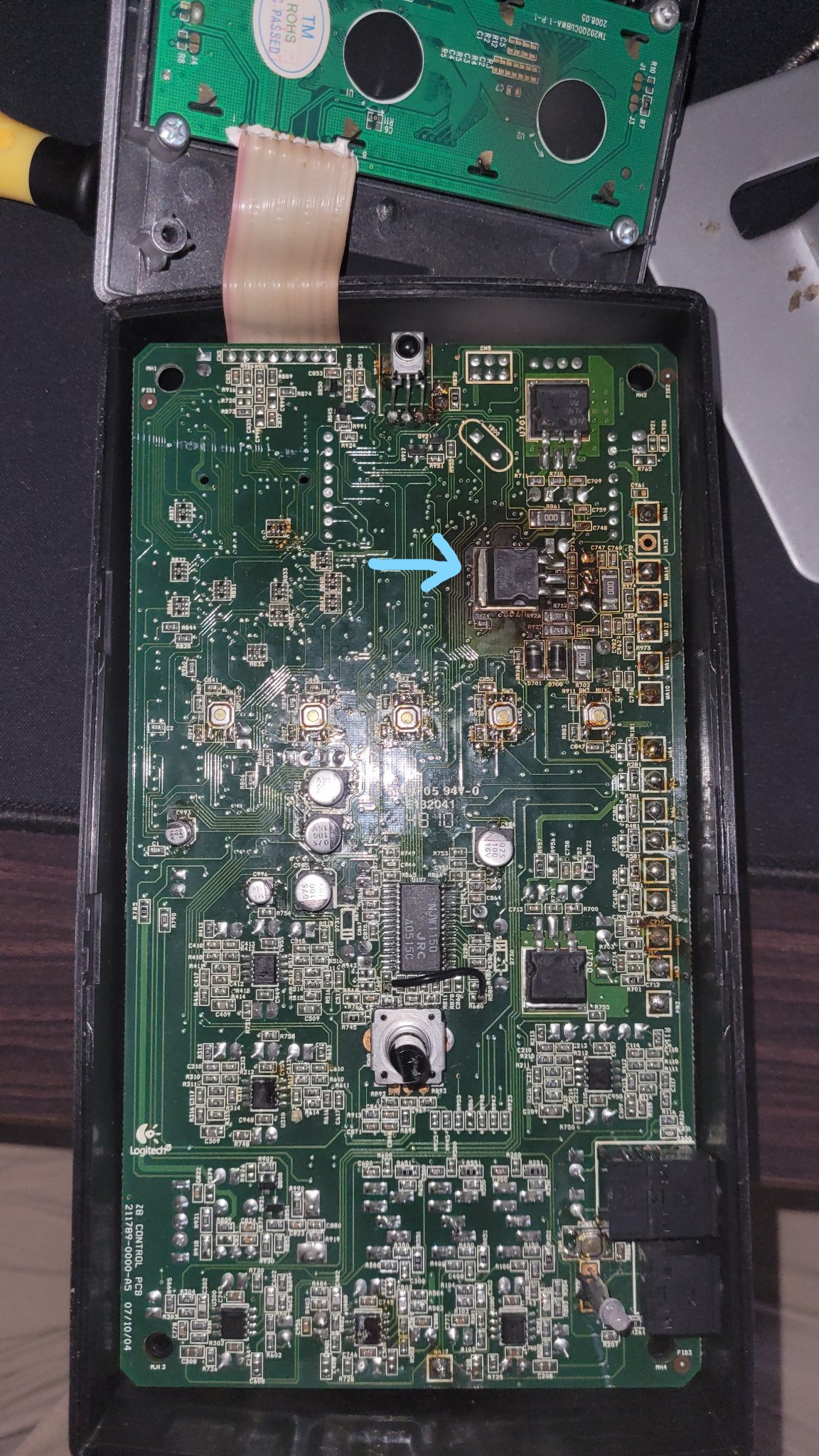

I'm having the issue with the pod displaying black blocks.
I've contacted Logitech (Not hoping for much) but I did read Basi's post on pg59 for checking x3 voltage regulators.

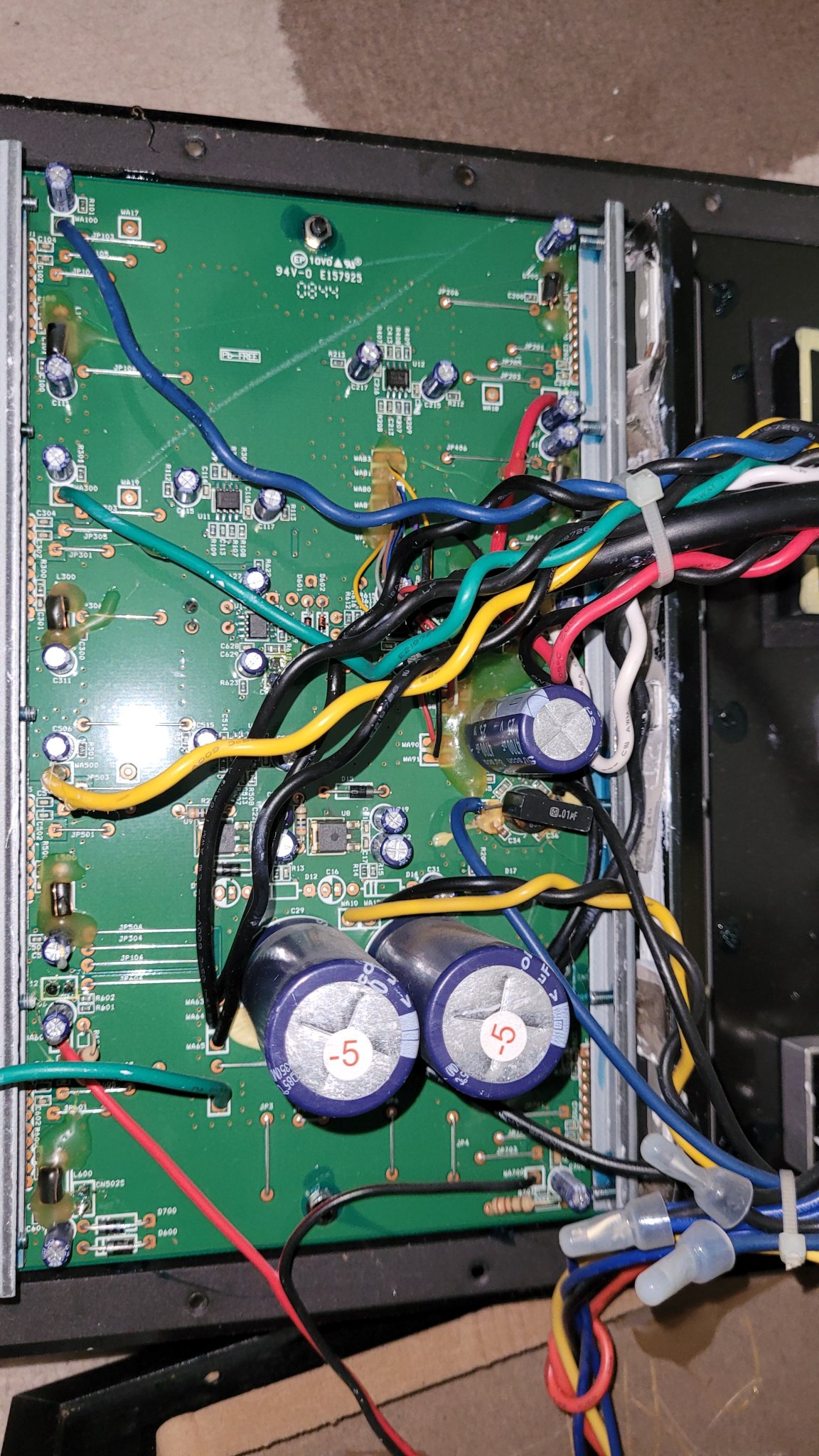

I've opened the amp and have done some readings on the 78m18a and the 79m18a he listed.
The 7818 regulator reads 36.1v at the input, output is -0.6v.
The 7918 regulator reads 36.1v at the input, output is 18.4v.
I've yet to locate the 7805 on my board (the board I have is different from Basi's original photo).
Regardless, I take it that the 7818 should be throwing out 18v or thereabouts on the output pin?

So... I've ordered the 7818 regulator anyways and will perform the transplant. Will let you know when I receive the item and carry out the work.
Fingers crossed it'll work ��

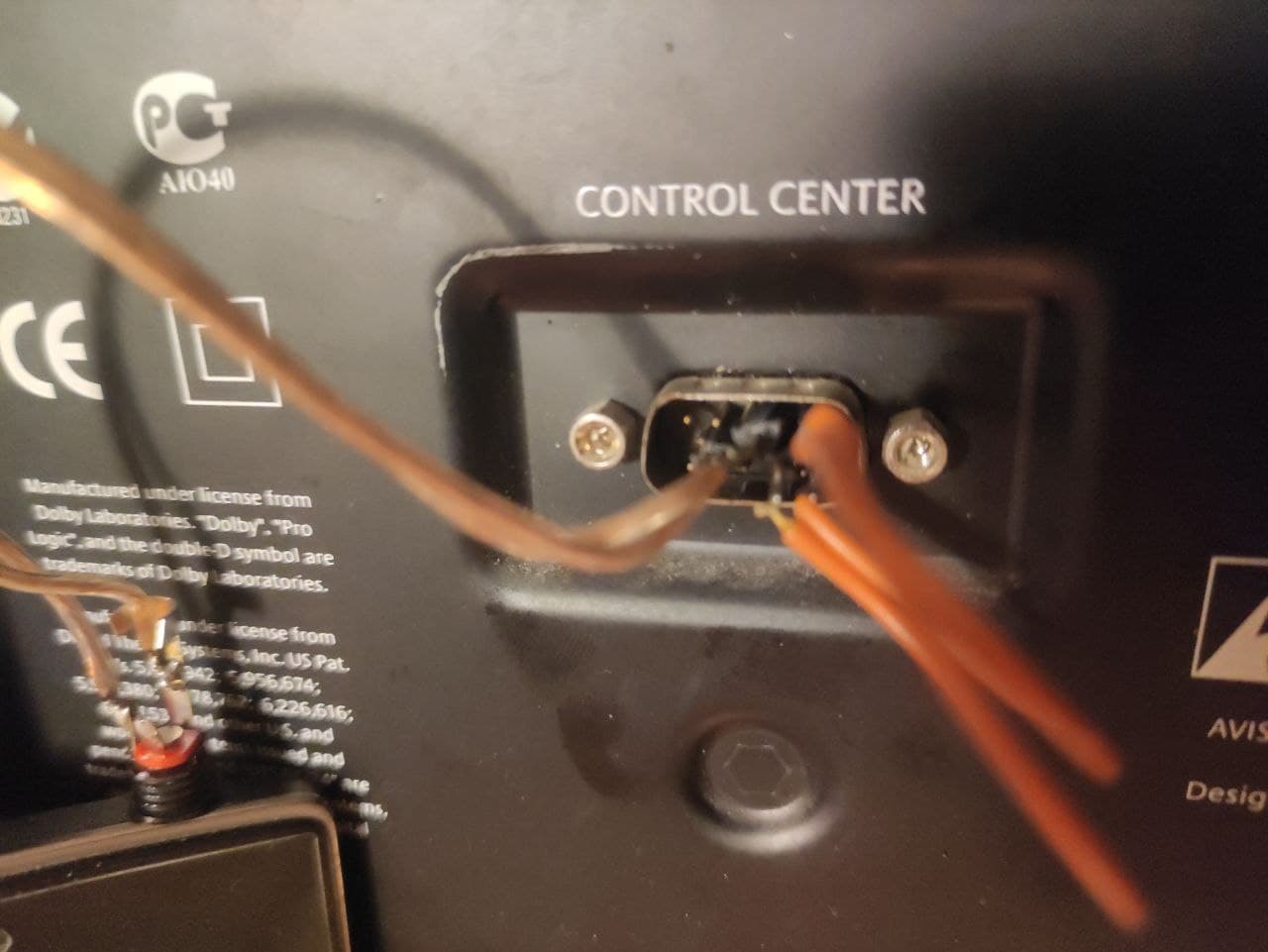

Hey, Got a Z-5400 here tried to wire a 3.5mm plug into the d-sub but the speaker is humming very loud. The music from phone is playing on the speaker, but just very loud humming. at first I thought the input cable was to long and picking up noise. Shorted the cable but nothing improved. When I pull power out the wall while music is playing, the humming goes down and for a second music plays without a humm untill I plug the power back then humming is back..
pin 9. Right front - connected to 3.5mm plug in phone
pin 7. Unmute left right center sub - connected to pin 11 ground
pin 6. Turn amps on - connected to pin11 ground.
pin 11. Ground - connected to 3.5mm plug in phone ground.
Anybody knows if I did something wrong or forgot to wire a pin?
I also tried left front, center and sub they all play music with loud humming. Also tried other phone but same effect.

Hi.Hey, Got a Z-5400 here tried to wire a 3.5mm plug into the d-sub but the speaker is humming very loud. The music from phone is playing on the speaker, but just very loud humming. at first I thought the input cable was to long and picking up noise. Shorted the cable but nothing improved. When I pull power out the wall while music is playing, the humming goes down and for a second music plays without a humm untill I plug the power back then humming is back..

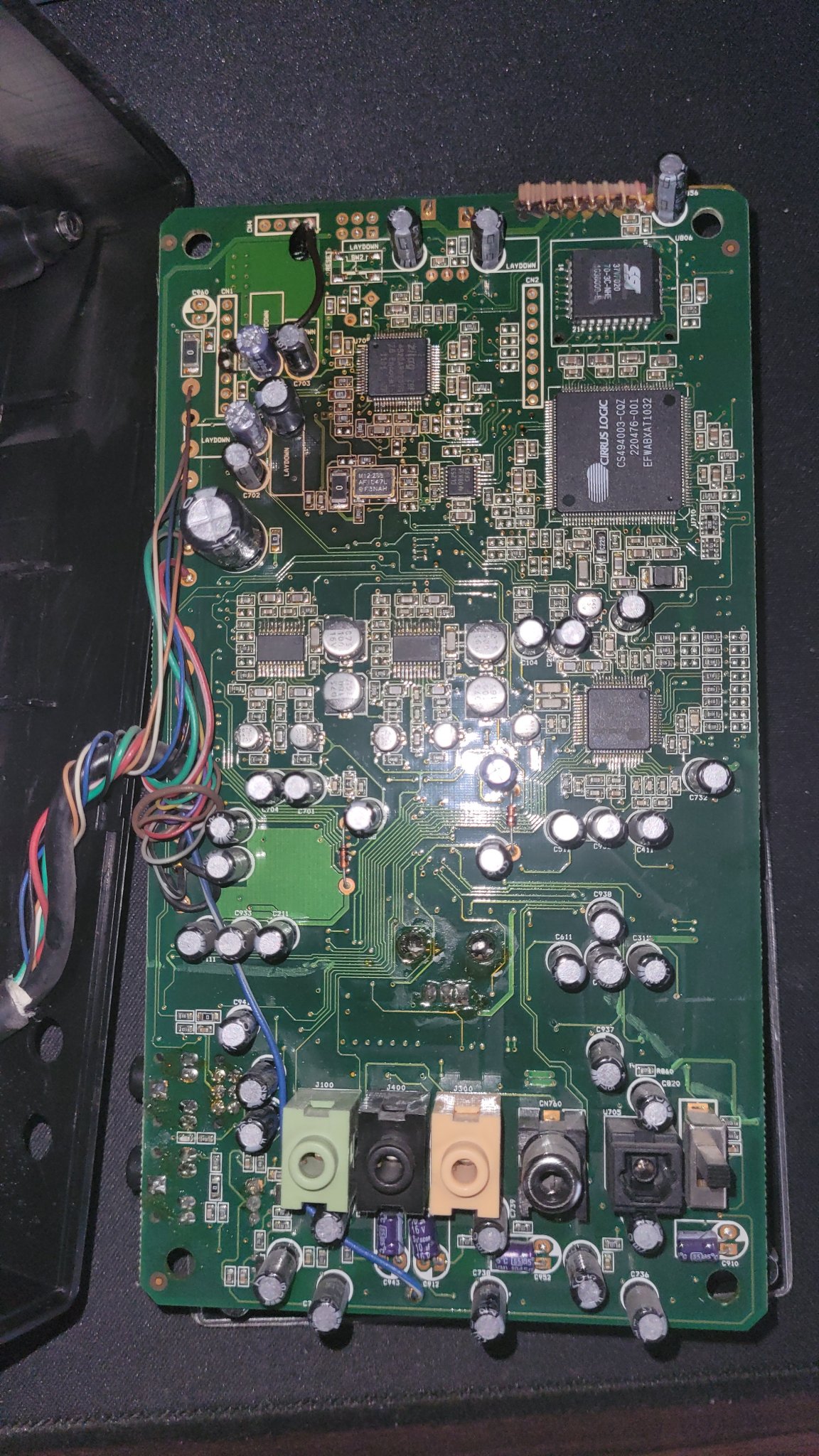

Thanks for reply, I fixed the humming by using original z-5400 cable. But then had a high pitch noise in my speakers which was solved by soldering a potentionmeter in line with front speakers and put pc volume at 100%.Hi.
Maybe you could use an resistor in your 3,5mm headphone plug. Then you need to put the resistor between left signal to ground and right signal to ground.
But i dont remember how many ohms you need to pick.
also an isolated cable would be nice, because of disturbing frequencys.
Hopefully it helped a little.
Kind regards,
Mordi
This fixed noise in front speakers so orderded an 6 channel potentiometer so volume can be controlled on all speakers at the same time.
The resistor probably have the same effect as potentiometer so that will help indeed!

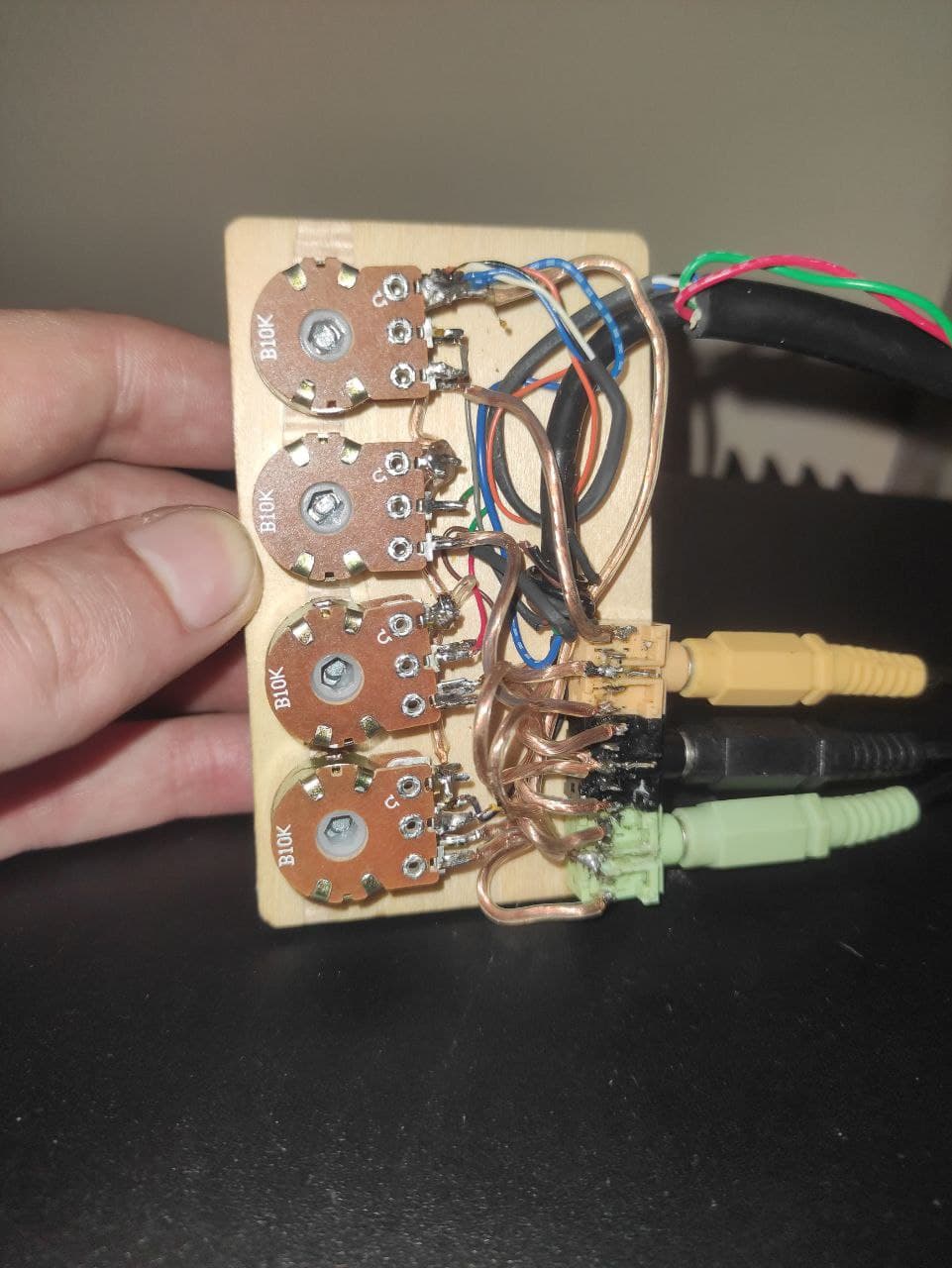

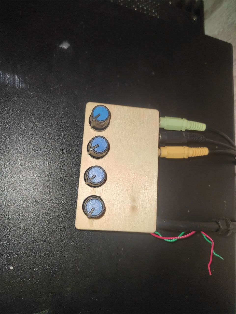

As addition to previous post this is now my replacement for Z-5400 control center.
Got a potentiometer for front, rear, center and sub.
Waiting for an 6 channel potentiometer from Aliexpress, but might not need it since it works perfect right now.
Problems I had with the original control center was that it would hop automatic through all inputs which made it almost impossible to use and the leds behind the display were weak for years at this moment.
Thanks for all information provided in this thread!

I opened the control pod (R108) and noticed a darkened area around a component that gets really hot while in use (too hot to leave finger on it); it is the one labelled U702 on the board, it is an LM317D2 from STMicroelectronics (also showing GKOY4 VW CHN 047 on it), a linear voltage regulator. The surrounding area seems to have taken a brown color from the original green. I don't know if it's supposed to heat that much or not, if it should be replaced or upgraded, nor if I should clean the "brownish glue" visible on some connections here and there (with what?) and whether or not this is the source of the problem. Any ideas/instructions please?
I started to have this problem where the sound suddenly stops playing on all speakers, without any pop, without changes on the display, the switch stays blue ... it just goes silent. Sometimes I just need to switch off and on the pod once to get the sound back, sometimes it takes a few switches, and sometimes I stop trying after 10 times and use my headphones instead, plugged directly to the pc.
I opened the sub (R846 with clips) and didn't see anything out of place, moving part or the common problems seen on this thread (blown capacitor, burnt component...).
At the four through-hole pins to the left there are visibly carbonation, which could cause intermittent issues.
The first step would be to clean that crud off with an solvent like white spirit and then a alcohol. Or just Alcohol might be enough and a rub with a bristle/toothbrush.

Hihi,
(Prerequisites)
I just got a Z-5500 given to me by a lovely guy at a an audio shop that I go to a lot. It is missing the control pod and by the looks of things it's just something that is kind of waiting to fail, and I've looked at a bunch of the serial to 3.5mm cables on eBay, Amazon etc and most of them have some quite bad reviews about the products being duds. And the original pods just seem to be an eventual failing point.
The cables that you find online seem to be quite simple and I don't see why I wouldn't be able to make my own.
(Actual question)
I've done a reasonable amount of research into it and I've seen all the pinouts and things for the serial connector, and since the control pod has to use those pins only to turn the module on and we have pins 10 and 14 that for me both supply +18v, from there I can just add a resistor right and connect it to pin 7 and turn on the speaker. This is if I want an on switch on the cable. I can just cut a hole in the amp and put a switch.
I was wondering if anyone knows where to get +5v on the main board.
P.S I love seeing active communities around products like this

Btw idk if its obvi or not but I have looked and cannot find +5v on the main board.Hihi,
