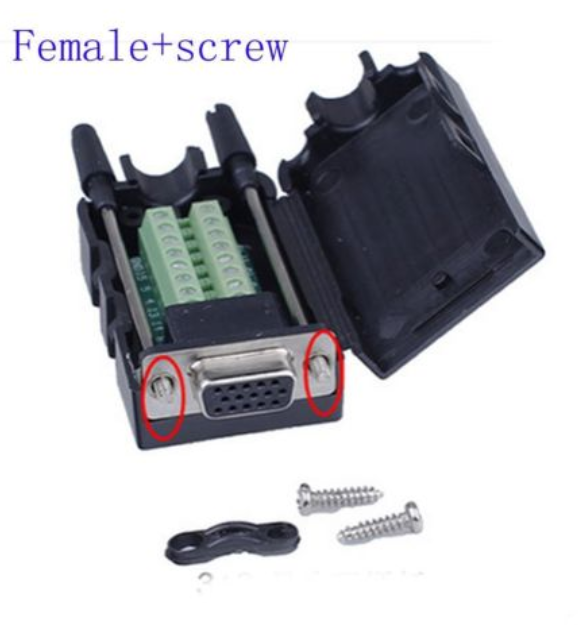

For everyone who are looking something simple and working solution without much soldering here is interesting cheap item that works for dead z5500, it works very well with any version because its the same as simple d-sub, i just putted rca cable on it and works great with onkyo sr-504e that by the way has good crossover frequency adjustment from 40 to 200hz, keep mine for z5500 on 60hz and i lowered subwoofer level on onkyo to -5 so it isnt so loud.
Search ebay for D-SUB DB15 VGA Male Female 3Row 15Pin Plug To Terminal Breakout Board Connectors
