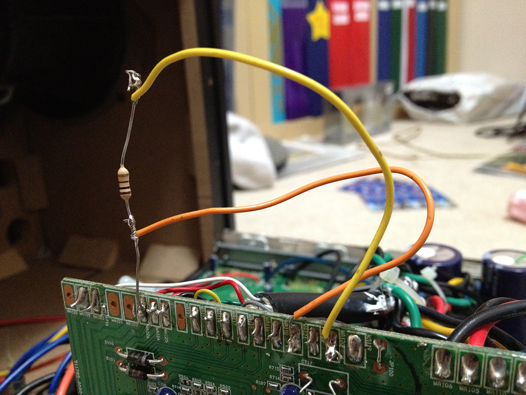

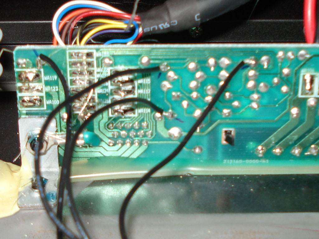

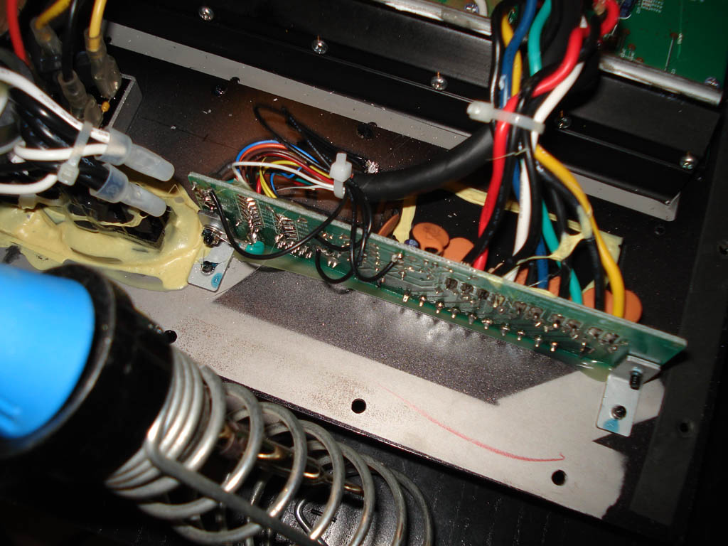

Thank you Toffmonster! Your help has been truly instrumental. I performed essentially the same mod you made (because my unit is exactly the same) but in a different way. I will summarize below so that anyone else can perhaps follow my procedures as I think it's significantly easier to solder.
From what I have gathered, there are three different varieties of Z-5500's. The RCA version, the early spring-clip version, and the late spring-clip version (PID 636 and greater, including the rolled over numbers made in recent years with PID's 001 - 200). If you have the late spring-clip version, buy a bypass cable on eBay and be done with it. If you have an early spring-clip version such as I do (PID R608), then buy a bypass cable on eBay and be prepared to do some soldering.
I found this post and this post very helpful in understanding what it is you have to do. What I did is solder from the +8V feed to the orange wire (pin 8) followed by a 100 ohm resistor connected to the white wire (pin 7). This basically supplies +8V to the orange wire and +5V to the white wire (+2.5V under load).
I'm hoping there isn't any long term negative effects in supplying +8V to the orange wire; if there are, I'm assuming it will only damage the center channel. I suspect though that the control unit supplied +8V to both leads as that is what it was fed. In any case, this makes the soldering much easier and allows you to make only three solder points on the board, which significantly lowers the risk of damaging any components or the board.
I've attached pictures of my board to make sure whoever is trying this has the exact same board. I have also attached a picture of the board after the modification. I wrapped it in electrical tape and tucked it away after I took the picture. Good luck! 🙂

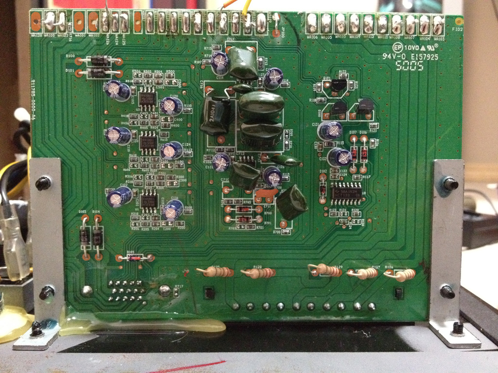

Do you have an idea how to get rid of the high-pass filter in the Z-5500 for example, the two rear channels?
I wanted to hook up the speakers full range, but unfortunately the original connection they do not fulfill their role.
You can bypass the three opamps on the left on the preamp board (as on the upper picture) with five wires (the upper one is the rear chan, the middle is the center chan and the bottom one is the front chan). Idealy you will have to remove the three opamp. But these five high pass filter should not be resposible for the final high cut off frequency. You will have to test it to know (maybe one more filter could be in front of each chan power amp tda7294).

A small addition to my previous posts. Took some pictures of my PCB and checked what pins orange and white cables lead to. It appeared the orange cable that turns my center speaker on is pin 8, while the white cable that turns the amps on is pin 7. So it's just like the thread said in the beginning, Pin 7 is On. But in my case Pin 8 isn't Mute but Center On. 🙂
Looks rough, but it works.

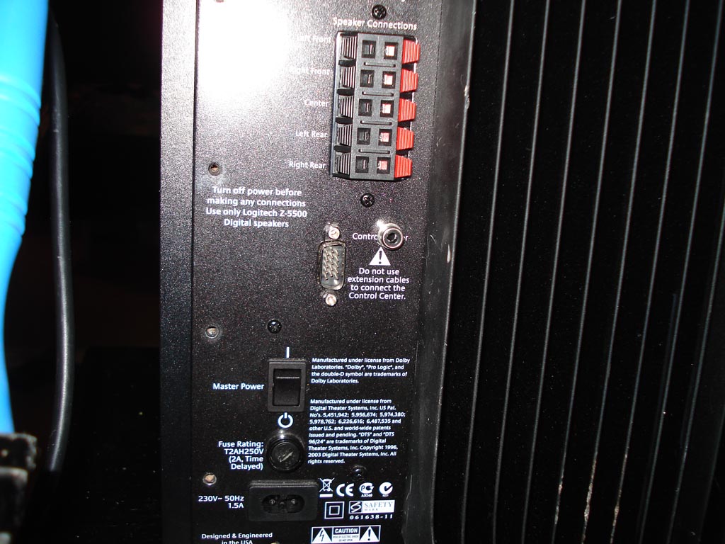

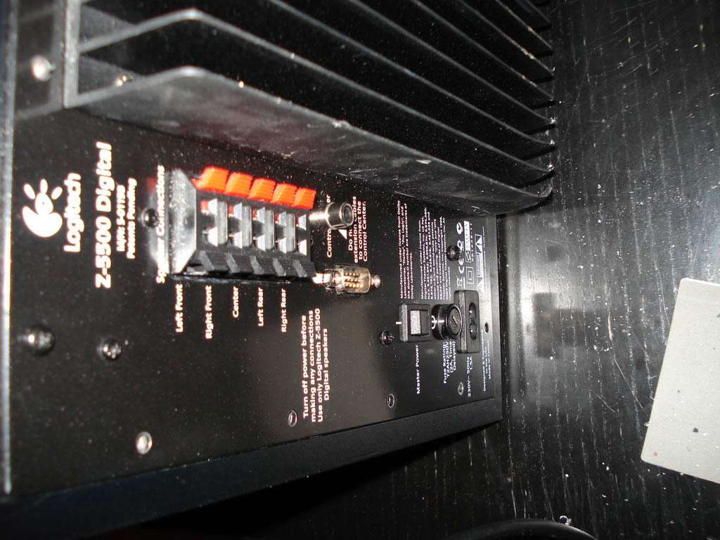

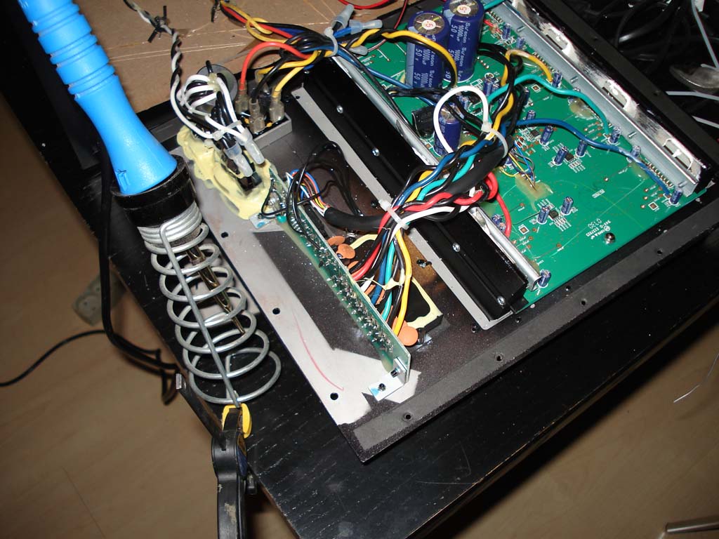

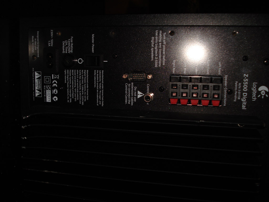

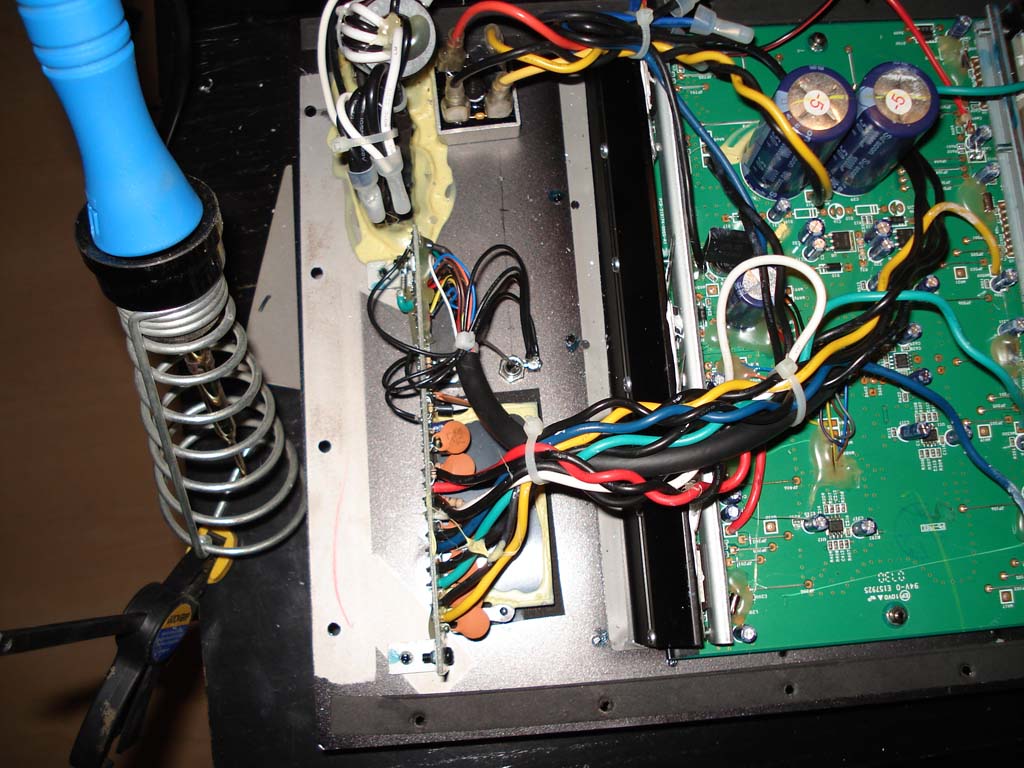

Hello guys. This thread has been truly inspirational! I'm very thankful that it's even possible to find this much information about hacking the Z5500.
I'm in NO WAY an audio geek. I have almost no knowledge what so ever in this field. I'm an electrician and I also like working with computers, inside and out.
At work someone told me they found a speaker in a house that had been auctioned away, and it was to be thrown out. I looked at it, and it was the subwoofer/amplifier from the Z5500 system, and it looked to good to be trashed.
I took it home, and thought it might be usable, but no. There was no control pod.
Then after some googleing i find you guys!
Now. What to do. My plan was making this into an active subwoofer, that would work together with my Sony 5.1 amp. It's got a preamp phono jack out, for subwoofer connection.
One of you had reverse engineered the pinouts, so it made the job quite easy.
I'm an electrician, so I have testing tools. I started measuring from pins on the connector on the back, to the circuit board inside, and found out where pin 6, 7, 8 and 13 ended up. Then I soldered 4 wires on. I mounted an RCA connector in the back of the subwoofer amp plate, and soldered the 4 wires to ground. The I found out that pin 2, Sub In, was the grey wire in the wire bundle, so I cut that and wired it to the center of the mounted RCA connector.
And it worked! My Sony amp can turn up and down the volume on the subwoofer individually.
