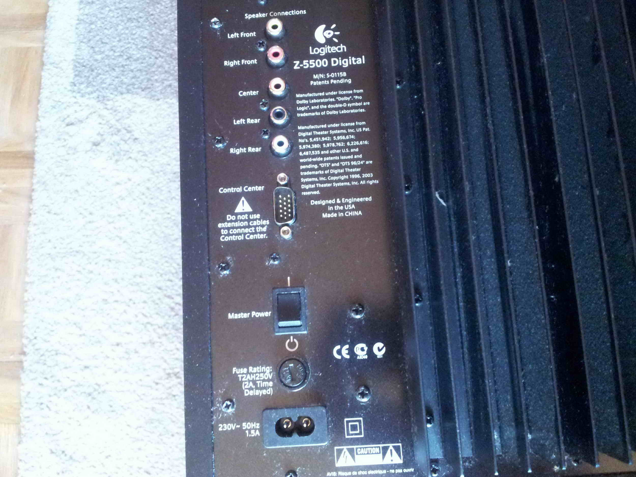

Good Evening,
1.) Mis, can u show me some pictures of your Z5500 RCA? my was an RCA too and now it works!

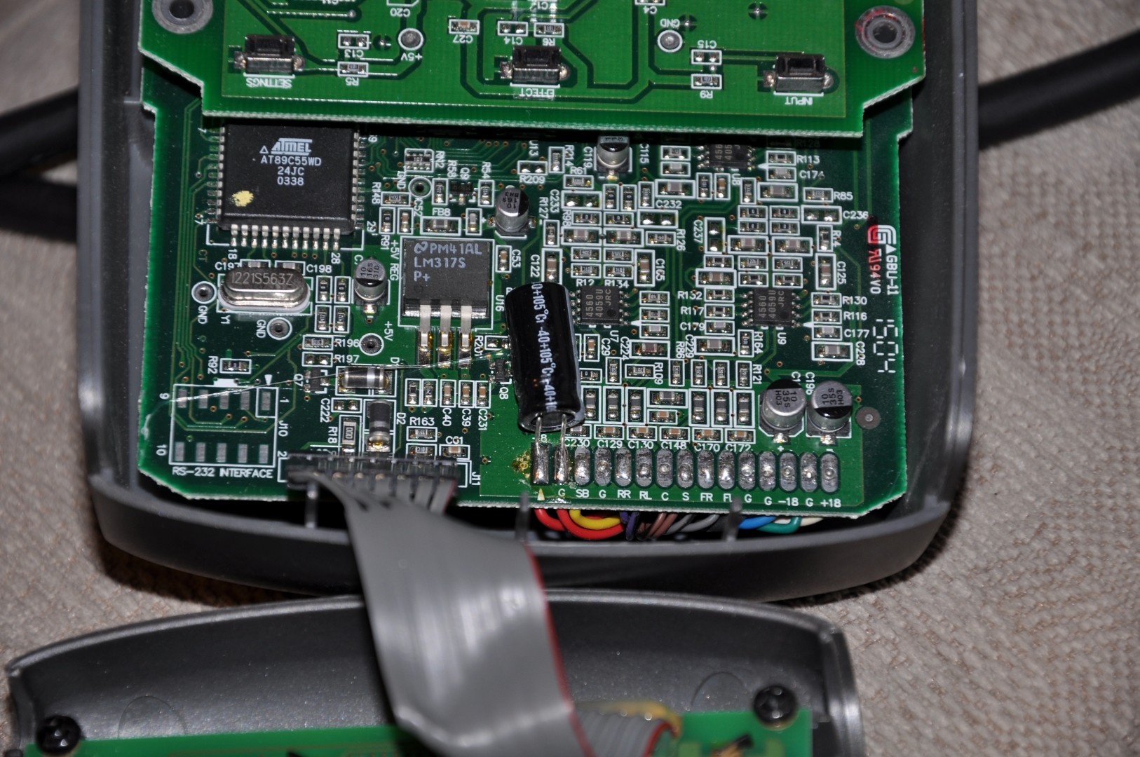

Logitech Z-680
Hello
I didn't find much information on the Z-680 so I did some reverse engineering on my own.
Here's the female DB15 pin-out with the corresponding marking inside the pod:
Code:
1   Center
2   FR
3   FL
4   RR
5   S (Sub)
6   G
7   SB (Stand-By, needs +5 volt to enable)
8   UNUSED
9   RL
10  +8
11  G
12  G
13  UNUSED
14  +18
15  -18
Pic of the markings inside the pod:

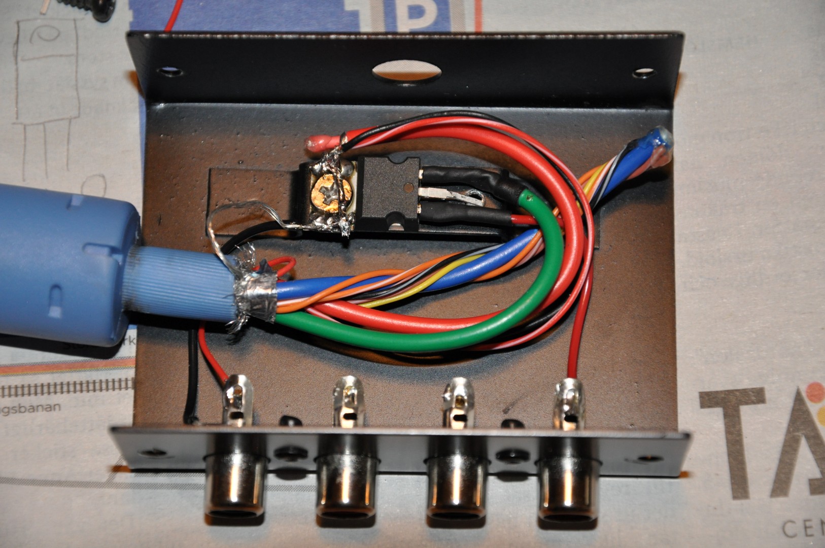

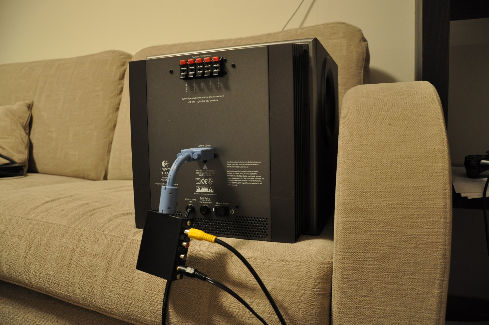

I recently bought a Yamaha receiver and wanted to use it with my Z-680 sub, so I made this from some parts that I had (VGA extender cable, RCA-switch and a LM7805 +5v voltage regulator). The Yamaha has a trigger output that puts out 12v when it turns on, so I use the voltage regulator to take it down to 5v. But if you wanted to, you could use the voltage regulator on the +8 instead and have it always on or use a switch.
Thanks,
And I'm out!
