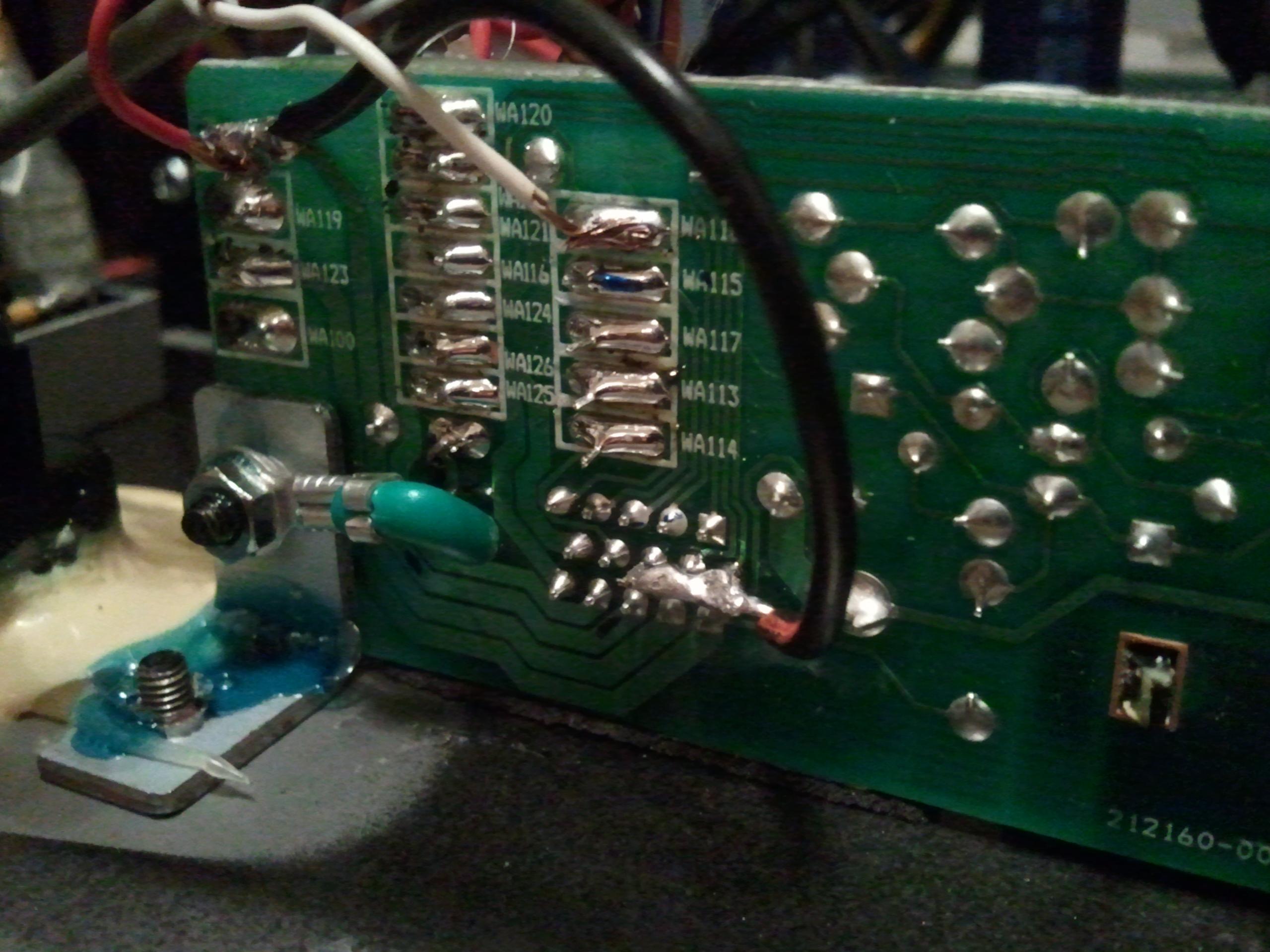

Got it done. Soldered piece of wire across 6,7,8. Soldered end to 13 which is on the other side of board. Got a mono headphone jack and soldered one wire to pin 2 and the other to pin 13. Works fine. Only the sub works. I hooked it to my samsung mesmerize phone which is outputting full range audio. I'm going to change the headphone jack and put in a rca plug so i can hook it up to a kenwood home theater receiver. The receiver should sound way better since i can change the crossover settings and adjust the bass levels.
I wasnt gonna buy the sub, but i seen it had the built in amp and couldnt pass it up. I got it at goodwill for $12.81.
Hi, cool and easy mod for sub. please share your opinion how it sounds with your receiver. Were you able to control the sub volume? also wat are specs of your receiver, im planning to hook my z5500 speakers set to a receiver.
My receiver is a sony str-dh800. Its hdmi and 7.1. I can control subwoofer level through the receiver but it doesn't seem loud enough. If i crank up the volume it sounds good but everything else is also louder. My main fronts are cerwin vega re series 20, center sony ss-550ch, surround sides sony ss-mb150h, surround rears sony ss-x210. I had a yamaha yst-sw150 for the sub but i put the logitech in its place. I finally bypassed the logitech amp altogether and clipped the wire to the sub inside and ran it out the port. I hooked it to a old kenwood plate amp i salvaged from an old sub my uncle gave me. I think its 100 watts or something. It has the crossover and level controls on it. It sounds good now. It does the lows really good. Its in the corner of the living room behind the tv which is a mitsubishi 60-735 dlp. I may try playing around with the logitechs amp some more eventually. With all that said, just doing the mod across those pins and adding a rca cable it sounded pretty good. I had the subwoofer setting on the receiver set to max and it just needed more signal going to it to get the bass i wanted.
By the way the kenwood receiver is in the spare bedroom/video game room. I did hook it up there but it was too big for such a small room. The kenwood doesn't have crossover settings on it. I didn't check the sony. Guess i have to break out the manual now.
