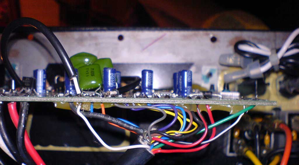

A small addition to my previous posts. Took some pictures of my PCB and checked what pins orange and white cables lead to. It appeared the orange cable that turns my center speaker on is pin 8, while the white cable that turns the amps on is pin 7. So it's just like the thread said in the beginning, Pin 7 is On. But in my case Pin 8 isn't Mute but Center On. 🙂
Looks rough, but it works.

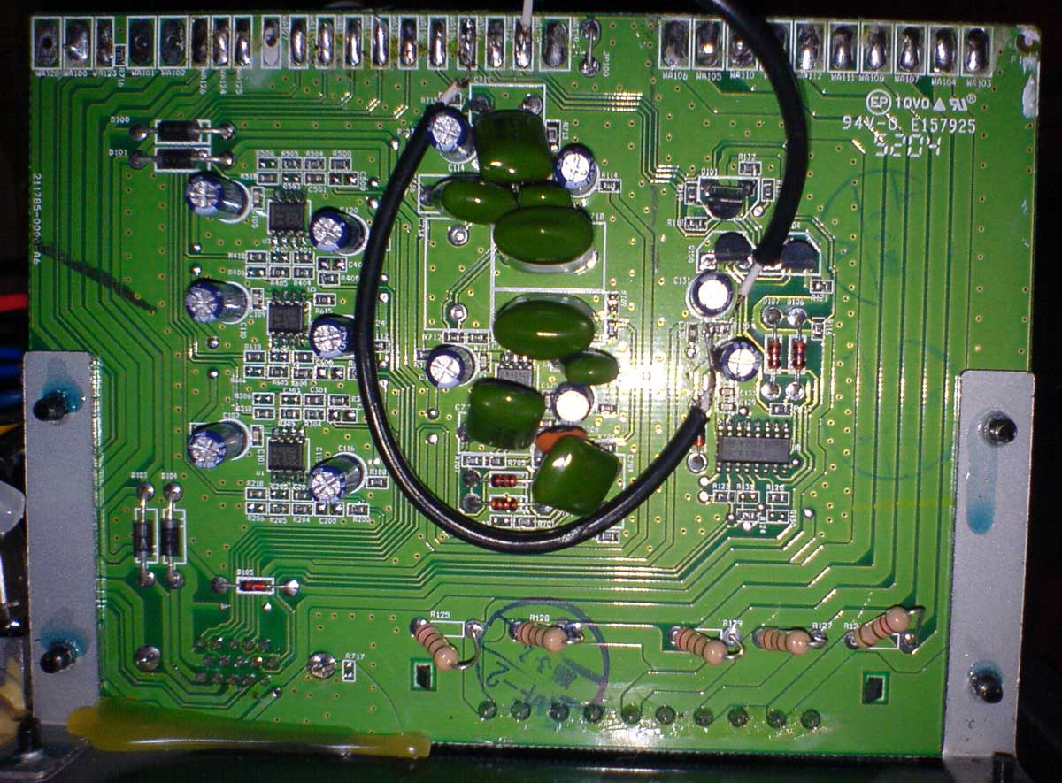

Hello. I want use my sub from Z5500 with Yamaha rx-740 without stupid POD.
I make circuit on TDA 7294. Subwoofer is turn on and i have sound but very quaiet. How i can make that sound louder?

hello, (google translator) sorry can not help your problem but maybe see if I can help you in mine, could you give me the value of the resistors R21 and R22 are on the back of the PCB samples in the photo?
Thank you very much and sorry for my English
Which revision you have and what modifications (pin connections) you made??
I bought a panel together with damaged electronics subwoofer (damage lies in the fact that it works only center speaker).
Equipment tested with another control panel (same situation), and my panel, I tested with different electronics and function normally.
This is a new revision - illustrative photo underneath.
http://img864.imageshack.us/img864/9182/481275582520.jpg
I do not want me to believe that all the TDA7294 and operational amplifiers have died.
In what may be a problem?

You have a complete different revision than mine, so i can't help you that much ... To activate all channels of the amp on my revision, i had to feed the orange, blue and white wire (cable from preamp to amp) with about +5VDC. If i only feed the orange one, just the center box works ... maybe thats your problem.
If that doesn't work out, you have to make some live-measurements with a voltmeter on the TDA7294-chips (with caution!!!). Check the supply-voltage etc. on each TDA and compare this measurements with the working one ... then you will hopefully see whats wrong ;-)
Good luck!
greez manni

I'm sorry to disturb but I need help both of you, beside the big blue capacitors are located resistors R21 and R22 would be possible to tell me the colors or values ​​that have such resistance to your pcb? I ask because my Z5500 are charred
