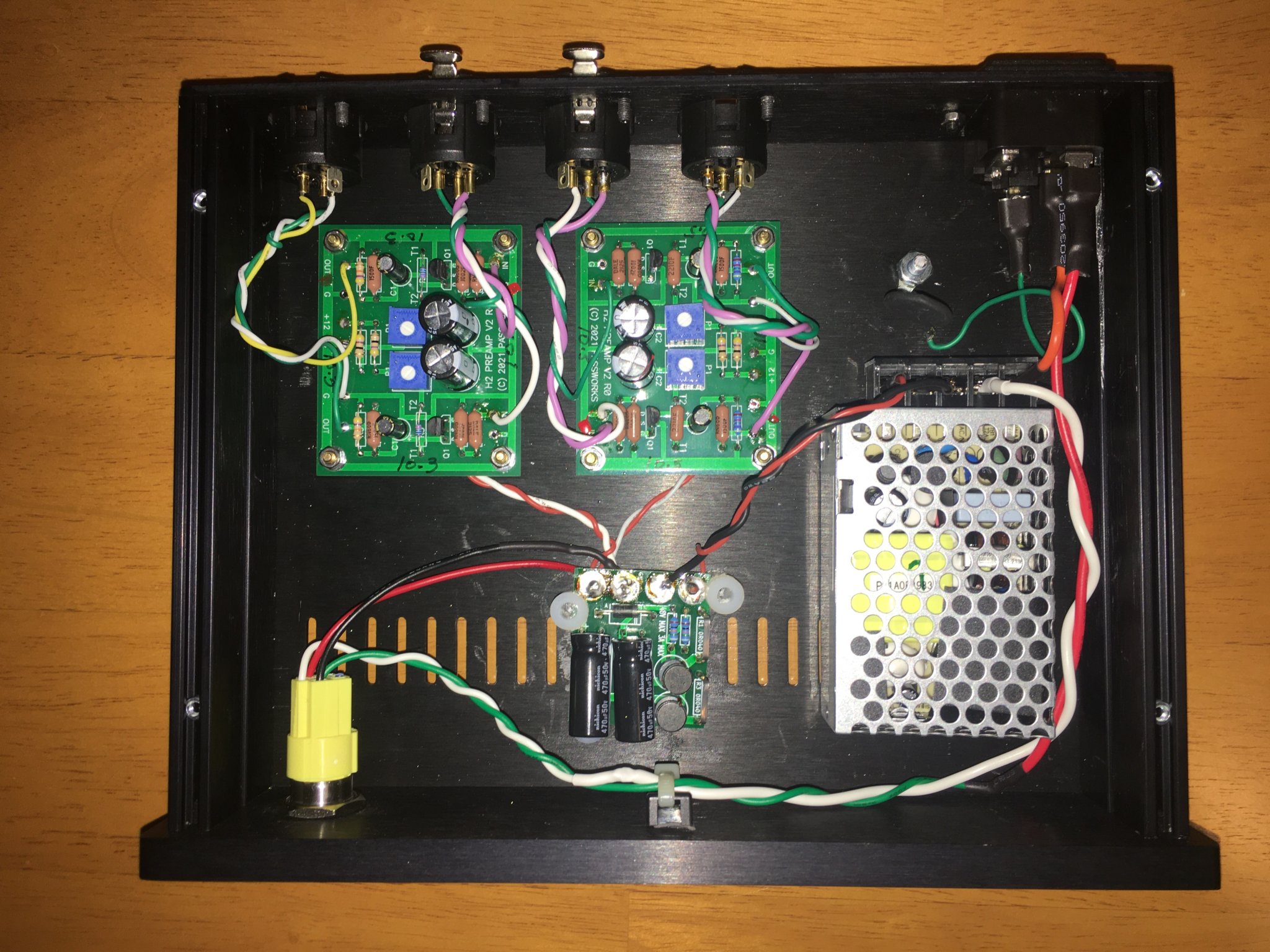

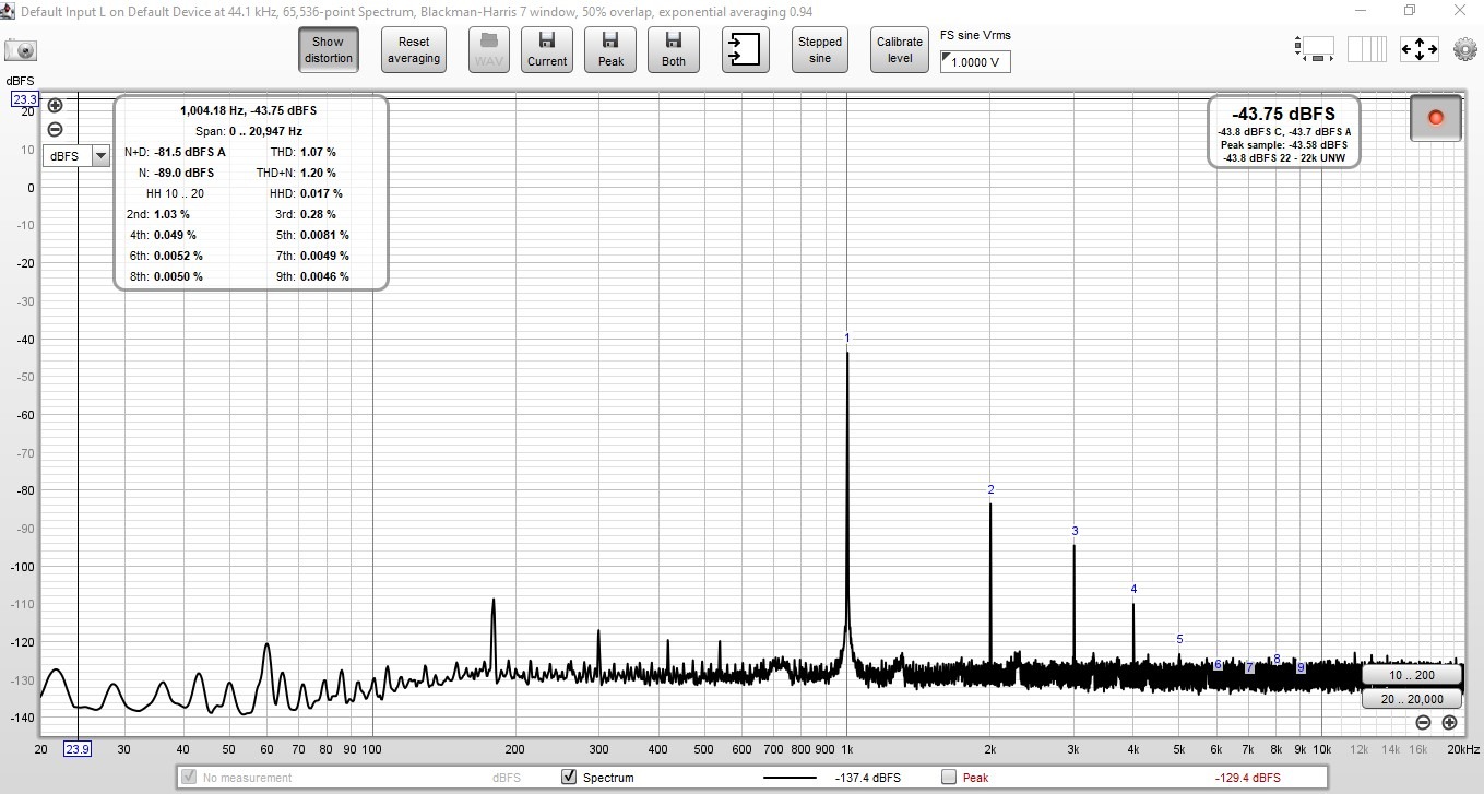

Here is my Balanced H2V2, built with unity gain. I used it with an ALEPH J amp and Balanced BA2018 preamp with B&W 804D speakers. Loved how it filled the room with sound, 3H is high, I could adjust the 2H to 1%, however the 3H is higher than I would like.
Target system currently has both preamp and amp operating balanced.Do you want balanced inputs or balanced outputs or both? There are ways to manage that, without messing up the second harmonic.

Do you have construction notes? Would measurement beyond a digital multimeter be required?
You will need to measure distortion using an XLR connector to an external soundcard and then into a laptop running REW software. Also, a very, very low distortion function generator is needed for the 1K sine wave signal. You adjust the + side and - side to get the desired H2 with the lowest H3 for each channel.Do you have construction notes? Would measurement beyond a digital multimeter be required?
Way beyond both my technical ability and available test equipment. Regardless, I DO appreciated your "H2V2 101"!You will need to measure distortion using an XLR connector to an external soundcard and then into a laptop running REW software. Also, a very, very low distortion function generator is needed for the 1K sine wave signal. You adjust the + side and - side to get the desired H2 with the lowest H3 for each channel.
You don’t have to do dialisys to enjoy the circuit. Operating voltages to get you safely within happy listening boundaries of distortion are provided by papa, and perfectly achievable without a giant test rig.Way beyond both my technical ability and available test equipment. Regardless, I DO appreciated your "H2V2 101"!
Of course, going «full circuit» will enable you do perfect the distortion residuals. If perfection is the goal. If you just wanna be a happy listener, I’d give the circuit a go without nothing but a DMM or two.
Not uncommon for balanced circuits with H3 replacing H2 / odd replacing even. But happy still?however the 3H is higher than I would like.

I believe the H2 has fairly high distortion at a 2V output. It's much lower at 1V.
You should try it to see if it's too high to your liking at the level you want to use it at.
