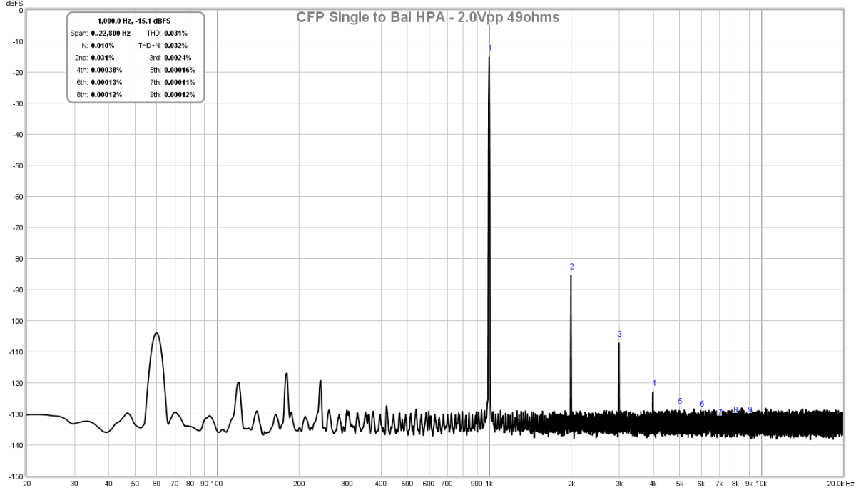

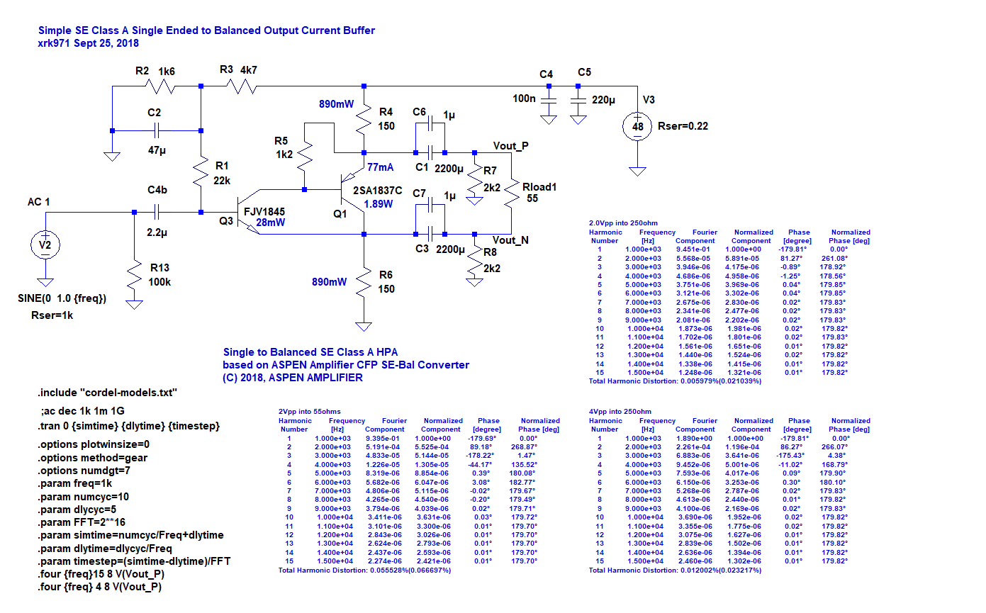

Yes, using the top and bottom half of a CFP in Class A provides balanced output and a dominant second harmonic. See clever design by Aksa here:
https://www.diyaudio.com/community/...2-transistor-se-class-a-headphone-amp.338656/
Balanced output into 49ohm load 2Vpp:
