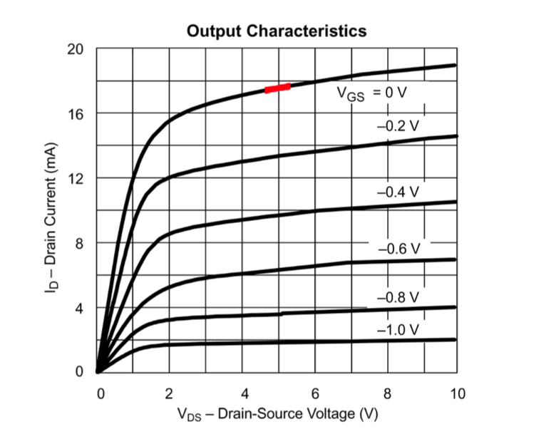

Forgive my ignorance, but this isn't clear to me. Does this mean you can change the positive to negative phase by adjusting the trimmers on the board? It's not clear to me how to do that and still maintain the sweet spot of Vds per the documentationIt is easy to set the H2 to + or - phase 2nd harmonic. This also allows nulling it altogether, all by setting the operating point.
Same with balanced operation.
If I'm adjusting the trimmer, what should I be looking for in the output voltage to know that I've succeeded (I don't have equipment more sophisticated than a multimeter)? If it's not adjusting the trimmer, how do I change the operating point?
Has anyone used an op amp to switch the phase back to match the input phase on one of these? I apologize in advance for my lack of understanding as I am not an electrical engineer at all. Just a broke audiophile with soldering skills. I would love to find out how to get the phase of the output to match the input and I have a handful of silicone op amps laying around.
No.Does this mean you can change the positive to negative phase by adjusting the trimmers on the board?
The trimmers set the amount of of H2, not the polarity. Polarity is changed at the speaker connections.
To change from positive to negative: "reverse the phase on the speaker connections to the amplifier. You don't
have to though - it would also give you a chance to hear the positive phase 2nd harmonic."
@elwood625 Right except above @Nelson Pass said:The trimmers set the amount of of H2, not the polarity. Polarity is changed at the speaker connections.
Saying that there was some way to change the operating point to change the polarity without changing the speaker connections.It is easy to set the H2 to + or - phase 2nd harmonic. This also allows nulling it altogether, all by setting the operating point.
The B1 Korg nutube circuit allows the polarity change via the trimmer, all of the H2 circuits are positive H2, to achieve negative H2 the speaker connections are changed.
"It's important to note that this circuit actually generates a positive phase 2nd harmonic, but
after you invert the output (to get absolute phase correct) you will find that it is now a negative
phase 2nd harmonic. I know this might be confusing – I have occasionally awakened in the
middle of the night and thought “That can't be right.” But it is, and if you turn the above
pictures upside down you should see it. If not, just invert the phase at the speakers anyway.
If you invert the phase of the signal before the circuit, then it will keep the positive 2nd."

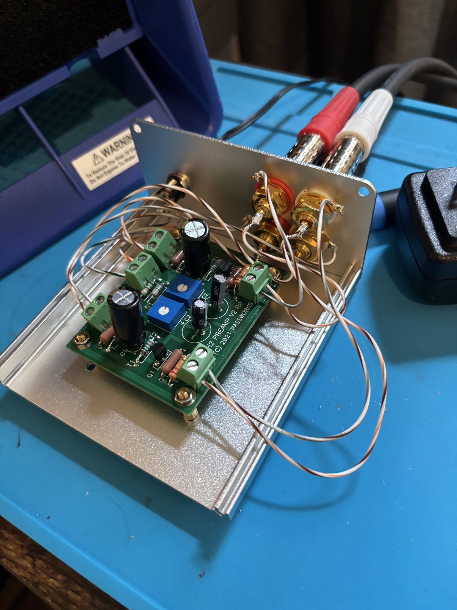

Welp assembled my H2 finally:
However, when I plug it in between my DAC and headphone amp all I get is very faint music and loud whirring sound, both only from the left channel. Not sure what I did wrong, any pointers appreciated. (I'll be the first to admit my wiring and soldering skills aren't top notch.)
There wasn't really room on the board for the screw terminals, they may not be seated properly in the board and that's what's causing the issue. I may have to take them out and just solder the wires directly.
