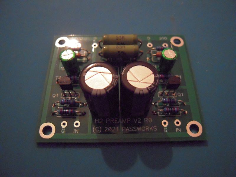

My package arrived.
Thanks to Nelson Pass for this gift.
And also thanks to Turion and Carsten for their efforts.

H2-generator
Hello out there,
some parts stuffed. Still thinking about putting the trimpots on the pcb or to
use externally, wire connected trimpots at the frontpanel....🙄
And a little PSU is still necesssary...CRCRC-filter + regulator?
Nice project!
Cheers
Dirk 😀

cubicincher: see my post #84 in the "H2 V2 Build" forum. Using M.J.'s PO89ZB plus a wall wort works wonderfully with Nelson's little circuit.

Hi Dirk,
I have the first version of the H2. I know you like very nice overkills, but TBH as Pete just said: SMPS+ Mark's filter are more than fine for this one.
The orginal H2 is a nice little soundbox that I mainly use as rough indicator at friend's to see if they could benefit from more negative H2. IMHO it does the job fine on normal HIFI systems. It doesn't have though the sonic qualities of a tweaked B1K to enhence more performing HIFI systems being used as a preamp for example. Hence not worth IMHO going for the ultimate PS, the H2 signature and limits will dominate.
That applies to the original H2, no clue on the later version, but seems close enough on the paper...
All IMHO of course
Claude

to ClaudeG #1095
Hello Claude,
I think the H2-generator is a fantastic tool to play around with the influence
of positive or negative 2nd harmonic.
Build, test and listen.... 😉
Cheers
Dirk 😀

I put 2 of these boards in series and set both set for unity gain.
The first one is adjusted for no distortion and inverts the signal.
The second is adjusted to 1% as per instructions and inverts the
signal back to the original phase.
I did it that way so the phase would be correct and
easy to switch in and out of the system as desired.
The diferance in the sound is subtle but noticeable,
I would describe it as adding a bit of fullness.

Interesting! Thanks for posting your findings.I put 2 of these boards in series and set both set for unity gain.
To get no distortion, how much higher did you have to set T2 voltage than the 1% value written on the bag?
I did not measure the voltage. I looked at the spectrum display from the program
Spectrum Analysis and adjusted it until there was no 2nd harmonic displayed.
Looking more at this one thing to consider if you change from one power supply
to another, you may need to readjust the pots if the voltage changes between them.
Thinking about this more it may be interesting to wire up switch to
flip the positions of the stages around (clean then 2H / 2H then clean).
