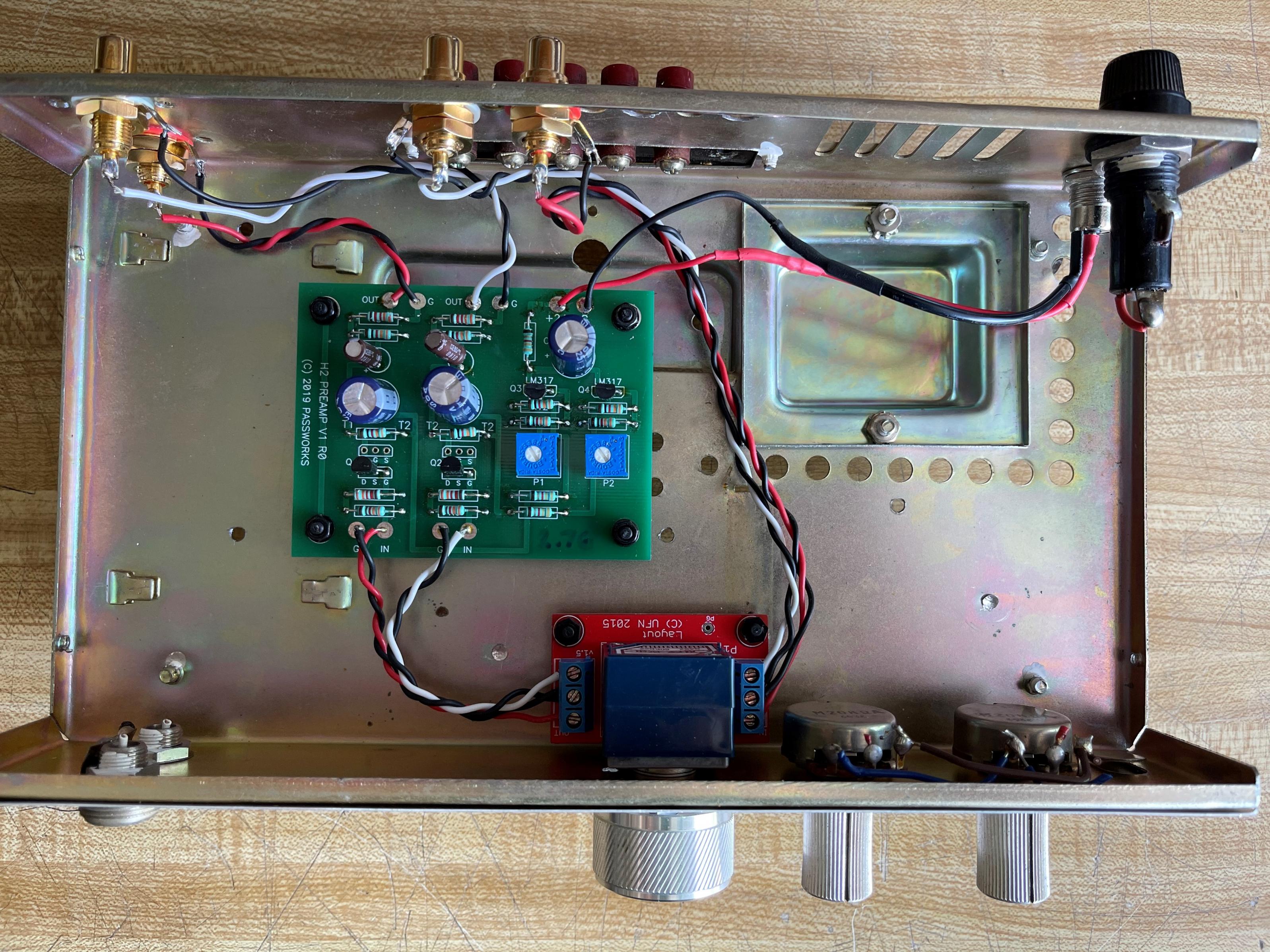

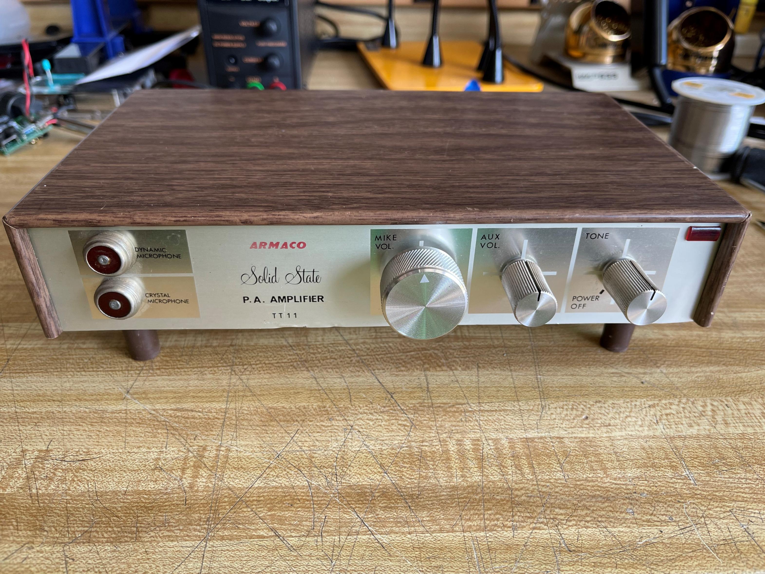

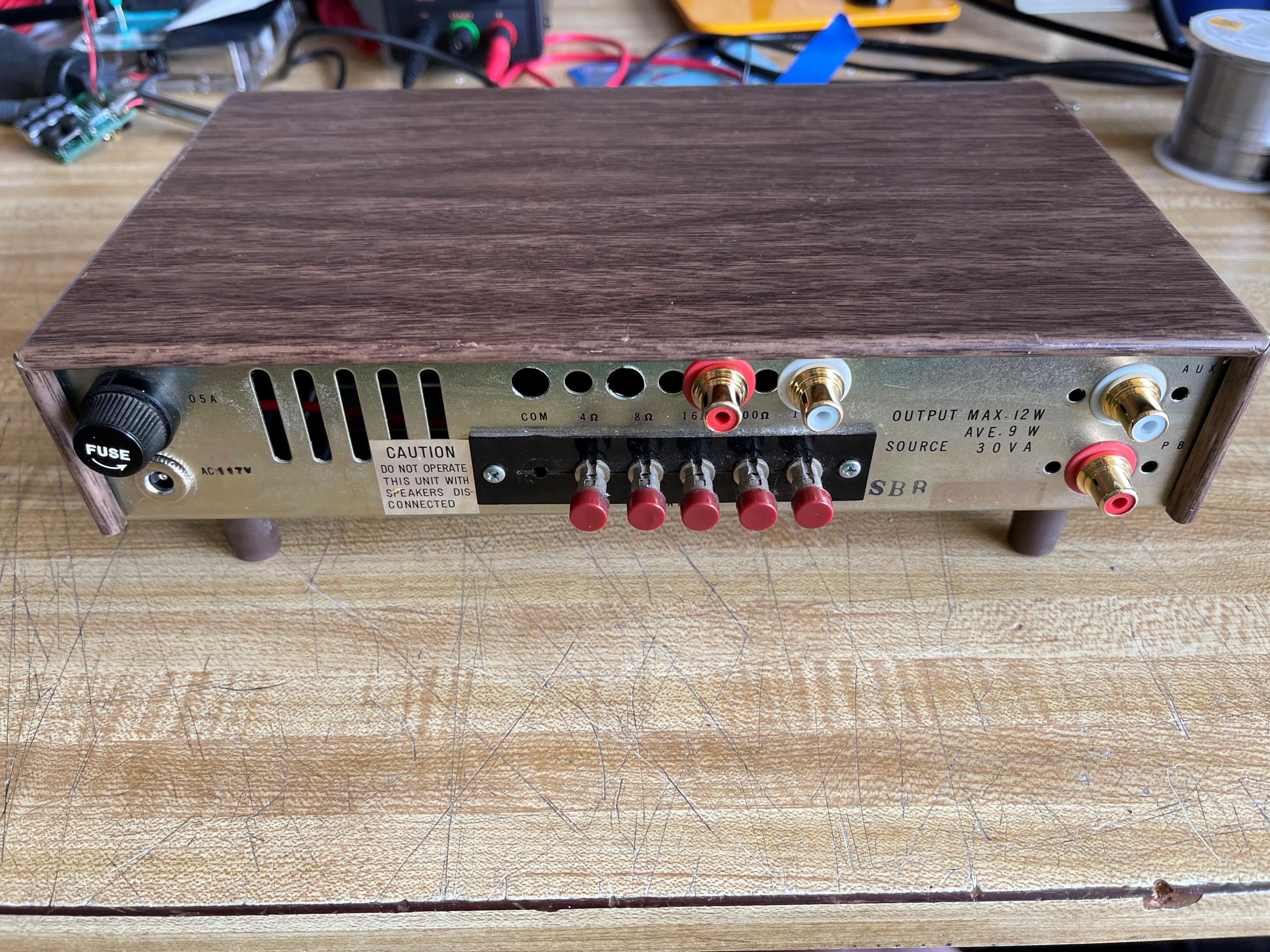

I spent some time thinking about a new chassis for it- working from the usual DIY starting points of interesting and cheap. Eventually, I found myself in the world of vintage PA amplifiers which cover both points, easily.
I bought this one from Ebay and paid more in shipping than for the amplifier. I'm a sucker for the "fake wood made from metal" look exterior. It's a small chassis with plenty of room for the H2. I was bit bummed that I couldn't use the vintage knob on the volume pot. Since the volume control is the only one now working on the faceplate, making the knob a different shape is probably a good thing.
I just need to connect an LED to the power supply and get my red lamp lit.

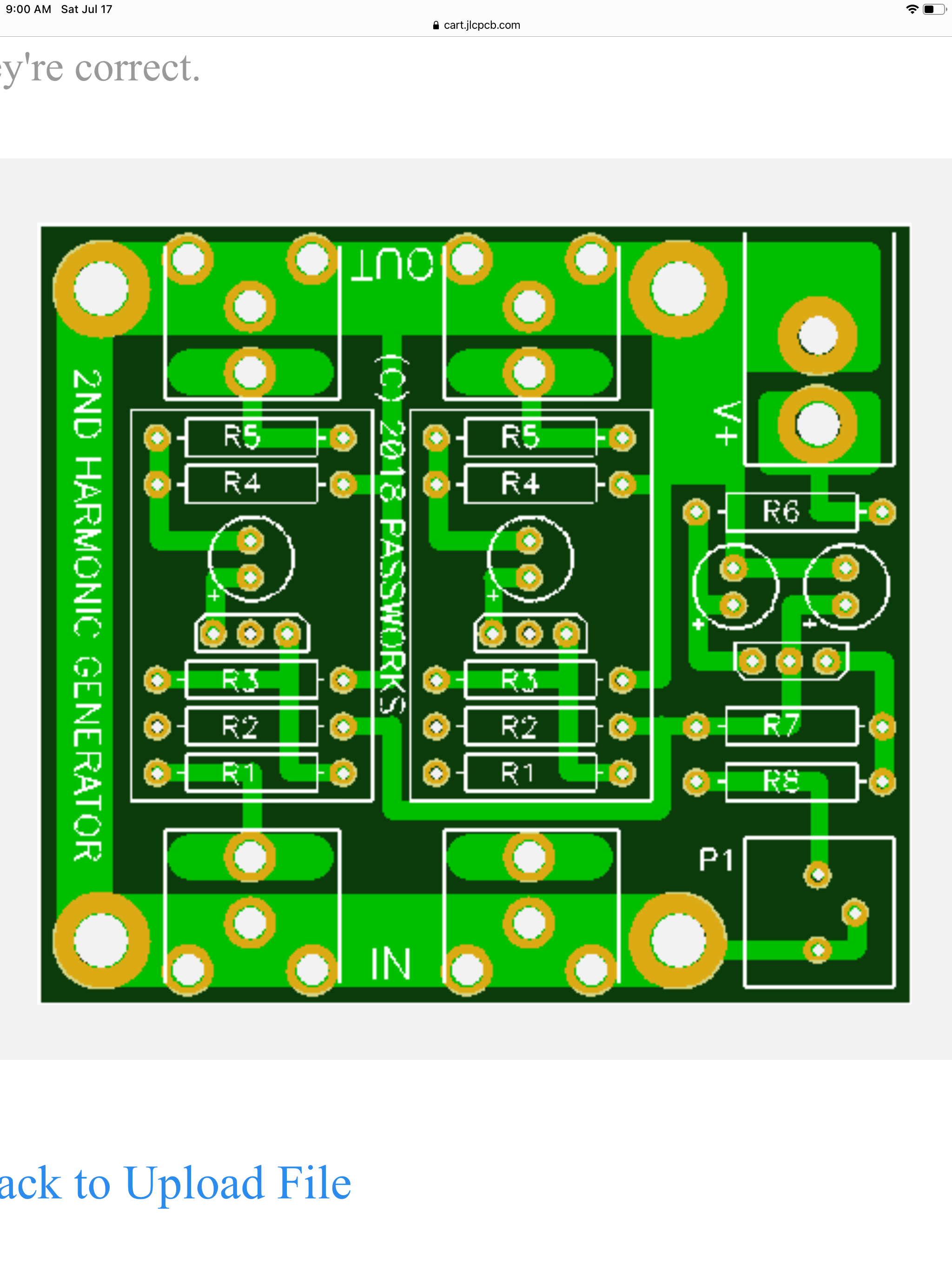

Hi Papa P:
Having recently built both the B1 & the B1 Korg, I’d like to try adding on the H2 after the B1. I see I can have the PCBs made (no issues there) but do you have any matched jfets (for the H2) that I can buy from you? I see there are no matching resistors like there are in the B1, correct?
Many thanks,
Pete
Going forward with H2

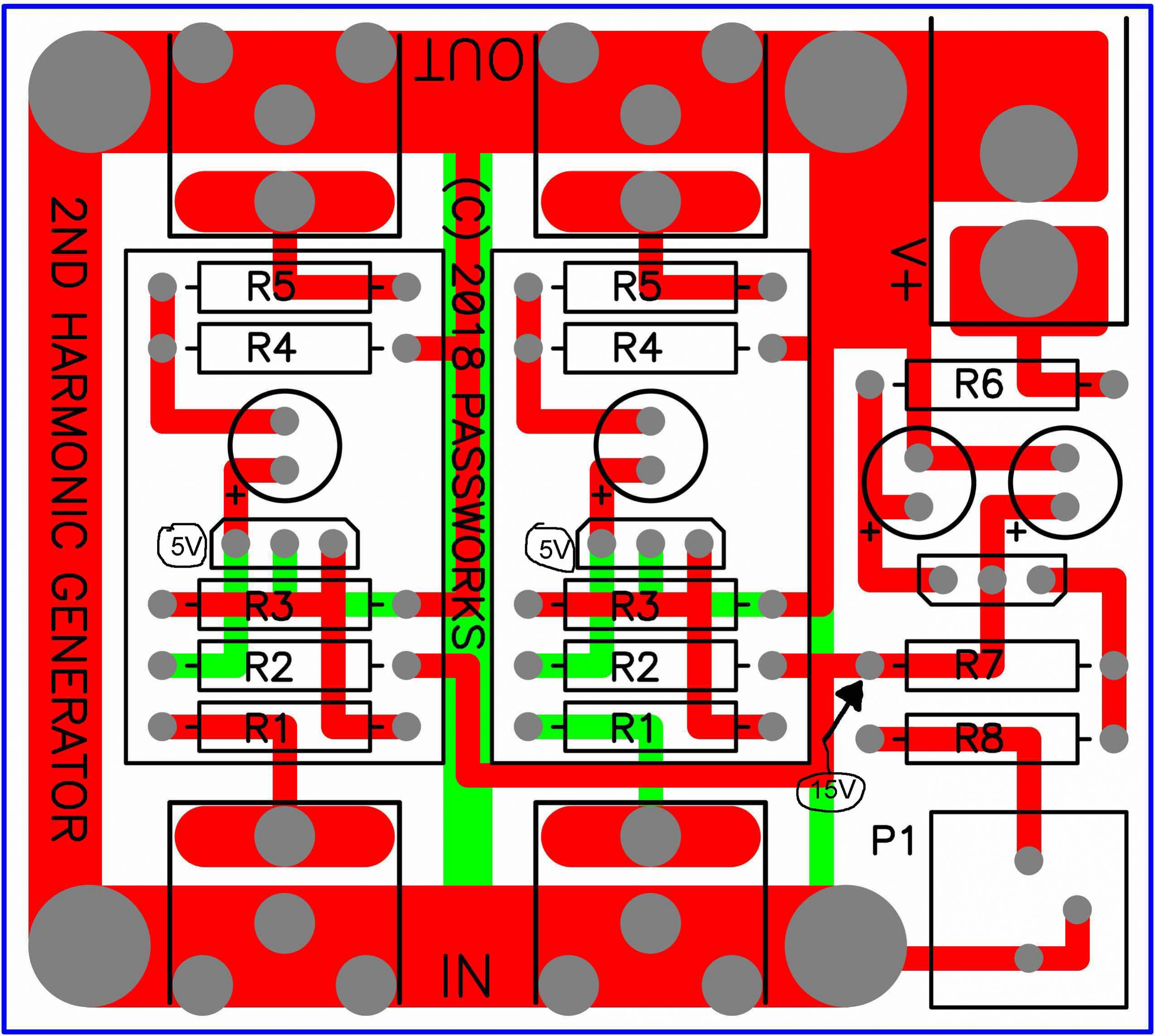

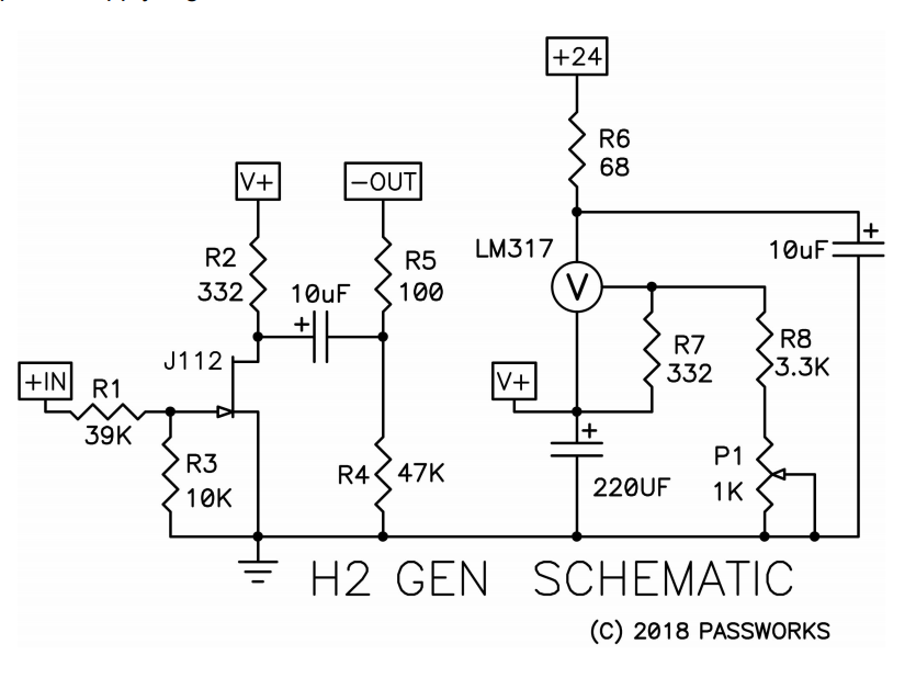

So this is what I’ve pieced together from the forum concerning the newer H2 boards we’ll be dealing with:
The new PCB from Nelson’s ZIP file (post #223)
The voltage measurement points from Nelson (post #256) and further discussion in posts #s 532&533
The new PCBs schematic? posted by Mark J (post#127).
I have this correct?
Cheers, Pete
