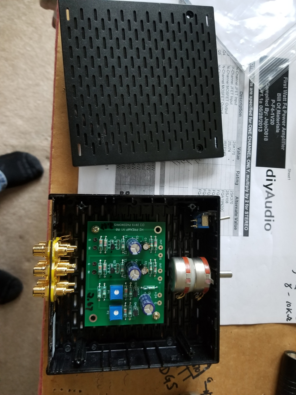

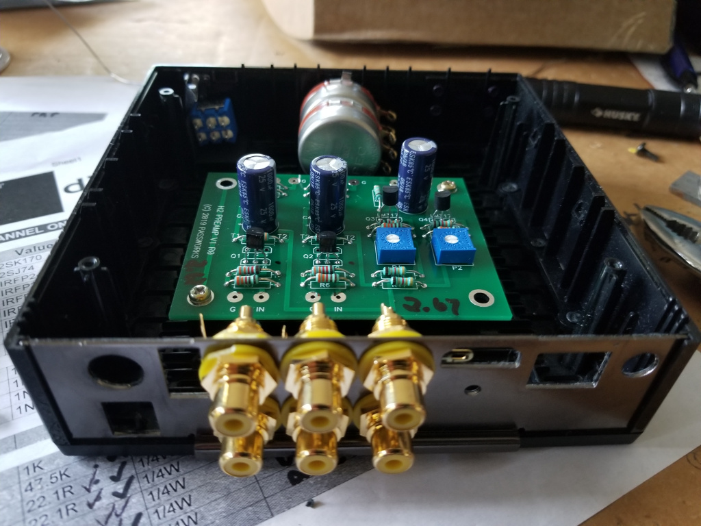

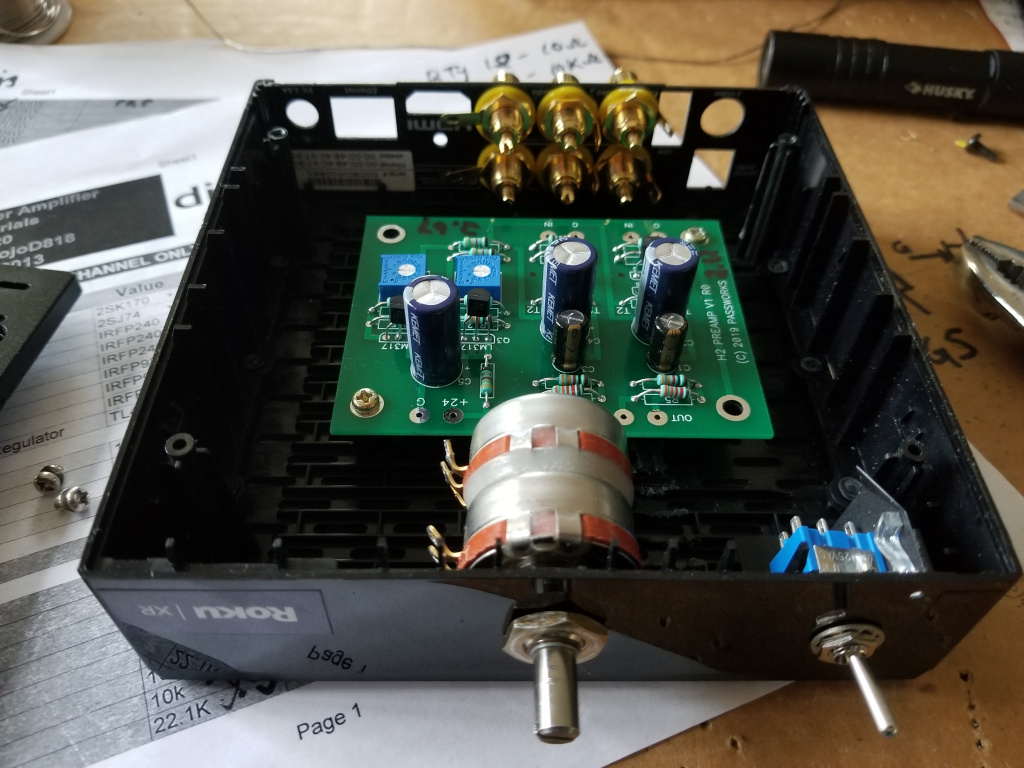

My H2 build so far.
Waiting on a panel DC jack.
Box recycled from an obsolete Roku.
Thank you mr Pass and SRMcGee for hauling it back from BAF.

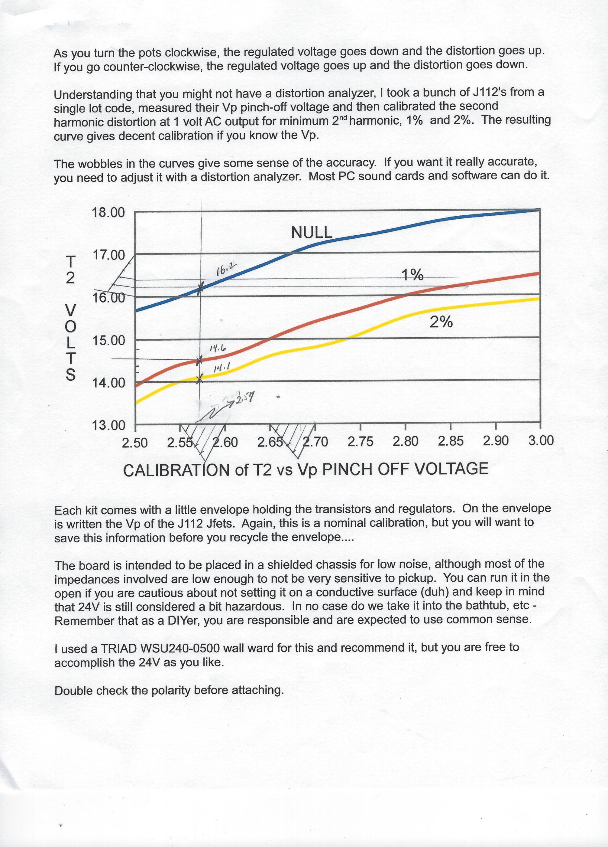

I would like to ask a question about adjusting the revised H2 which now has a variable pot for each channel. My bag was marked 2.65 but do not understand how this number is used to adjust the pots or what/where requisite readings are taken.
Details would be appreciated.
Thanks.
2.65 is your pinch off voltage. With a ruler, intersect vertically with the 2% and 1% lines. For each percentage, look for the voltage setting on the left hand side vertical scale for the voltage to get you to either 1 or 2 percent distortion. To adjust for this, you'll need a meter on T2 and ground.
Thanks, VDI.
Finally got back to this... Attached is copy of T2 vs Pinch Voltage of 2.57 (Not 2.65 as previously meintioned) with T2 determined to be ~14.6V for 1% distortion and ~14.1V for 2% distortion.
I will record initial V's at both T2 points and adjust for 14.6V.
Is the target output V approx 5V as with H2 Original?
Where is the proper place to measure...between the Out and G for each channel?
Thanks for continuing guidance.
