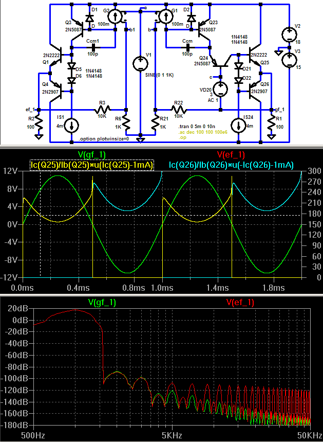

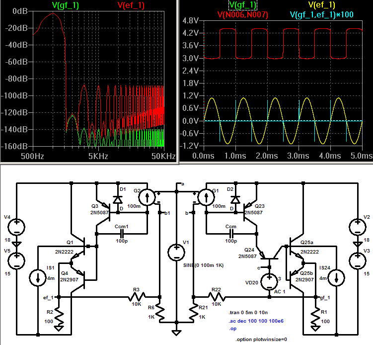

Here’s a toy amp comparison, top plot compares distortion with/without the “Gunderson stage”
The plot does show some minor potential for distortion reduction – about 50 dB for odd harmonics in this sim
While I would love to rub in a certain similarity to Gunderson’s patent and point out that distortion improvement is most noticeable at high frequencies where, as I earlier mentioned the low AC impedance of the VAS gives a larger local loop gain to the Q24,25 composite I must confess that the practical usefulness is questionable
When the output stage has reasonably low Vbe voltage distortion as we would all strive for with Class AB bias the distortion reduction of the Gunderson connection disappears
So the Gunderson circuit seems to be most suited to “saving” a amp with a really crappy underbiased Class B output from excessive crossover distortion

Got Bias!
Added some bias diodes so there is now little left but a few ideal sources in my sim circuit’s approximation of the patent
Bumped the signal back up to 11 V output amplitude to exercise the output transistors’ current gain
Plotted the current gain of the output transistors (where the |Ic| > 1mA to avoid divide by zero spikes)
I think the beta variations can explain the 2nd and 3rd harmonics in the fft pretty well
2nd harmonic comes from unequal average Beta between the upper and lower output Qs (yellow and blue traces, right vert legend)
3rd harmonic comes from the compression from the ~ 20% droop of beta near the peaks (Ic ~= 110 mA) visible in both upper and lower output transistor beta curves
at 5KHz and above we can see Gunderson correction of crossover error harmonics from the still slightly under biased Class B operation – but the crossover distortion harmonic tail level is much less than my previous sim with 0 bias
also note the ~ 20 dB/decade increasing distortion reduction of the Gunderson as frequency rises from 5 – 50 KHz, I think this slope is explainable by increasing local Q24,5,6 loop gain as the Ccm compensated VAS output impedance drops with increasing frequency
I think this sim simultaneously illustrates the Gunderson operation and points out its impracticality - the 1st few harmonics are likely dominated by output device current gain errors which the Gunderson circuit cannot correct – and where the sim shows some correction/distortion reduction the errors are already below any recorded music’s S/N at –120 to –140 dB

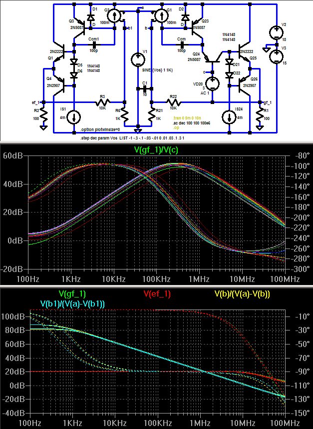

Any argument about distortion reduction and feedback needs some AC loop gain plots
Top circuit is a slightly modified circuit attempting to measure the local loop gain of the Gunderson compound transistor in the toy amp with VAS/Ccm driving impedance
It is desirable to cover a range of operating points – in under biased Class B the output Qs Ic and gain varies over a huge range – so I introduced Vos in the V1 sine source to set differing DC bias points for a series of stepped AC analysis
To disable the global loop in the plot I shorted node “b” to gnd with a 10 F Cap (spice trick) and moved the AC 1 excitation to VD20 – inside the Gunderson compound feedback loop
The simple Middlebrook test in the center AC plot shows rising local loop gain inside the Q24/25,6 compound transistor starting from ~ 500 Hz frequency where the VAS impedance becomes lower than the impedance seen at Q25,26 base (upper/left-most hump is phase, LtSpice still has plotting bug that doesn’t dash all of the phase traces in a plot of a equation - the loop gain curves rise from ~ 0 dB @ 100-500 Hz to peak ~ 55 dB @ 300 – 600 KHz)
The bottom plot has the AC source moved to V1 input and the loop shorting C is removed – the loop gain of both circuits are plotted for the various bias steps, the purpose of this plot of global loop gain is to see if big loop gain differences exist that might explain the distortion differences – doesn’t look like it (only the 0 and 1 V Vos steps are plotted here)

However, your loop-gain plots are in error.
You cannot plot minor loop transmission without decoupling said loop from the global loop at frequencies of interest.
Additionally, i suspect your simplified loop-gain analysis is severely compromised by loading at the point of insertion.
Indeed, i suspect the rather disappointing performance of Gunderson is due to the fact that the scheme acts in phase opposition to the foward-path voltage delivered by the second stage.
This, therefore, is degenerative feedback, and reduces both minor and major loop gain quite drastically, which defeats its reson d'etre.

jcx said:Any argument about distortion reduction and feedback needs some AC loop gain plots
...To disable the global loop in the plot I shorted node “b” to gnd with a 10 F Cap (spice trick) and moved the AC 1 excitation to VD20 – inside the Gunderson compound feedback loop
The simple Middlebrook test ...
Global loop was disabled for the inner/Gunderson loop gain plot, 10 F kinda pretty sorta effectively shorts out global feedback while still allowing LtSpice to find DC operating point ( R21\\R22 * C1 ~ 1000 seconds => ~ 120 dB feedback attn @ > 100 Hz)
I believe the conditions for the simple test are reasonably met - large impedance diff seen at either end of test AC V source - at least to low MHz (100 Ohm R1 load || Q25,6 emitters vs Q24 base)
of course the loop gain probe subcircuit approach can be more accurate but it is awkward with multiple instances in comparing the 2 circuits and next to impossible to use with stepped bias
I would welcome anyone playing with my sims to improve the accuracy or illustrate where I’ve gone astray – but that requires reading my explanations and studying the circuits I simed
