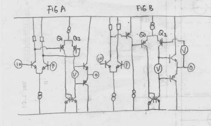

Consider the impedance the VAS "sees". Again, refering to Fig. 5. It appears to me that with Q24 in place, the current the output transistors receive from the VAS stage is almost identical to that without Q24, at low frequencies (only differing by Q24s base current). This is Jan's observation.
BUT the voltage the VAS sees is different. Before, it was the voltage drop across the output devices, V3-V2, + Vout and now it is Q24 Vbe + Vout. Therefore the impedance the VAS stage sees is slightly different.
If we assume Q24 beta is so large as to be negligible, then is the question simply whether Q24 Vbe contributes less distortion to the main loop than the output stage Vbe?
Hi, Traderbam,
Your gunderson.jpg is nice. Q1+Q2 in your example is the expansion of Q24 in fig.5. Q1+Q2 is the "differential" version of this idea, while the original is the "singleton" version (like input of JLH amp). In your example, is that the original VAS transistor is driving the base of Q2? In Gunderson's, Q24 is common base, all current is coming from Q23. Maybe this is the difference with the "differential" version?
I think Q24 is doing more than just "adding" gain. For example, putting another transistor to form a differential VAS will be also adding gain. But here, Q24 also doing "comparing" between input and output. It is comparing between point 1 and point 2, and partially can do "fixing" if point 1 and point 2 is not balanced. Q24 shares the burden of "fixing" things, so the job of input differential pair (Q21-Q22) is helped so much by the action of Q24.
Q24 that can do "fixing" is helping the whole system much, compared if Q24 is only "adding" OL gain without able to do "fixing".
In Fig.A, Q1+Q2 is "adding" OL gain. But in Fig.B, Q1+Q2 is doing "fixing".

Yes. I put a differential here to show the similarity of the Gunderson circuit to an ordinary feedback loop.In your example, is that the original VAS transistor is driving the base of Q2?
Jan, I was considering the approximation that the output current from Q24 is always the VAS current. For if Q24 beta is very large and we neglect junction capacitances then Q24 Ic must equal Q24 Ie, always.The output current from Q24 is initially determined by the current from the Vas.
Any given change in output voltage will require the same current to the output stage regardless of whether Q24 is in circuit or not. The VAS has to supply the same current in either case. Therefore, the ONLY difference from the VAS point of view is the difference in Vbe between the output transistors in one case and Q24 in the other.
traderbam said:Yes. I put a differential here to show the similarity of the Gunderson circuit to an ordinary feedback loop.
Yes, I see, I think you are right. So, what the varying Vbe does is just varying the Vas output voltage, iow the Vas output follows the Vout. Now, if that is true (and I think it is), it would mean that there is NO isolation! The Vas follows Vout is almost the same as the Vas follows the output stage input: in both cases there will be a signal on the Vas going through the capacitances and that was just what Gunderson wanted to avoid!
Jan Didden
I think the wording of the patent is a little confusing. He talks about isolating the output voltage from the VAS output but I think he reallty means he is trying to isolate the Vbe of the output stage from the VAS. The VAS will normally see Vbe + Vout. He is just trying to reduce the Vbe component. Of course we know that Vout will be full of distortion due to the non-linear current gain of the output stage no matter how much Vbe is linearised or reduced. So this is just a PARTIAL fix.
Even so, it is a clever idea. I wouldn't use it as prescribed because the current through Q24 needs to be quite a big proportion of the output stage bias current to make the improvement worthwhile and because it appears to demand undesirable stabilization measures. The cure may be worse than the disease!

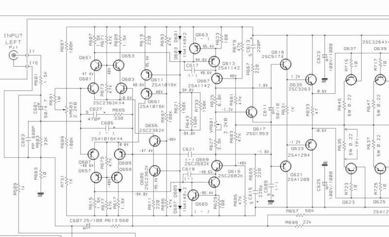

If Rotel use it then it can be made to work. They are a very commercially minded company making budget equipment. They don't tend put stuff in unless there's a reason. Especially if it's not immediately obvious to the customer.

Don't forget that there is only a benefit if the linearity of Vbe of Q24 over that of the output stage exceeds the downsides of having added another gain stage and another feedback loop. Maybe...
It isn't "another feedback loop", but moving where the VAS takes its feedback from. Including the output stage looks good in principal, as long as stability isn't compromised. The Vbe linearity will be far greater than that of the output stage if that's what you mean, as the current through it is mostly constant. During clipping that will change drastically, and that may be where trouble starts.
This isn't another gain stage. It's just a level shifting follower. A cascode isn't a gain stage for the same reason.

Hi, Jagwap,
If it is about isolation, ordinary cascoded VAS would do isolation too? (like one in post #18). Why bother about modulating the base of Q24 following output stage, static cascode towards rail will do? Besides that, if Q23 is static cascoded toward +rail, the "Early Effect=modulated gm caused by modulated VCE) will be minimal.
The one that Rotel use is quite different. It uses voltage divider (output node-rail) as reference for Q24. It does not use zener.
Maybe zener is good in theory, but in real amp, if the supply voltage for the VAS is the same as for the output stage (front end not higher than output stage rails), zener in position of D20 will make the front end saturated badly when the output voltage approaching max rail voltage. Q23 will be full ON while Q24 will be OFF. The differential and VAS will be badly saturated this way. Maybe this is why Rotel does not use zener.
The one in Rotel amp may give distortion reduction, but it is because Q23 will suffer only half the "Early Effect" if Q24 is modulated half voltage like Rotel uses (47k-47k). The VCE swing of Q23 will be half compared when there is no Q24 attached.
"Fixing" effect is also disappear when using voltage divider as base input for Q24.
And, Q23 will only dissipate half heat compared when there is no Q24 used.
An ordinary cascode would only isolate the the inherent parasitic miller Cobl, as Ccm would need to be put on the collector of the cascode in order to be the dominant pole for stability, and then still inject the voltage distortion of node 3.
The voltage divider in the Rotel (not seen it. Have a schematic?) will do the same as the zener version but with xdB less feedback (where x is the potential divider ratio, in this case 6dB). As you say, the early clipping of the zener solution is removed, but Q24 will still be hitting Q23 at clip.
