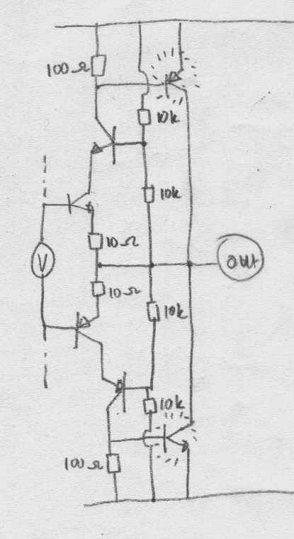

jagwap said:[snip]The voltage divider in the Rotel (not seen it. Have a schematic?) will do the same as the zener version but with xdB less feedback (where x is the potential divider ratio, in this case 6dB). [snip]I think a simulation will give more insight.
Are we talking about Q617 in Lumanauw's diagram? I think that one has a completely different function, I think it is the bias regulator. Its E and B are shorted (for AC) to the Vas collector so there is none of the isolation effect.
Jan Didden
Jan Didden
No, it's Q667 & 615, with C617 & 619 as Ccm. The circuit is symetical so has two of these circuits to isolate both VAS's
Right.

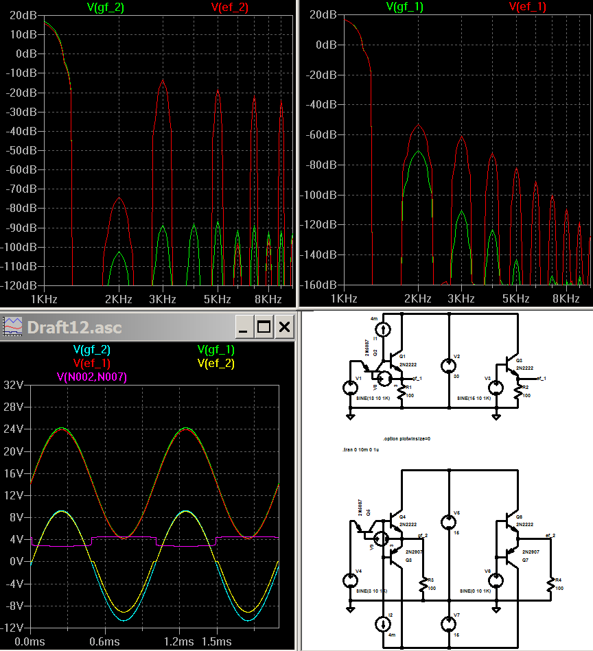

For a 1st pass I decided to look at Gunderson’s circuit as another compound transistor like Darlington, Sziklai, Baxandall that can be used as “emitter followers”
The plots compare the “gf” compound follower against the single stage versions, with the unbiased complementary follower used to give an extreme example of the Gunderson circuit’s distortion reduction capability
The zero impedance voltage source drive emphasizes the high gain voltage feedback properties, you can investigate current source drive and argue over “local feedback” vs “isolation” but the local feedback explanation/viewpoint works for me
Upper left fft: distortion of zero bias Class B versions exaggerates the distortion due to Vbe dead zone and shows good distortion reduction for Gunderson’s circuit
Upper right fft: distortion of Class A follower show useful distortion reduction for Gunderson’s circuit
In the waveform trace the V(N002,N007) trace is the Q5 ce voltage = the deadzone of the Class B output and the error correction voltage

Hi, JCX,
Thanks for the effort.
If the strong point of this cct seems not in the "isolation" but in the "local feedback", the difference in the patent (using D20 as fixed value level shifter) and in the practical cct (Rotel=using voltage divider for reference of Q24) may result that the "local feedback" is working or not-working, is it true that using voltage divider is eliminating the merit (=error correcting capabilities) of this cct?

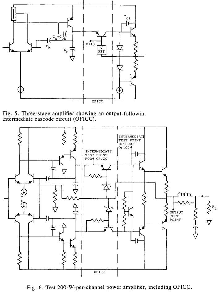

Folks..
As previously noted, it is, perhaps, more useful to consider that, from the perspective of the minor loop, the so-called 'cascode' transistor is merely an emitter follower with respect to voltage fed back from the output stage.
This, indeed, is a negative feedback loop, and conspires to reduce major and minor loop transmission at LF by more than two orders of magnitude.
I suspect that since this loop is considerably degenerative, the magnitude response of the minor loop drops well below unity before output stage singularities compromise minor loop stability.
This, it would appear, is a fascinating way of stifling excess loop transmission whilst nominally enclosing the ouput stage within the monor loop.
However, it is not without obvious vices. For instance, biasing the 'cascode' with a zener diode reference is clearly a faux pas, as the zener will certainly drop-out as the output approaches the rails; Rotels resistive reference slightly ameliorates this problem-methinks

JCX, thanks for the simulation. However as there is no VAS, there is no feedback or isolation. Also, in a single ended solution there is little of the distortion worried about to isolate from.
If it is feedback that is of concern then it only works at higher frequencies, as Ccm is the path (and Cobl), and whether it is a level shifter with a gain of 0dB like a zener or a voltage divider as in Rotel then it only alters the amount of feedback. While the zener restricts the headroom of the amplifier earlier than the voltage divider, both of them will hit the VAS unless higher pre-driver rails are used (recommended for lots of other reasons).
However, this circuit is only an error correction system in that it stops an error being passed into the base of Q23 via Ccm, not in the classic sense. So I feel it is misleading to describe it as such.

Ok...
...this scheme has proved rather disappointing; THD hardly falls by 3dB from 10KHz-20KHz with single-pole miller compensation, and remains completely unchanged at LF.
Double-pole compensation, without Gundersons arrangement, and properly implemented, provides a far more dramatic reduction in nonlinearity.
Was this simulated or on the bench?
Is it possible that it removed more than 3dB, but another THD dominated after it dropped? The patent suggest significanly better results (well it would wouldn't it!)

jagwap said:Was this simulated or on the bench?
Bench.....with a heavily modified RB1090
jagwap said:The patent suggest significanly better results (well it would wouldn't it!)

I reckon only providing higher supply rails for the voltage gain block would optimise this arragement; otherwise the bootstrap cap. would merely drive the 'cascoded' BJT into cut-off as clip is approached.
Christer said:So if Gundersons approach has little benefit and two-pole compensation is much better, we are still left with the mystery why Slone uses a combination of both methods. Could it be the little extra benefit, or is the Gunderson-style approach after all rather there for some other purpose, as has been suggested in earlier threads? Since this wasn't in his book, I don't think he has written anything about it himself, so we probably have to guess his intentions.
Indeed, i am rather mystified about the practical benefits of this arrangement.
I can send all interested parties a copy of the JAES .pdf; perhaps someone will spot something we've missed.
