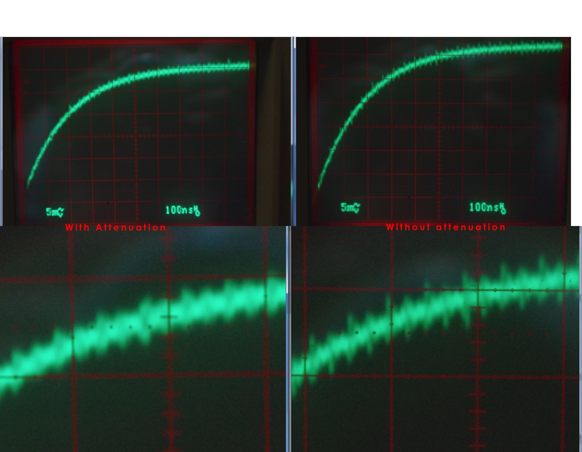

Attenuation update.
Been playing around with the attenuation PCB i made.
Now that i realised that LE - latch enable is triggering the sample to the analog outputs with the offset binary format (simultaneous mode), it occurred to me that i should try to attenuate BCK and the data lines only. (small amount on LE)
DATA L/R: 470R
BCK: 470R
LE: 50R
Please note that this is probably not a desirable setup, just for testing purposes before i make the Diode attenuator.
Attached is a shot of a full scale current sample, the rising edge has a rise time of about 550ns (22nF on the analog outputs)
Notice a 1mV reduction in switching noise with attenuation.
As for how it sounds.... Promising signs - Definitely worth taking it further.
