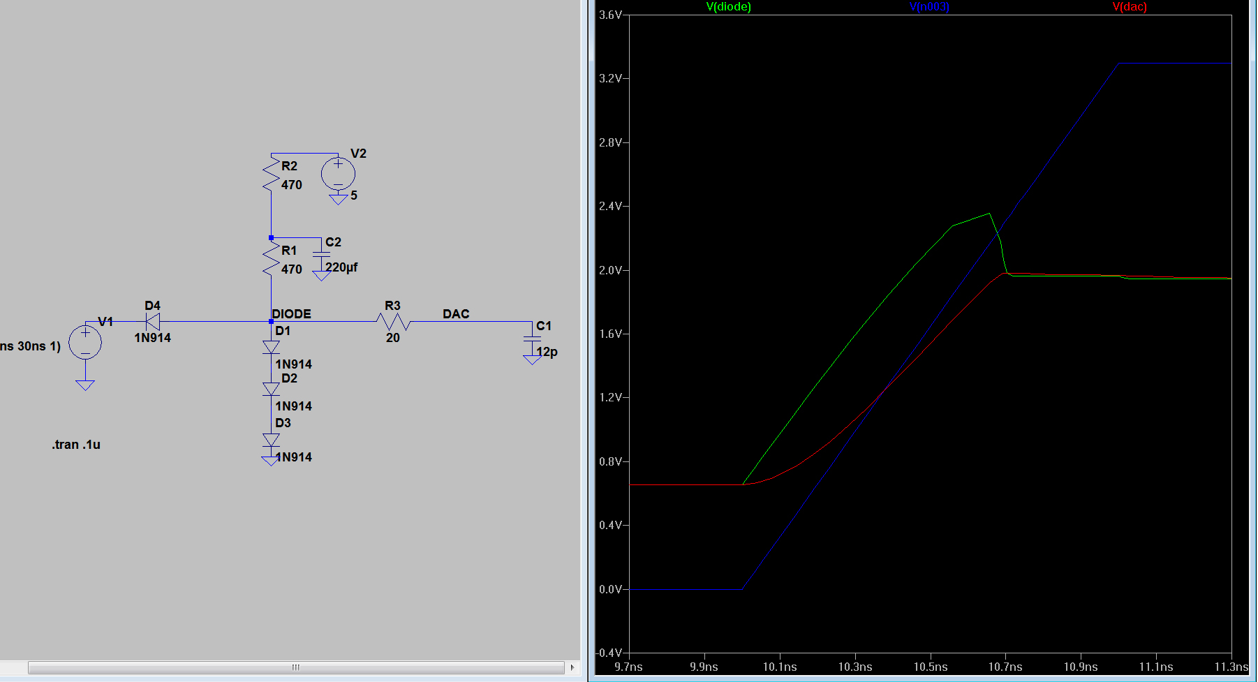

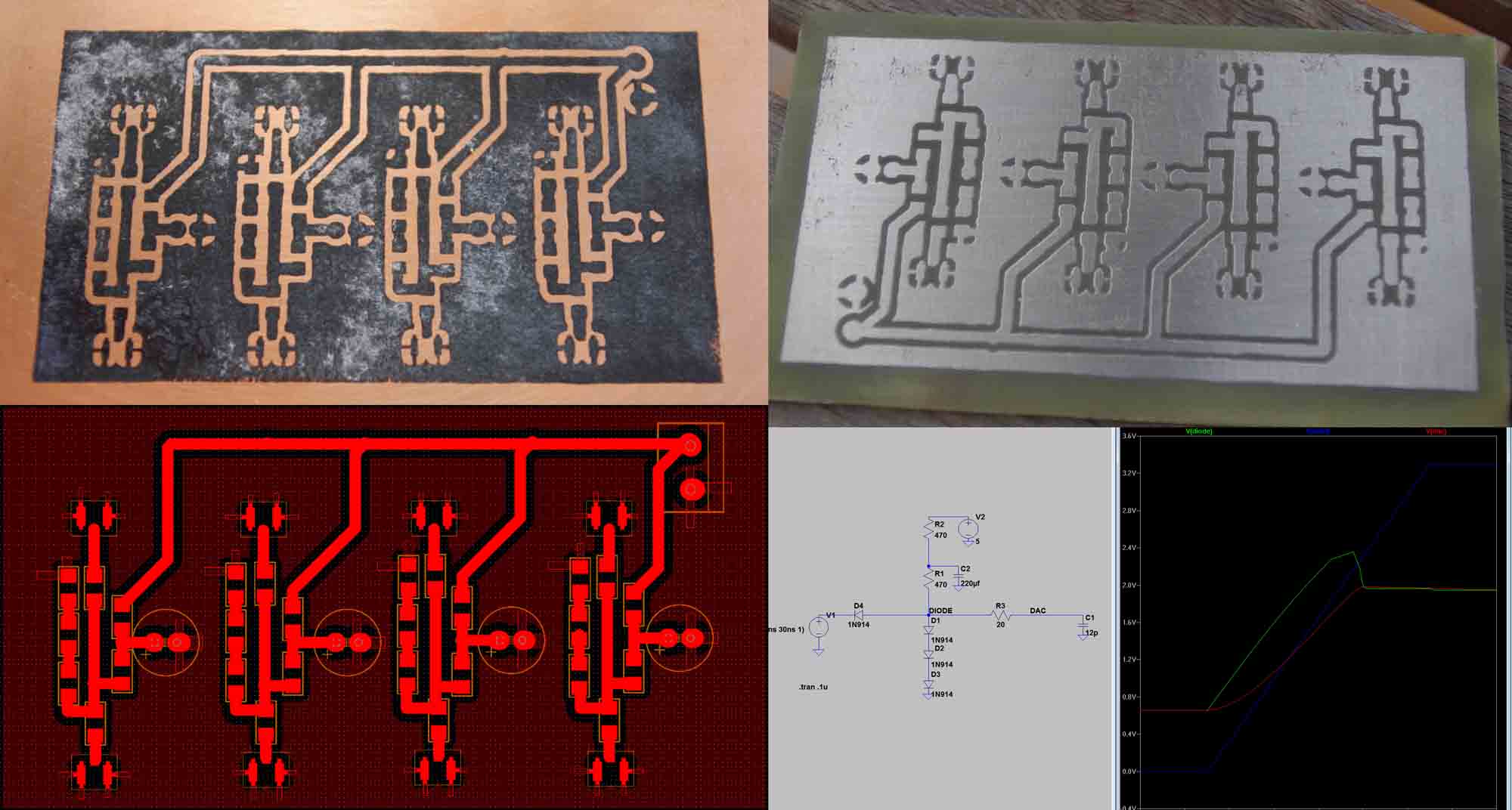

Attenuation update.
Hi Everyone,
Just wanted to share where i'm at with the atten stuff.
R1 and R2 are not 470R as in the schematics, it simulates better having them 750R each. puts a bit less strain on the logic driving chip at the other end.(Iancanada i2s to pcm pcb). Also R3 may be omitted or 10R, just going to try and see how it sounds, gives less overshoot with a small amount of series resistance.
Vias (drilled hole in this case) will be drilled to connect both copper fill layers to follow some type of digital design protocols - A bit of rough impedance matching. Im using this pcb as function verification only- not expecting amazing results. If it works it could be included into future designs, have to test it first.

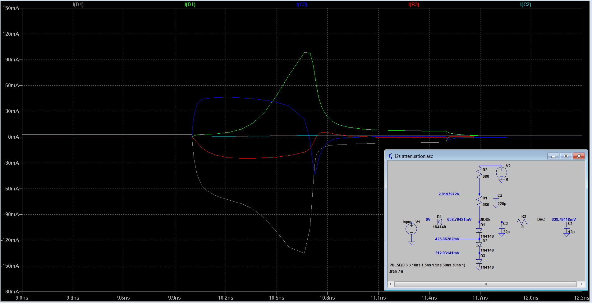

Circuit simulated current flow
Attached is the simulated current flow on the rising edge going through the attenuation circuit. Really helps to understand what is actually going on here.
Parts for the circuit have been ordered, once arrived ill finish the pcb and start testing. After the test period we will know whether its worth pursuing or not.

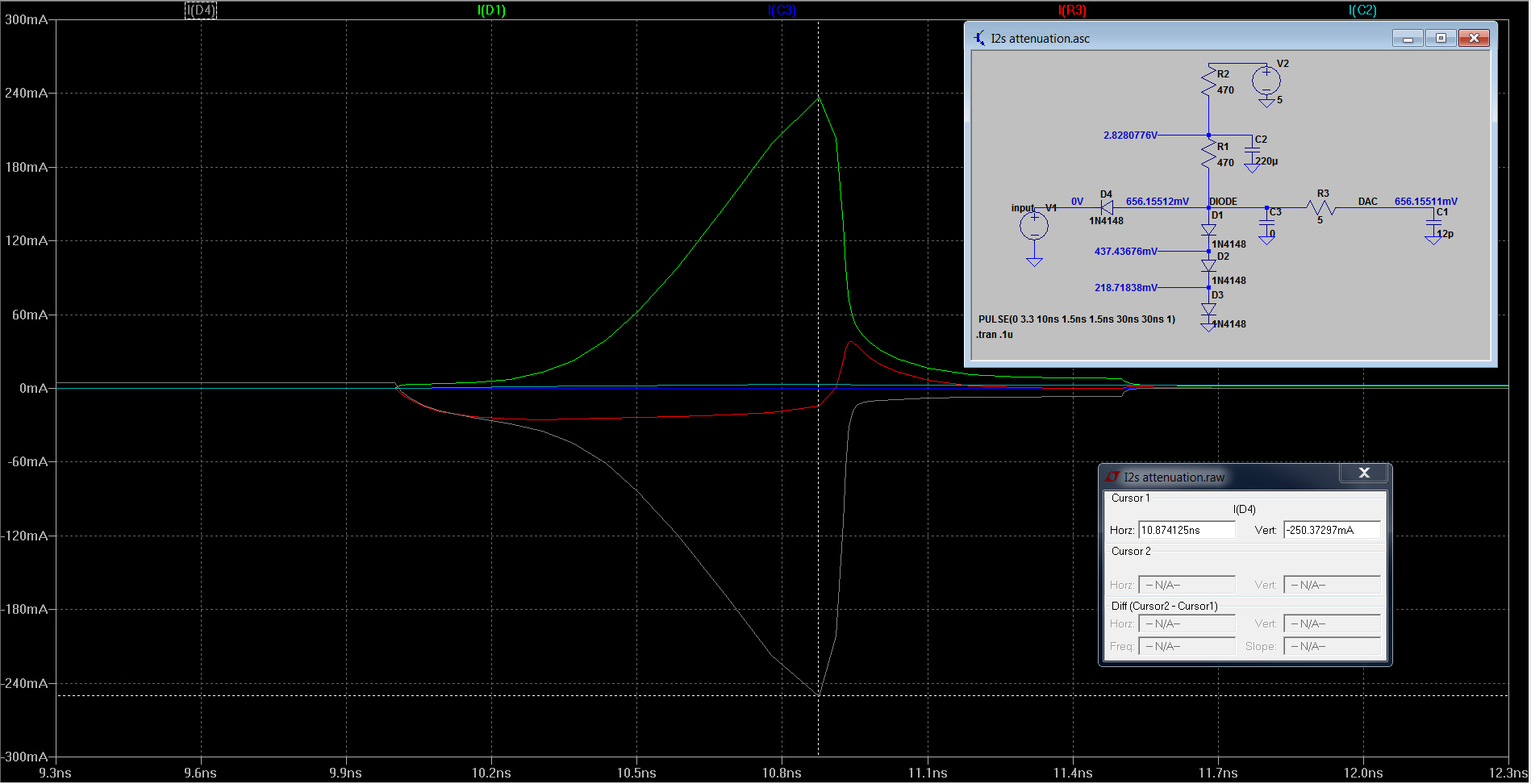

Comparison
Attached a screenshot:
Same circuit, a few different values
R1, R2 now 470R not 680R
C3 now 0pF not 22pF
If you look at the current of D4, it is close to exceeding the max recomended latch up current in the potato logic datasheet. This is why the change in values seemed necessary.
