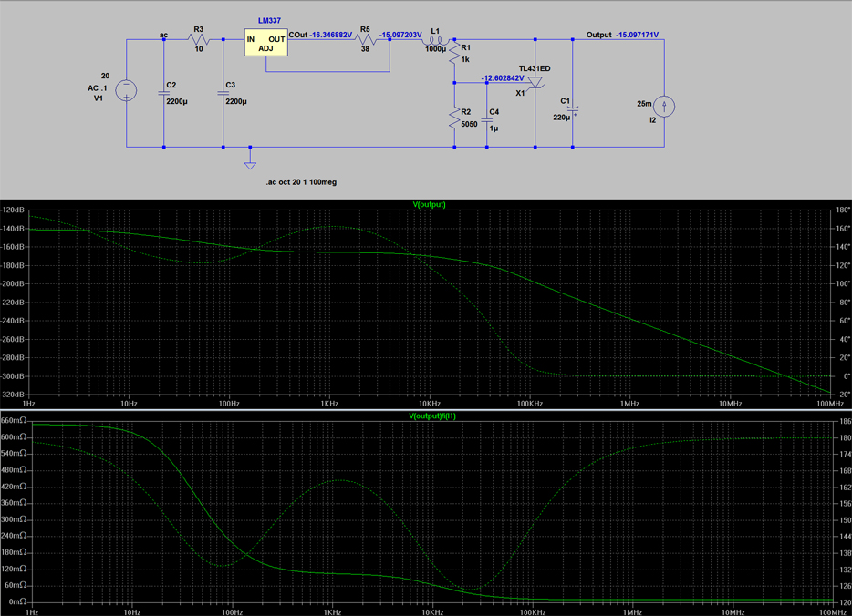

TL431 simulations
Thanks for all your inputs.
After reading much of Thorstens advice I ended up playing around with some basic shunt simulations using the TL431 and LM317/337 CCS.
Attached are some plots for output Z and noise rejection from the source (100mv). Second photo is a comparison of the impact that cap-C4 has on the performance. Results are not great for the Z out compared to salas shunts - but with the tl431 we can get it no more than 2mm away from the pins and probably the smallest current loop possible.
Current through the shunt in this config is set to about 5.5mA (80mW) - which may enable us to use a sot23 or sot89 package and get as close as possible to the pins. Sot89 may be the better option, as you can solder the anode to the pcb as a heat sink but its bigger size will make it a bit more cramped.
It may be a good idea to put only the shunt element itself on V2 (everything after L1), leaving out the other components (ccs, etc). This way people can choose their own recipe. You could even opt not to populate the shunt section at all and have it running the same as V1.

No problem Jaffrie, thanks again for your input.
I think you're right, simulations can only give you at best a ballpark figure. Ill let my ears do the final evaluation. I think the only way to test this circuit will be to place it as close as possible to the pins.
