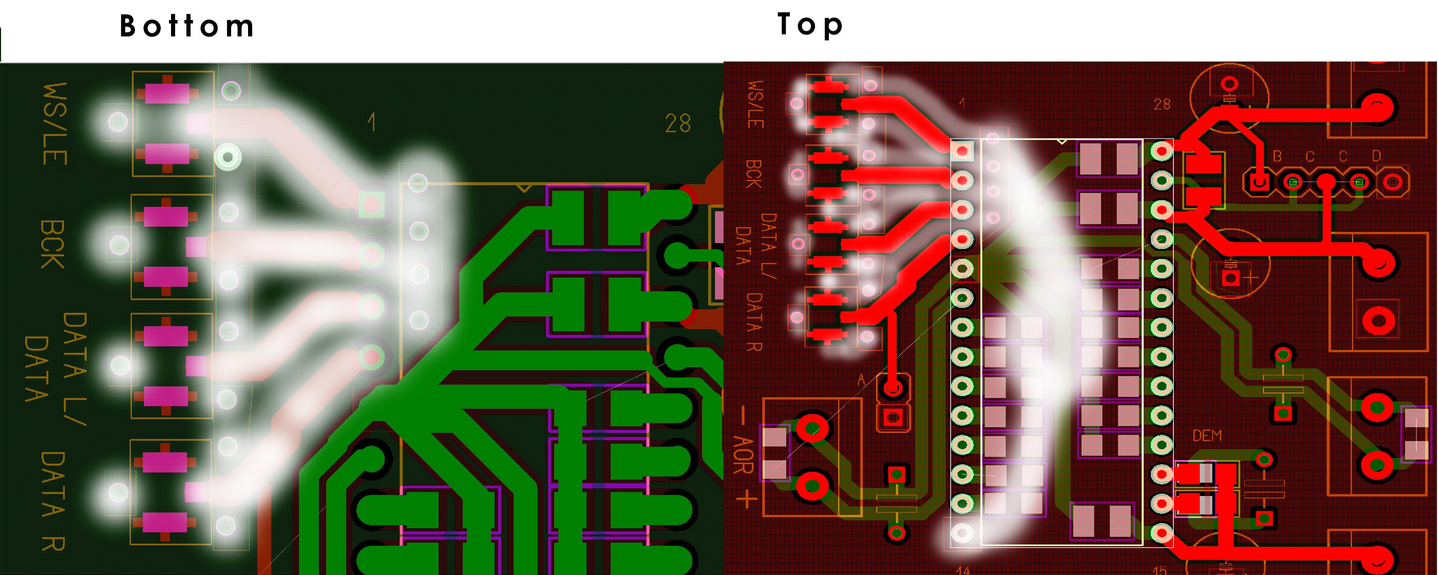

Eldham, I posted a query on the 1541A thread about not understanding your comments about the ground planes and their use as bypass capacitor return tracks - I went back to Ryan's post #303 (photos on this thread) and indeed it appears that the top plane is used as the analogue ground (including the power supplies, etc) and this layer is also connected to the pin 14, and pin 14 underneath is connected to the bottom ground layer but, I don't see any 'cross-connection' anywhere else, unless I'm missing something here.
Perhaps, on the next version of the board, there'll be a separate isolated track (thru the top layer?) between pin 14 and pin 5 to keep the bottom layer, & pin 14, separate from the from the top layer altogether and avoid any possible bypass cross current paths
[Is there a problem in actual use with the top layer tied to analogue ground (pin 5) and the bottom layer tied to the pin 14 'digital' ground? ]
On the present boards, It's relatively easy to separate the top layer from pin 14 (cut copper around pin 14 itself) and run a separate insulated copper wire from pin 14 to pin 5 - easily done.

the upper side is not clearly only analog one in my understanding as the upper plane is shared with the bottom plane at all the vias for voltage caps (ground leads of each radial caps), also the decoupling of the clocks inputs vias near DATA R path !

Okay, I see that I missed all those vias on the decoupling caps, etc - perhaps on the next board, or a prototype one, we can try to see if more separation of the upper and lower planes can be achieved so we can try tying each plane into a separate grounding point (ie pin 5 or pin 14) to see if an improvement can be achieved - it's not an immediate thing but could be included with the possible additions to the input attenuators that Ryan is working on now

Ah, my last comment on this thread hopping it helps (maybe) and not having bad words for nothing!
I didn't see it myself when the design was closed:
there are also a lot of micro vias which tie the both side ! the main (maybe) problematics ones are the four micro vias in front of the four to 4 pins for the return of digital ground : near the the pin 5 (agnd), too close maybe .
It could be (maybe) better for a future revision (and also to continue more safetly the experiments and measure on the resistive simutaneous mode) to :
- not tie the pin 5 on the upper side
- stay with the star analog ground on the botom side put tie the pin 14 to it on the bottom side :to tie digital plane(s) to this analog ground (not with pin 5 anymore : this last just see first "analog" signals)
- so the main caps vias for voltage rails could be stay as it is but with cutting their ground via on the upper side (so connected to the digital bottom only ion a v2) : the leads need the bottom side to be soldered !
-then supress (maybe) the direct // smt path of -15 V for the smt // cap which has only a direct path to pin 5 (agnd)
or : drawing path on the bottom side from the decoupling leads of main voltage caps (-/+ 5 V; -15V) to the analog star ground and just removing the upper contact of pin 5 on the upper side.
One could try also on a V2 :
-To cut in two parts the upper plane in the middle of the dac chip aera: so there will be a left upper digital side and an analog upper right side.
-On the bottom side there will be "island paths" to the ground lead of each voltage caps to the analog star ground ! Star ground will be tied on the digital upper left side an the total digital bottom side by the pin 14 via ! Of course upper pin 5 not connected to the upper left digital side !
I use to ask for smt trace for smt ferrite beads for the voltage rails, but it was "refused" !
regards

Hi guys,
Thanks James for getting this back on track.
Eldam, im going to try and explain my reasoning for the design of the layout through visual ques - i'd struggle otherwise.
In the picture attached ive drawn how i think the ground "currents" are flowing for the digital signals. Please note that this is more a state of charge than actual current flow when it comes to digital. The fast rising/falling edge of the trace signal is attracting an equal but opposite charge in the area of least impedance (directly underneath the trace - which is why i made the PCB 1.2mm think)
Eldam, from what i understand from your posts, you are worried the analog ground pin should not be connected to near the digital lines? My reasoning to connect the analog ground to the top plane was so the power supply grounds had an uninterrupted path to the analog pin, if this wasn't there they may be faced with some high impedance, creating/emmiting magnetic interferance thus noise.
I hope this is on the right track, maybe someone one out there can fill in the parts i left out.
Please understand that there are defiantly compromises in this layout - as in all designs with only 2 layers, i tried to do it in a way that would work on a 2 layer PCB.
Cheers
Cheers
