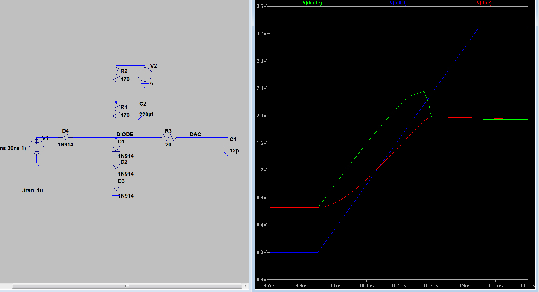

I've been playing around with LTspice. Here is what i've found, its fairly self explanatory.
Blue trace is the signal coming out of i2s to pcm PCB.
Green trace is without the 22R - R3
Red trace is with R3
The Red trace looks a lot slower but is in fact ~700ps
I think this may be worth trying.
Ryan

Looks great. This may be a dumb question.... would a small inductor on the V2 line help prevent noise from getting back into the +5v line? Or are you thinking a separate +5v source to feed attenuators on all the I2S lines?
Ill plug it in to LTspice and see what happens. Although I remember John Brown saying it may cause ringing.
And yeah, Ill end up using another +5v supply anyway, but ill test with the +5v from TDA supply for now.
Hi Audiohifi,
It’s correct but use same split pull-up desistor with decoupling cap on BCK and DATA as well.
So you need 6 resistors and 3 decoupling caps in total.
Remove the 10mH choke, it causes ringing, emits EMI / picks up EMI. Two resistors with a decoupling cap will do fine.
BTW, I have had the same experience re speakers. I expected them to be the weak link in my system and first up to be replaced. I believe its the other way around. Source first, then linestage, amps and last speakers. It just keeps getting better as the source improves. Hard to justify the cost and disruption of a big speaker overhaul.
Yeah totally agree, its really surprising. Although i did the exact opposite... opps.
I had a look at the spice model and the cap (C2) is doing a great job at absorbing the ripple - Its measuring 533nVpp. Real world may be very different though.
