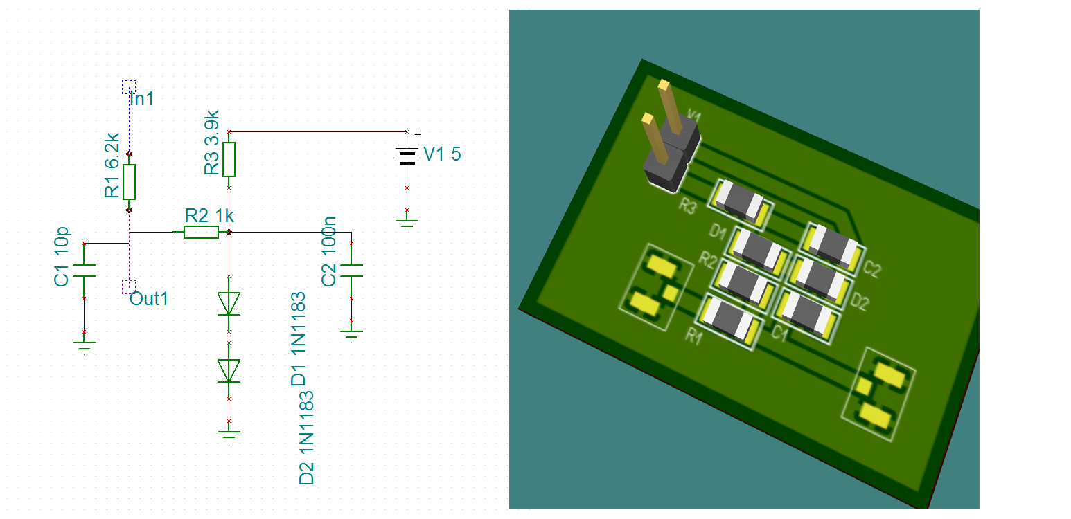

I am curious to learn the optimal value for the I2S resistors.
But the use of 22-100 ohms resistors in the I2S lines applied in other DACs, are those values specific for those DACs? Being a bit of a layman on I2S i'd expect some kind of norm for powering and load of those lines. Can somebody please explain?
Hi esgigt,
Here is a quote from "tda1541 info" thread:
With R4 = 75 ohm, time constant is only 750psec. So R4 = 1k will give a time constant of 10nsec. For R1 I propose 4k7 with 5V logic input or 3k3 with 3V logic input. This will also reduce the load of the logic. It assures also that there is always current in the diodes.
I would prefer to use this circuit three times, for DATA, BCK and WS each. This avoids data dependence of slicing levels.
regards,
Thanks Ryan, it answers a lot of questions 😎Hi esgigt,
But it also surprises me that 4k7 does not inhibit the circuit to work...

attenuator PCB
I like where you are going with this. A little attenuator brd could be an optional add to the Distinction. Would also allow us to tune the attenuation to our individual source. I too use the I2S->PCM. I am curious to see if this is why I can't get above 44.1 speed without overwhelming white noise. The guys running 384 on the tda were using the redbaron board after Ian brd which has John's attenuator circuit. I am not fussed by it as I am getting awesome sound at 44.1 which is 99% of my collection.
Heres something i think ill try this weekend if i have the parts. I think ill just try it on BCK first. Let me know if you spot any mistakes.
Cheers

PS : does the three or four inputs needs to have an equal input rise time or different rise time will create jitter... or there is no links between jitter and rise time between the emiiter and the receiver (dac chip) ?
As also attenuator must be close to the dac chip, could be better to try to putt smt resistor between the tda pins and the pcb leads ?
wire is inductive, yes... so the edges will be less steep.I believed, greater distance on a I2S line could change the rise time !
