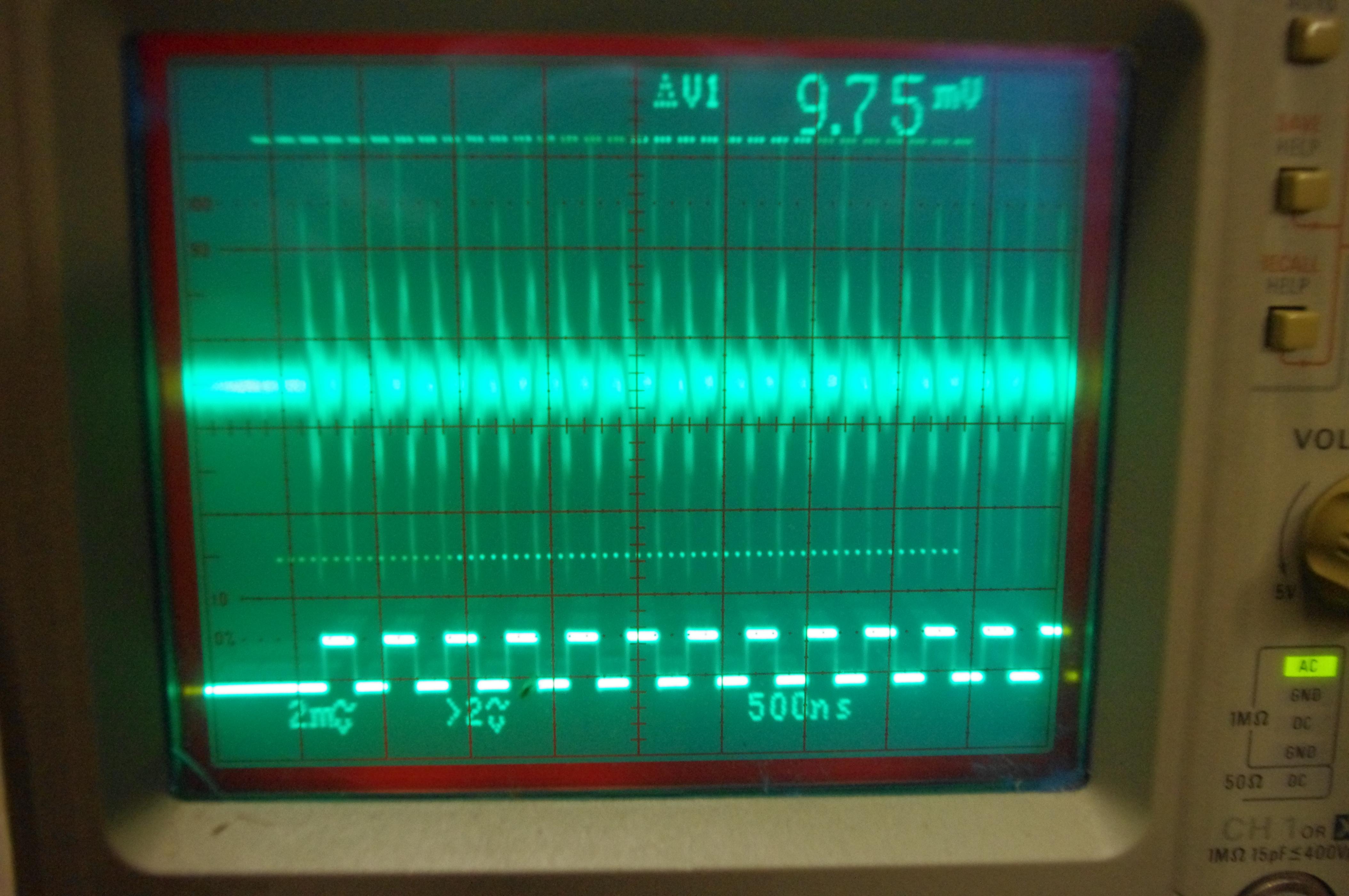

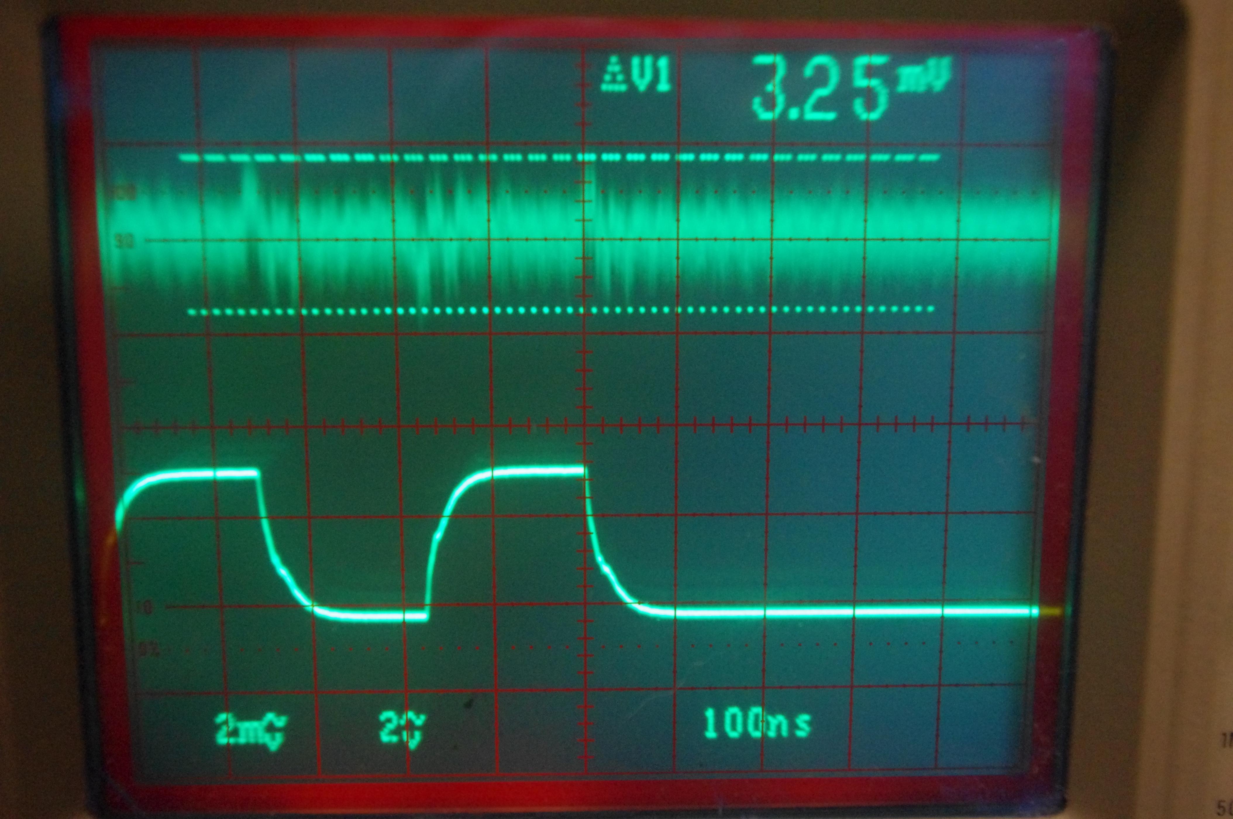

Hi Everyone,
I've built a basic pcb for testing some i2s attenuation topologies. At the moment i've got 470r in series on all lines. Rise time looks pretty high, a bit over 35ns. (from ~2ns previously)
I took a few shots, there is something that stood out a bit - noise on the -15v supply has been lowered a lot.

1541 psu bck noise 470ohm.JPG - With 470r
1541 PSU BCK noise.JPG - Before, without any series resistance.

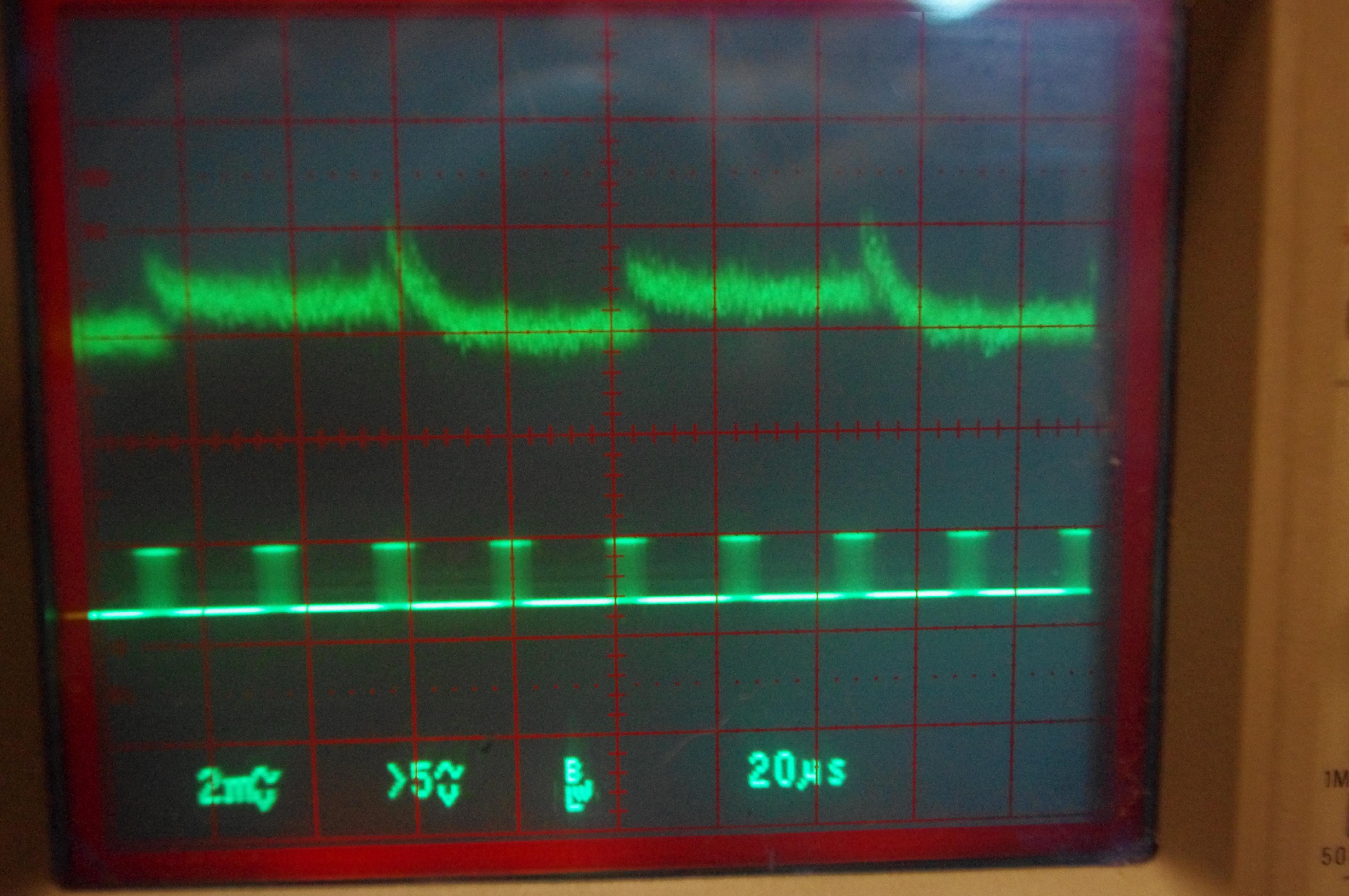

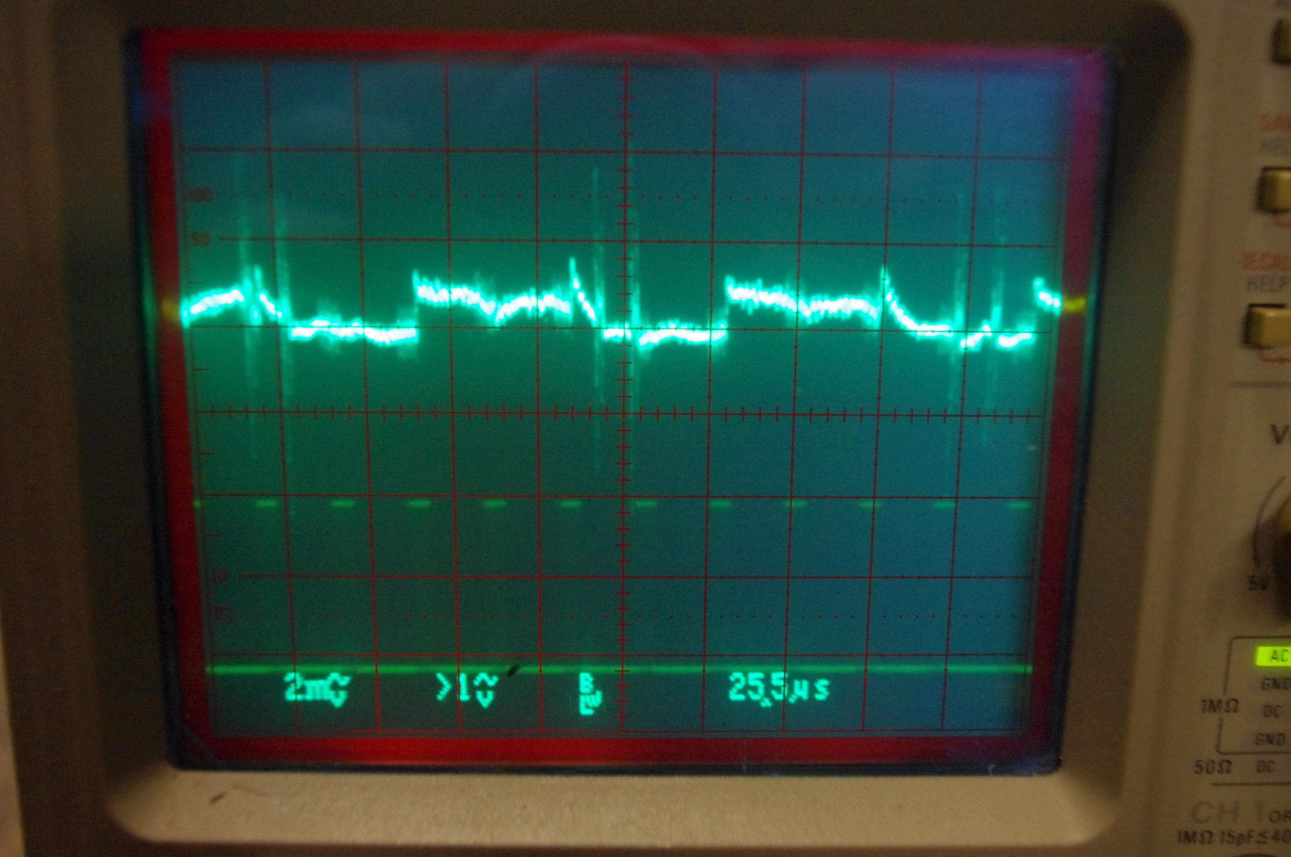

Heres a few more shots.
Output at my F5 playing 11025hz square wave -90db.
Looks a bit cleaner.
noise on F5 with 470r.JPG - with 470r
11025 F5 BCK.JPG - before, without a resistor
Wow !
What is the board in front of the chip ? A wave I/O or I2StoPCM ?
What is the max rise time the TDA accept ?
What is the difference to your ears ? Softer in the highs ?
Did you try a 1 to 4 ohms resistor in serie between the output transitor of your -15v shunt reg and its last local output decoupling cap or if any before your -15v Nichicon decoupling cap (in serie on the plug) ? Does it give you a quiet - 15 V ?

Ive got the i2s to pcm pcb. Not sure what the max rise time is, should say in the data sheet i guess.
Hard to comment on the sound because it does sound different now. And I was looking for a change, but - I'm getting more micro details. Lots of air. More experimenting needs to be done, and of course much more listening.🙂

No, haven't played with any of that yet, took me about 12 hours to get to this point today... Making a pcb (Toner transfer method), populating, testing, and measuring. Good fun though! 😀

Substantial impact.
I really enjoy seeing these experiments thru your pics. I would love to have a scope and do these experiments. Also appreciate how you jumped on this opportunity based on a curious inquiry. I look forward to implementing the results.
Walter
Hi Walter,
Yeah i think visuals are a great way for us to judge what may be going on.
It seems obvious when you look at the pictures, that there is clearly a big impact. And the fact that I could sit down with a beer after and also hear a change just confirms this. More work to be done though, was just really curious what the outcome would be.

Interresting !
If you listen to always the same material for yours experiments, the psycho effect is lowered maybe null ! I know it is boring always to listen to the same material during many years... but a fix point is needed !
More details... it's interresting and as we are not in the analog domain it's not at the price of a different tonal balance...good ! What resistor do you use ? your beautifull MILS you showed already... (the same as the 6k8) ?
Could be interresting to know the SDtrans rise time output to understand why John uses the values he gave !
CFT if you read us, did you know the rise time output of the SD trans reafder you use ? Could help maybe Tyan to choose an appropriate resistor value... I don't know if it can help ?
