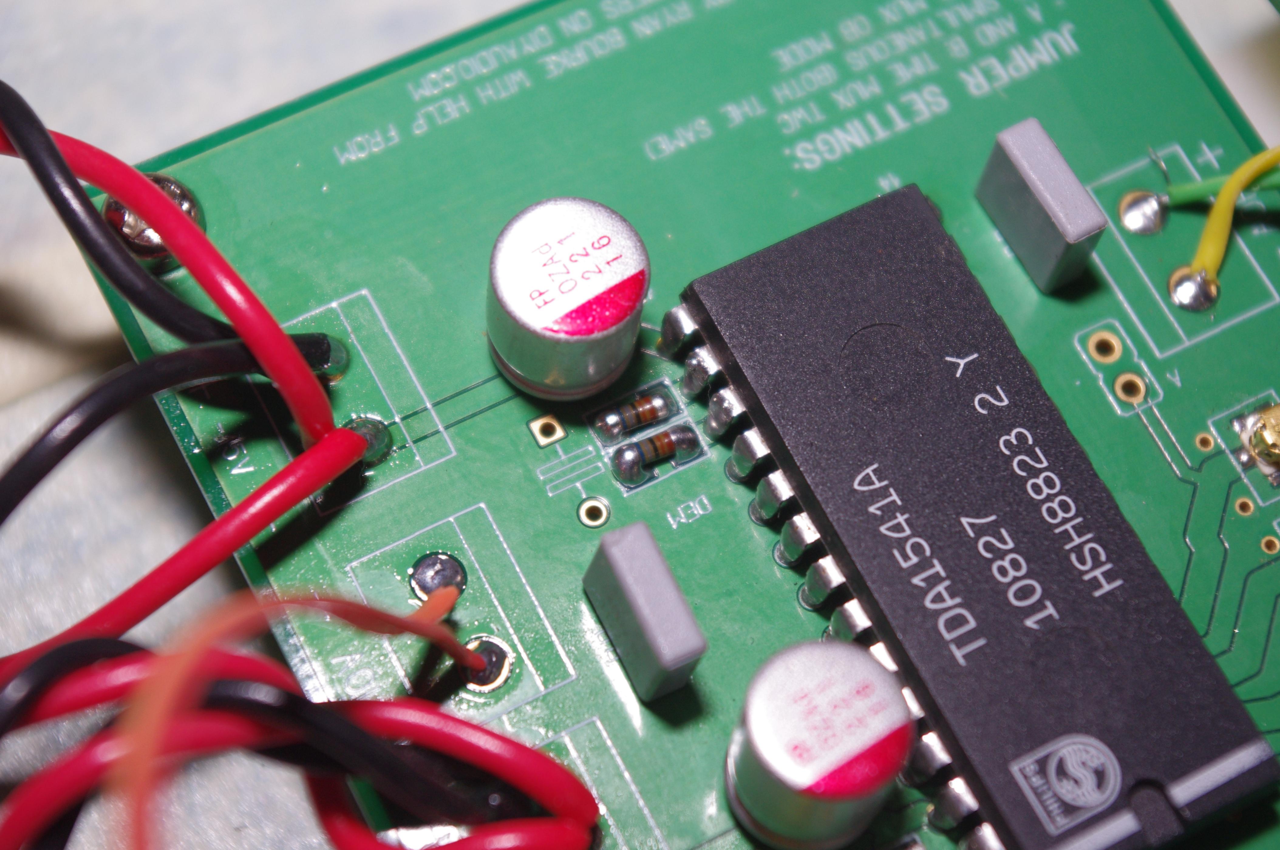

Finally got around to stuffing my Distinction-1541 PCB a few days ago. (was using prototype)
Was just waiting on these to arrive-
VISHAY BEYSCHLAG - RES, MELF, 6K8, 1%, 250MW, SMD
A bit tricky to solder with the chip and caps already soldered.

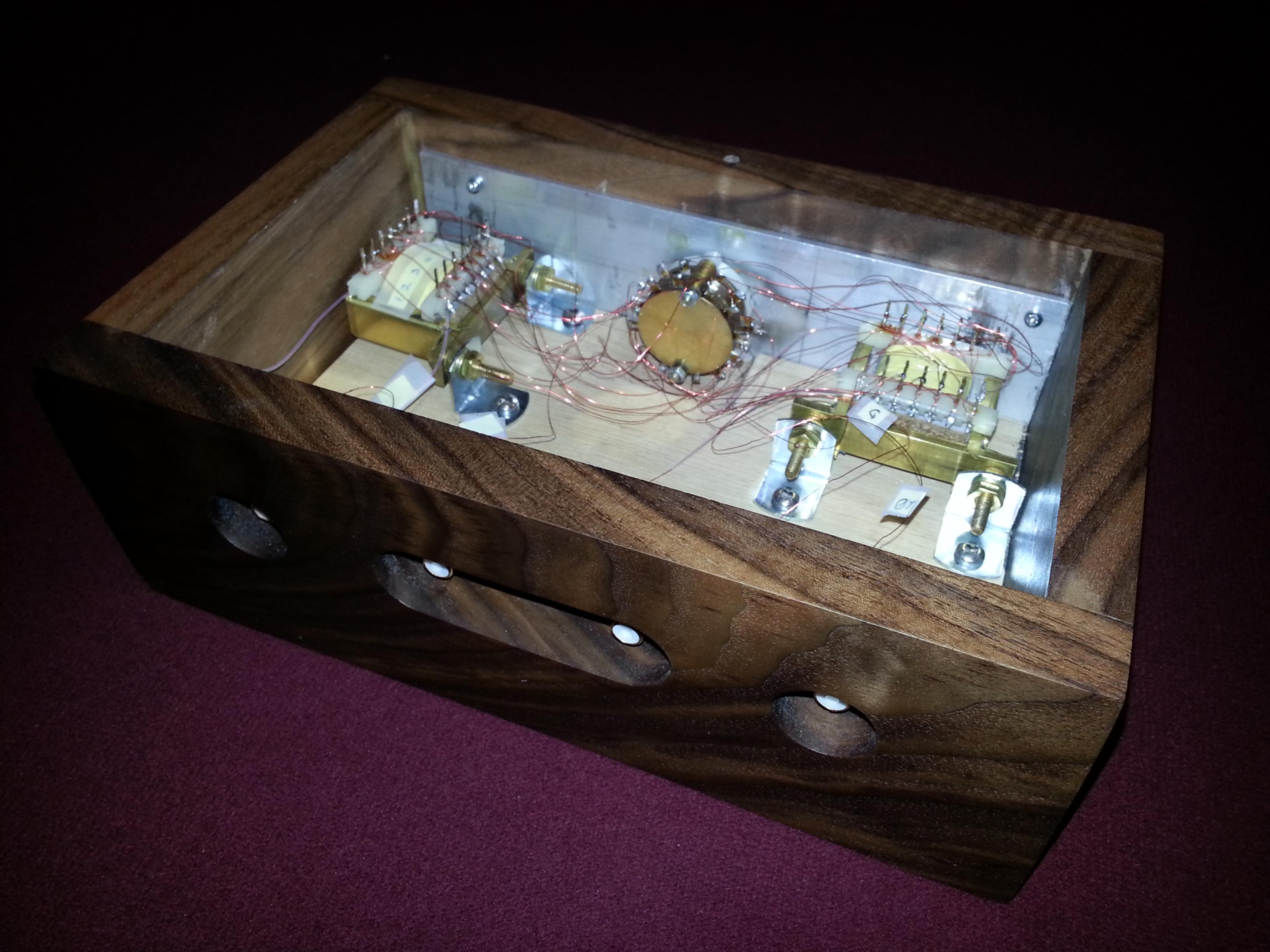

looks like to be expensive traffod reading the link given by Wolwes !
where is connected this device and traffos : between what ?
It is an Autoformer Volume Control (AVC). It replaces linestages and preamplifiers costing $10k and out performs iff your system is compatible with passive linestage. This is one reason why I use a triode output stage on Distinction feeding short interconnects to a Triode input stage monobloc. Great sound. Tiny ($250) dollars. Works for me.

Looks great!
I thought about using these R as well but went with some pretty respectable thin film. I can imagine they wanted to escape soldering!
Give it a few hrs to settle in. (I leave mine playing 7/24). Then let us know how it sounds. What did you use for decoupling caps and DEM cap?
Walter
Hi Walter,
Thanks.
Yeah I've got a few new caps and resistors in there, I should go put it on and leave it on for a while- give it all time to settle in.
Yeah it certainly wanted to roll around a bit... good lighting, pointy tweezers and a pointed soldering tip did the trick.
The filter caps are 1uF film, and i managed to fit 2uF (2 x 1uF) on the MSBs - One on top of the other. Im keen on experimenting with a low DEM speed, so this should cover me for as low as 60kHz. Not sure ill go that low though, 100k sounds like a good number.
DEM cap at the moment is just a ceramic 470pF i had lying around (1206 size) Ive got some decent panasonic film caps coming soon - a few different values. (260pF - 1nF, 805 package)

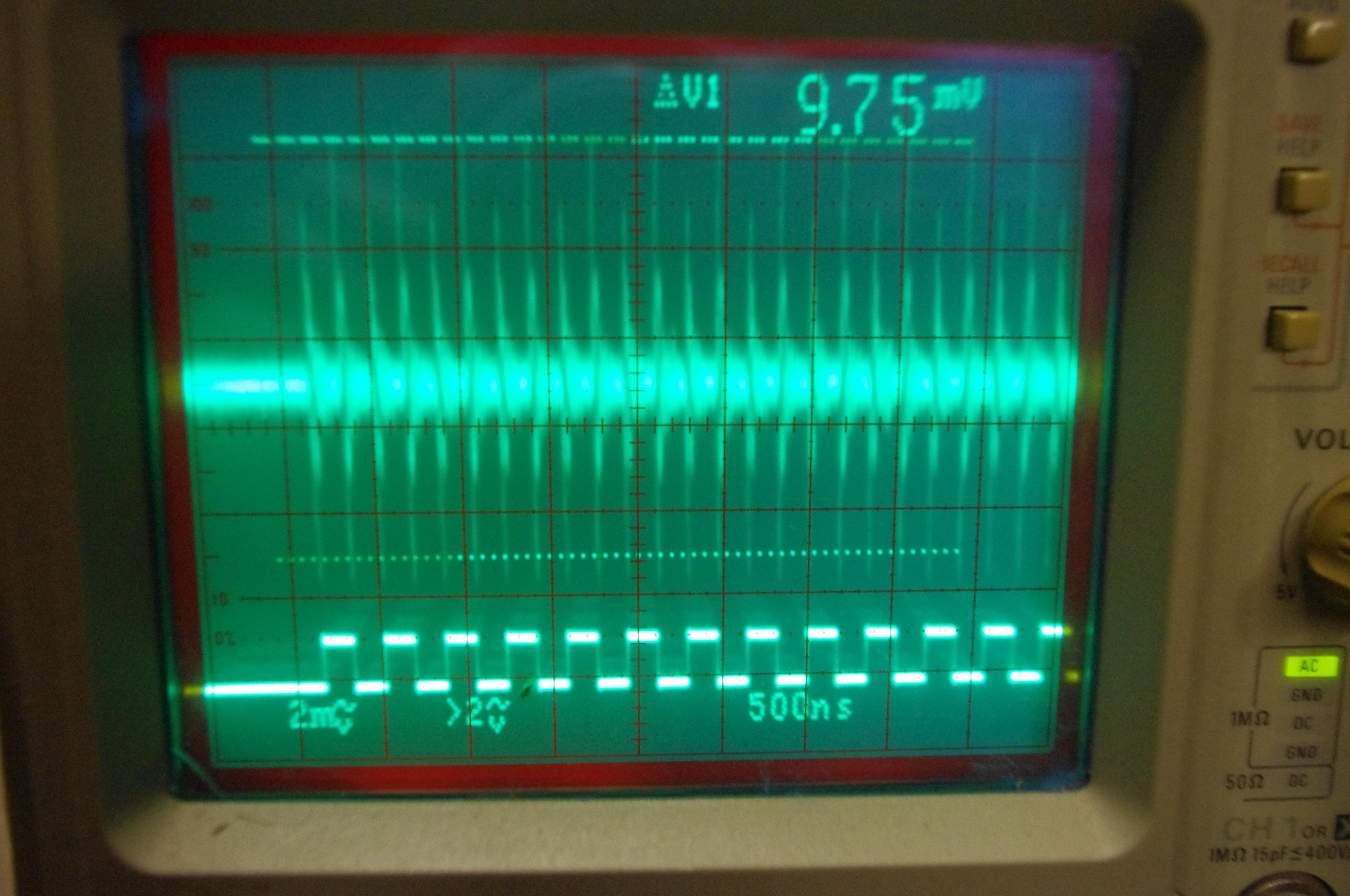

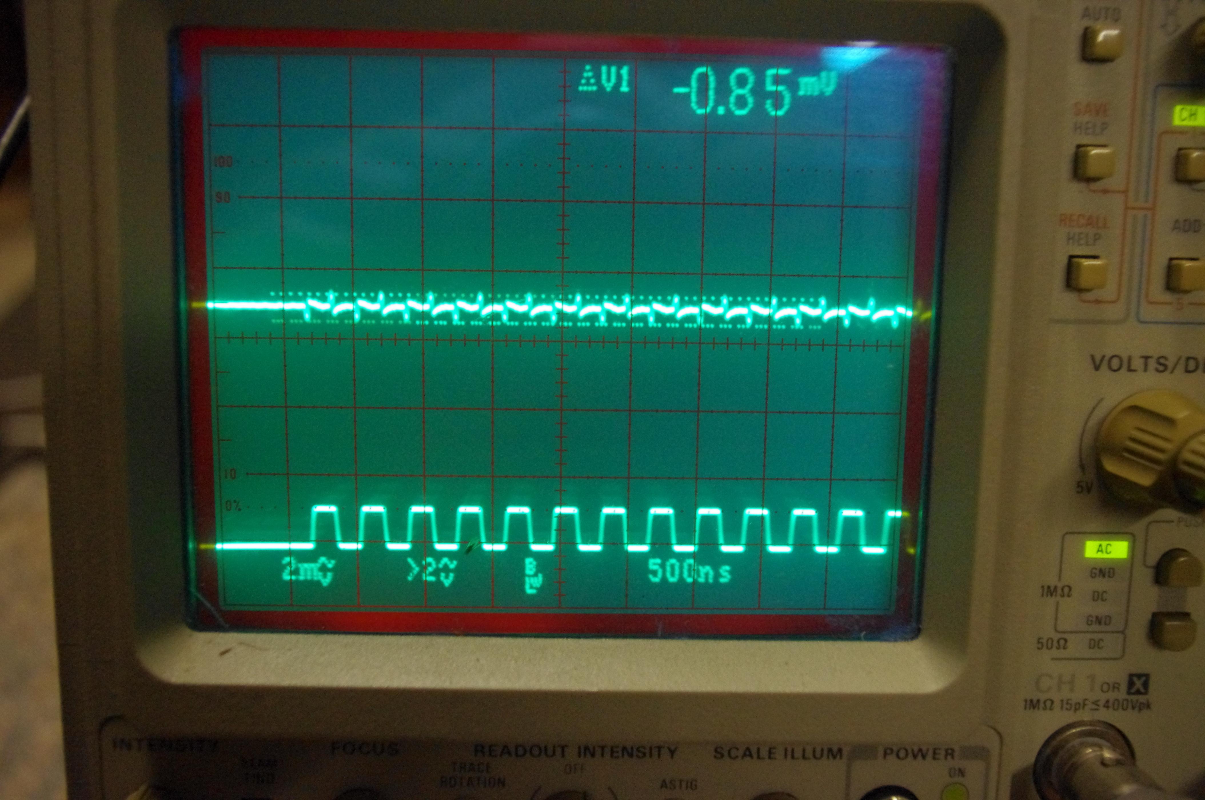

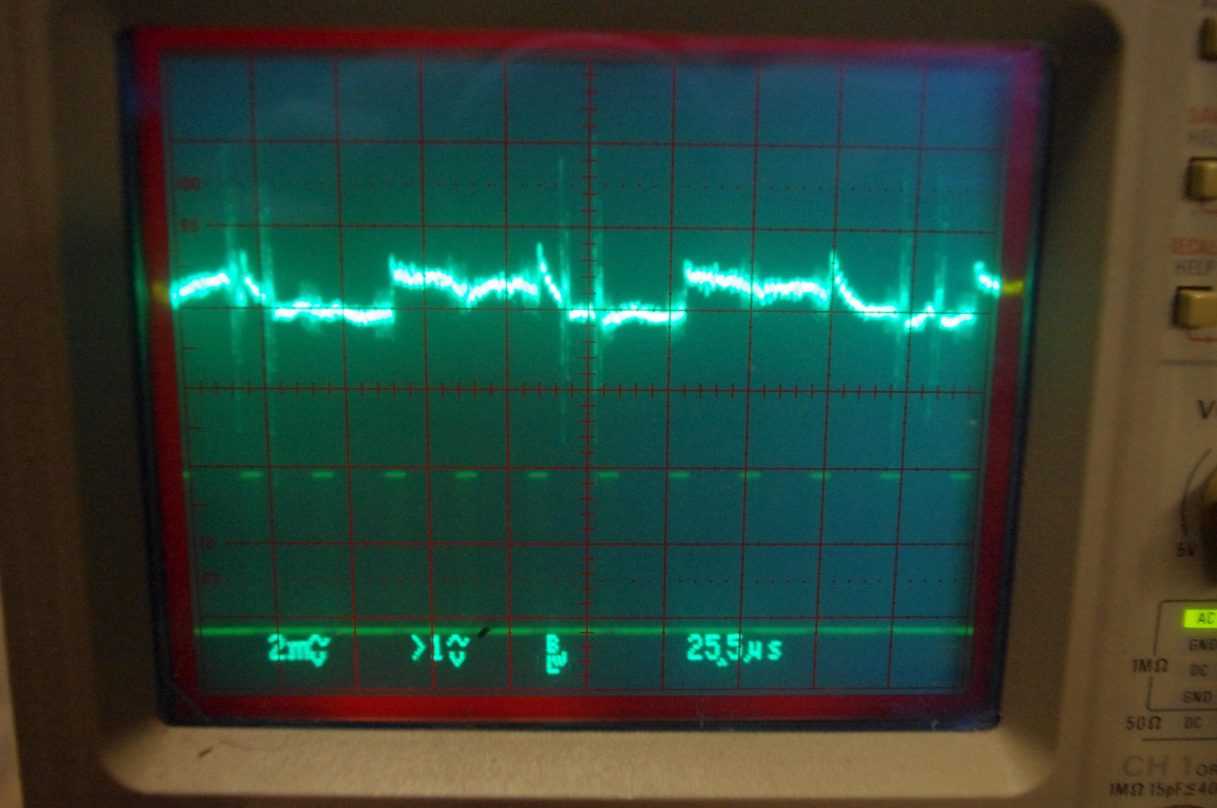

BCK noise scope shots.
Just wanted to share a couple of shots i took tonight.
BCK is shown on the bottom trace in all pictures.
-Noise on -15V supply to 1541A Bandwidth limited (20Mhz).
-Square wave 11025Hz -90dB @F5 power amp with -1.5dB attenuation. Bandwidth limited.
Seems BCK shows up nearly everywhere. Maybe its doing more damage than I thought. I wonder how much deterministic jitter its really causing in the chip. 😕
