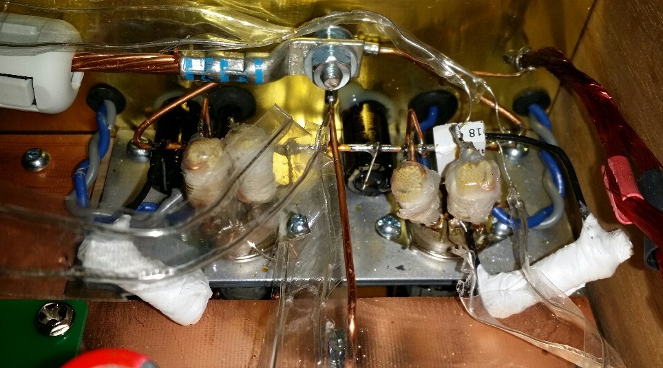

I replaced the 220r cathode resistors in the output amplifier. All I can say is WOW! As it was in tuning my amps, upgrading the resistors in the signal path is the single biggest impact. Even more important this early in the signal chain. As good as it was before, this simple upgrade was like the difference between foggy glass and no glass at all in the window. Everything clearer and more dramatic. Particularly important in the higher registers. Bells and cymbals shimmer forever. Air around everything.
Anyone building this circuit is well advised to skip the experiment and go straight to best possible resistors in all 3 positions. Naked foil would be the minimum.
In the pic, the 2 larger white blobs are my I/V resistors built some time ago. The 4 vertical blobs are the new cathode resistors. Basically a piece of bamboo wood with copper wire on each end.. double sided tape around the wood, and Manganin wire bifilar wrapped on the tape and soldered onto the copper leadout. The soldering the wire is the tricky part as it is almost impossible to see even with a magnifying glass. Mostly these things are build by sense of touch! Or just buy the Rhopoint!

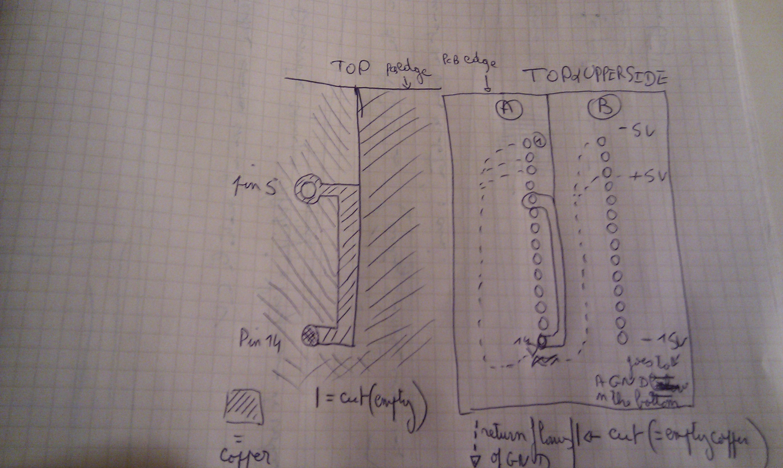

Hi Eldam,
This schematic might help a bit (attached), you can see that the analog ground pin goes straight to the binary weighted current network. Im pretty sure the return currents for pin 1- 4 will not take this path... as far as my logic can tell.
I wouldn't cut the top plane to pin 5, the power supply return currents will most likely take this path. But don't let me stop you trying. 🙂
Pin 1-4 return currents path should be as follows (from my understanding):
Through the vias around the ufl pads.
Then directly under the trace.
Back up through the vias near pins 1-4.
Under the chip to pin 14.
I think the highest impedance path the currents will encounter will be from the center of the chip to pin 14. (on the top plane, and inside the chip).

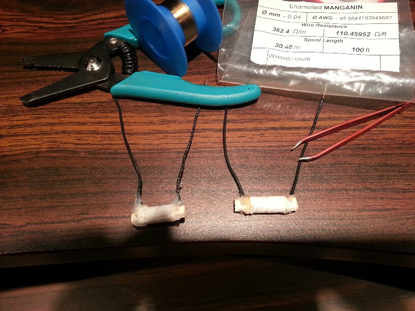

Hi Drew
I will post a couple of pics later to help the description. Attached pic was from making the I/V some time ago. You can see the Manganin wire is 110 ohms per foot, so you first calculate the length of wire required for the required resistance. then I remove the enamel from each end by dipping it in a blob of hot solder. Then measure resistance. This stuff is like a very fine piece of human hair so use good tweezers and expect a little trouble seeing. I build the resistor base by taking a small piece of wood (1cm of chop stick) and drill tiny hole in each end. Thread lead out copper wire (24gauge) thru each hole and twist it to be secure on the end of the wood. I then solder the wire where it meets the wood. This further secures it and will be the point where the Manganin attaches to the lead out.
Then wrap double sided sticky tape around the wood. This is the base on which you wrap the wire. Fold the wire in half and start by attaching the center fold of the wireonto the sticky tape and then while holding both pieces of wire between thumb and finger of one hand slowly and carefully twist the resistor with the other hand until the two leads of wire are about 2 cm from the end. This forms a bifilar winding to reduce inductance. In low values like the 60R IV, I doubt there is much problem with 6inches of wire. You can read about low inductance winding on Wiki. I chose bifilar as it is easy and this wire is thin.
Now the truly tricky part. It helps to have a stand with magnifying glass to hold the resistor. you have to carefully attach the wire to the lead out. I find a Q tip with flux on it is the ticket. with the Qtip, tease the wire onto the solder blob. The flux will cause it to stick. Then carefully touch it with a hot iron. with luck the wire is soldered onto the copper lead out. After completing both ends measure resistance. If you have succeeded in attaching the manganin, the proper resistance is achieved. If not an open circuit and you try again.
you want to now ensure there is no movement of the lead out wires at the wood. I use a blob of glue. You also need to be careful not to stress the joint when positioning the resistor, or to reheat the joint. Proper use of plyers to bend the lead out eliminates stress, and then when soldering the leadout to the tub pins hold the lead out with plyers when you touch the soldering iron. The plyers will stop the heat from travelling up the wire to potentially disconnect the manganin.
It sounds like a lot, but the wire is not expensive, and a resistor can be made in 30 mins. They are instantly more transparent, but like everything, I think take a few hours of burnin to fully bloom.

Thanks Ryan,
I didn't say I want to isolate pin 5 from the upper plane and pin 5 from 14 but isolate pin5 from its near environment (other close vias) by tracing an island to pin 14 (to drive the flow and avoid the other curents 5 V and pin 1 to 4 to return to this pin 5 "before" the pin 14 (as they are tied in each case).
But if you tell me those return currents will see in fact only pin 14... it's ok like it is 🙂. In my mind I believed the return path of those currents drop to the nearest GND pin (as AGND & DGND are tied...). If they know the good path themselves everything is right. I'm not aware about continuous DGND plane with multiple connection to AGND and how it's work really....

Hey Eldam,
Sorry I misunderstood you.
Ahh, so you mean like a slot in the ground plan to further isolate the analog ground? Thats something that should be looked at further.
After I heard the current design "sound" i was a little nervous to change things too much... "If it ain't broke don't fix it..."
But yeah i see what you mean. All that RF noise so close to the analog ground can't be a good thing.
Maybe a 4 layer PCB is in order...

@ Ryan,
I've done a picture though I didn't want to draw it ! On the picture there is twice the same idea but the left shematic is focused (zoom !).
You see pin 5 is always tied to the plane but on the pin 14 directly via the island and not anymore around itself only by the continuous ground plane . The island is just made by separating it of the upper plane with a scalpel by removing the copper (around the island to draw the path to pin 14) but on the pin 14 of course (as we need to keep them tied: the island touch the upper side of pin 14). Obliquely traces is conductive copper on the picture. Notice also the cut trace from the "island" drawed to the upper edge of the pcb (idem : just a scalpel cut from an edge trace -empty copper- of the "island" to the upper physical edge of the board).
BTW, it's not shown but the cutted trace which start from the pin 5 island to the upper edge of the pcb must be placed between pin 1 to 4 hole chip pins and the three vias holes you added on the board just in front of them as you described already (out path of the return DGND current of pin 1 to 3 (4? is there 4 vias holes ?) to go out on the middle of the plane to flow under the body of the dac chip to pin 14 as you explained!
I'm totaly confused 😱, hope my drawing skill is not worst than my english for your understanding !
Certainly a too naive vision of me (coming from the phrase of T. Loesch : "you must see where the current flows"!) and this story of impedance you talked about is more serious... and we certainly need instruments of simulation with tools we have not to have a valid answer (Marce member : ... mayday 😉).
I hope with the picture one understand the goal is to isolate more (to move away) AGND pin 5 from the too much close pins 1 to 4 and pins 28 & 26 : digital +/- 5 V. To alow the return path Gnd current of pin 1 to 4 and pins 28 & 26 to meet faster pin 14 and just after in second pin 5 but via the island path... With high speed RF, maybe it's important, I just don't know !
Notice also, as the pin 5 is isolated from the close pin 4 : one can add an external MCLK (I asked two vias hole for that : remember ! And they are present). In this scenario : the via hole of the gnd of this clock (near the hole on pin 4 path) is closest to pin 14 as well (instead of pin 5)
regards.
