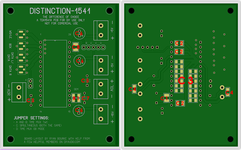

Here attached is a parts guide to the Distinction PCB as promised.
These values are the ones i am currently using and are by no means the only values that can be used. For example if you decrease C1 to 260pF, you can decrease C3 caps to 330nF (rough estimate) and then use a 1206 sized cap.
C1 470pF
C2 1uF cornell dublier stacked film
C3 1uF cornell dublier stacked film in a 1210 package soldered on sideways (1206 footprint)
C4 and C5 (Two options -smd or through hole) are the analog output filter caps. At the moment ive just put in 4.7nF Vishay films and it seems to clean up the highs quite nicely.
C6 100uF Nichicon FP. But the ones Eldam suggested will be going in soon. (Panasonic LE caps)
C7 is a through hole option to C1. Or you can connect your own DEM circuit here.
R1 Carbon film 6k8. Those MELF resistors may be a good option here.
Hope this helps.
For me it could be :
C1 : smt silvered MICA (John's input in him thread)
or if C7 instead: Wima radial FKP2 (in 5 mm pitch leg) or radial silvered mica (minimum voltage advised to avoid the largest pitch between legs the high voltages refs have !).
C2 : 3 choices : acrylic from Cornel Dublier or PPS (take care of the size, check the size on the datasheet) : 1 uf. Or 0603 case size, 0.1 uF ceramic class I: COG/NPO ( ceramic class 2 not advised); advised only in the goal for C6 decoupling. Or: empty.
Best to test C6 with C2 empty; then C2 with 1 uF and after C2 with 0.1 uF COG : take your time, check with listening with C6 already choosed. Not really advised to stack the 0.1 on the 1 uF if you have the idea to do it...
C6: depend on the PS : if shunt regs: 1 uF could be enough : Wima FKS2 : 2.5 mm pitch (seems to make the difference with the 5 mm pitch elswhere ?!) or discontinued OSCON SP (with higher capacitance values in this case !)
with linear regs : for the -/+ 5 V rails. One should try : discontinued Black Gate (47 uF minimum); OSCON SP (6.3 V >470 uf are the ones I prefer); Nichicon PLE (6.3 V /470 uF); UCC: polymer PSA serie: 470 uF (the smallest form: 470 uF) ; Panasonic: polymer SEP serie: 470 uF (not SEPC or SEPF !). IMHO from the best to the less best (depend on your hifi system and personal tastes).
Notice than the Nichicon PLE does not exist for the voltage higher than 6.3 V, so notr for the -15V rail !
R1 : MELF first ! (or, second choice) : Sussumu smd thin film resistor (RD low noise?)/ Vishays low noise... I have a doubt (but don't know!) about carbon because noise and precision ! No problem to pair/match exactly the same values for th etwo résistors. with smd MELF, smd Sussumu.
Could be funny also to putt those biggest cap on the AO vias (with a wire at each pins for outside connections), in this case the vias and smt pads have to be populated for decoupling : 1 uF MKS2 (2.5 mm pitch) or the acrylic/pps smd ! Why this strange idea... for a reason i don't understand (I'm not technician) when several boards and PS, putting a cap at the edge of the pcbs is advised (if someone could explain why or if I'm wrong: thanks in advance).
Or Whatever you like/prefer in relation to your system !
During chosing test : advised to avoid soldering for the radial capacitors (just take care to have shor legs enough to avoid shorts below the pcb ! always switch off before changing caps : Bah you know it already, but good to repeat it... TDA1541 chips are rare !).
For I2S inputs :
uf-l wires, no more than 10 cm (the less the best) as said in the "Any good TDA1541 kit enough" where this pcb was born !
or thin 50 ohms individual coax cables (shielding is the Gnd) if uf-l connectors are not choosed (but vias are very microscopics... so!).
I/V resistor : Through hole Rhopoint Econistor seems one of the best choice : Thorsten, John advice to it ! (less sterile than a TI Z foil) (sourcable at Rhopoint or Farnell easily) : value dépends on your design of course (your choice) !

Ryan, I don't remember : is there in the bottom plane some plane ground ( but the analog Gnd one I mean) tied to the upper side digital ground ?
Analog Gnd just (only) tied to digital Gnd by the upper side of the pin 5 vias ?
Hi Eldam,
On the Distinction-1541 pcb, the digital and analog grounds are both connected to the top plane. Digital ground is also connected to the bottom plane.

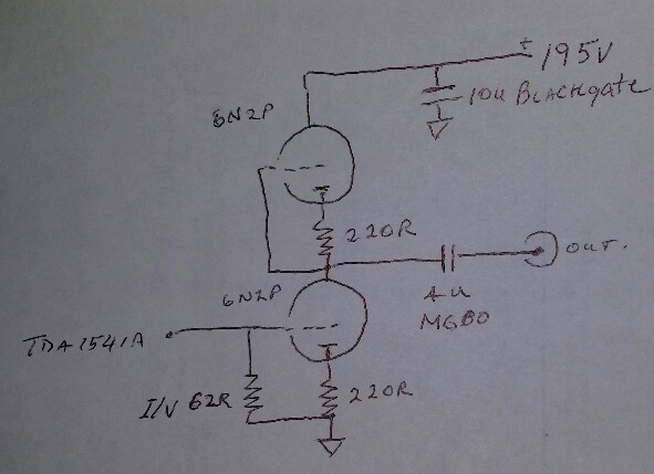

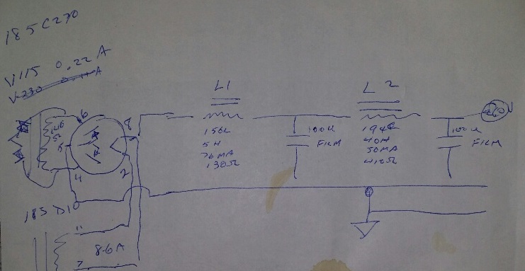

Sorry for late reply..
I have used Lampizator tube output now on several CD players and my previous DAC. This is just a cleaner build of the same using better parts and for first time his best PS. Below are pics of circuit diagram. I believe he credits the tube amplifier design, (he claims it is not a buffer) to his friend and mentor at ARG amplifiers(Ewgenniy Kreminsky).
I do not follow all his advice. I use an I/V resistor of 60R. Best quality here is high payback. I tried many different resistors and hand wound Manganin wire used here. Alternative would be Rhopoint.
For cathode resistors I used NOS AudioNote Tants. The whole thing is sounding good, but I am itching to hear it with more DIY Manganin. I have build the resistors and will install them asap.
The coupling cap is Russian MGBO-2 4u. It is great value. Clear upgrade would be Duelund RS.
On PS, I use all Hammand iron for trans and chokes. Values are mentioned. I use separate trans for each channel and wire for 115v output. My B+ measures 195v. The film caps are 100u 400V polyprop caps used for solar panels. I like the convenient square shape. First caps after diode is 2u Obligato PIO I had left over. If I did it again I might build 2u, 50u then 100u.
The Diodes are Russian 5C3S.
The other important thing is star ground is close to tube output.
