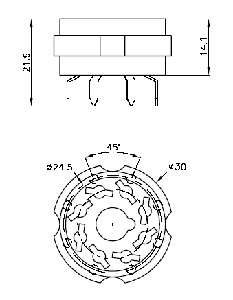

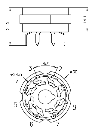

Made a quick drawing of the Octal tube socket I have.
The diameter of 24.5mm is the pitch diameter for the holes in the PCB. Tolerance for al dimensions is ±0.15. I hope this get's you started for an overall setup of the PCB.😉

Thanks for the picture, can you get some measurements to Al so he can continue with the board design?

GeWa-
Thank you for the pictures!
