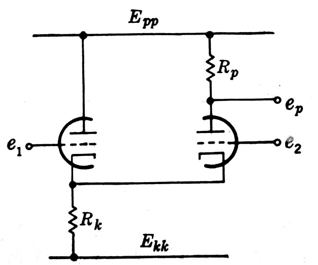

Figure from "Vacuum Tube Amplifiers", by Valley and Wallman, MIT Labs, 1948, a definitive book on basic circuits.
Second figure under the section called "Differential Amplifiers". There are dozens of vacuum tube op amp designs with similar input diff amps.

It doesn't matter how it's drawn, it's still a diff amp.
It is my belief that we ought to dig up more of the old tube op amp circuits ideas from the past for use in audio. By definition, they were DC coupled circuits. Many used clever level-shifting circuits to drop DC voltages with little signal loss. However, they all needed feedback to work correctly and that will scare off some folks, but then so will this design being discussed. I personally think Rosenblitz's design looks very good (haven't heard it though); I just wouldn't have given it that name.
