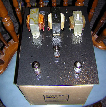

I use NOS Tung-Sols in V-1 and 2 and NOS Telefunken in V-3. That has been the best sounding combination with my KSA-50 Clone driving Dynaudios. This is the best line stage I've ever used period. Cost for me to build was about 85.00 including the NOS tubez. One can keep the transfromer costs down to about 6.00 each by using cheap isolation type trannys for the HV rails. The one below now sits in a nice quarter sawn oak base.....
