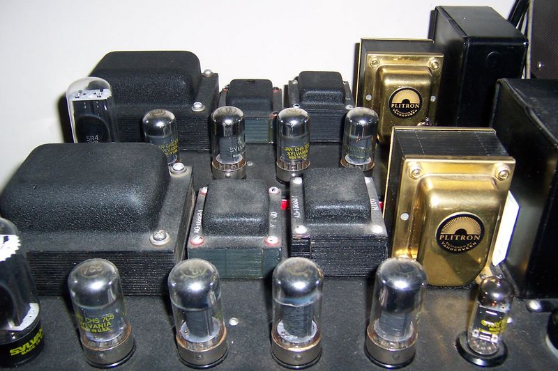

Your friends system- Pro Ac 2.5 Response. I use modified Pro Ac 2.5s. The tweeter was changed to a Seas T25 Excel with new crossovers. Crossovers are detailed off of the model 'Ella 1'.
The difference is substantial in the mids & highs. The tweeters cross at 2kHz. I do not recommend more that 40-watts at 2K.
My power amps are DIY PPP triode 6V6GT monoblocks with MQ iron. They play as well as an almost identical PP 45 tube monoblocks I built for another audiophile. Quite surprising, indeed.

PPP 6V6GT monoblocks
These are fashoned off of the 'poinz' design. I needed more power thus used parallel push-pull 6V6 (actually a 7C5). A 7C5 is a loctal based 6V6 & usually available in match sets of 8 due to low demand. Also, NOS is only $5 each. I replaced the 'poinz' design 5965 phase splitter with a Raytheon 6CG7. Being lower gain, the redesign needs a preamp with the 6CG7.
For some reason, the Raytheon (real Ray with black plates, not Japan manu) is the only 6CG7 that performs excellent sonically. If Raytheon were not available, I would use a Sylvania 6SN7GT or VT-231 with T type plates. The PS is an LCLC to the 6V6 & another LC for the 6CG7 B+. The 6CG7 is 'floated' up with a -140 supply at the cathode. The PS uses an oil cap at the last position in the LCLC & a Solen poly cap at the last position of the additional LC.
The audio trannys are MQ ST70 replacements but using the 4 ohm tap on 6 ohm speakers. My speakers measure closer to six ohms vs 8 ohms. The reflected impedance to the 6V6s are about 6K. If one builds this amp, use nothing less than 6K PP primary. This higher plate impedance just opens up the triode connected 6V6s to another world sonically. I also use 330 volts B+ on the 6V6 plates or 30 volts over spec. No issues to date. The 6V6s are hard bias with -25 volts.
The amp is a great performer & as good as a pair of PP 45s I built on the same chassis with top of line MQ pinstripe audio iron. That 'as good as PP 45s' should not be, but the 6V6 triode amp is just a freak performer. NOS 45s cost $100 each & NOS 7C5s cost $5 each.
