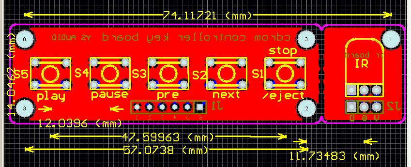

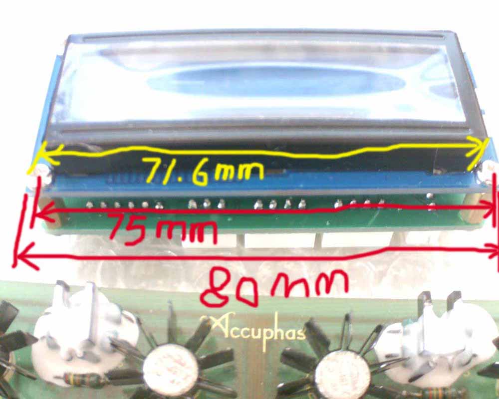

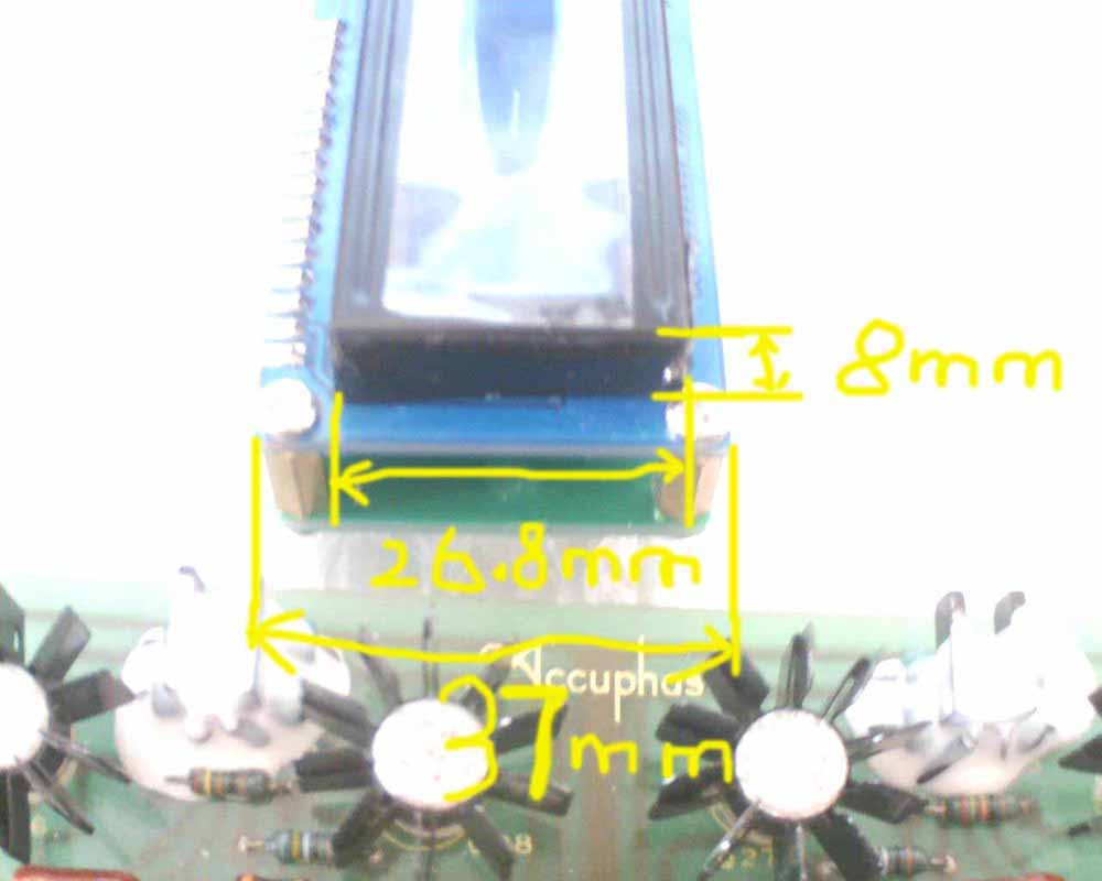

bm0rg said:Hi, Lu
Ive sent payment for 1 kit. Couldn't bother you for the dimensions of the boards and LCD so that I can get started on the chassis 😉
Thanks!
Hi bm0rg, thanks for your ordering.
Here I add some pictures to describe the dimensions for the controller board for you.
80MM/75MM/71.6MM
