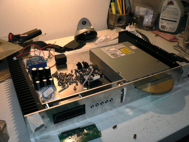

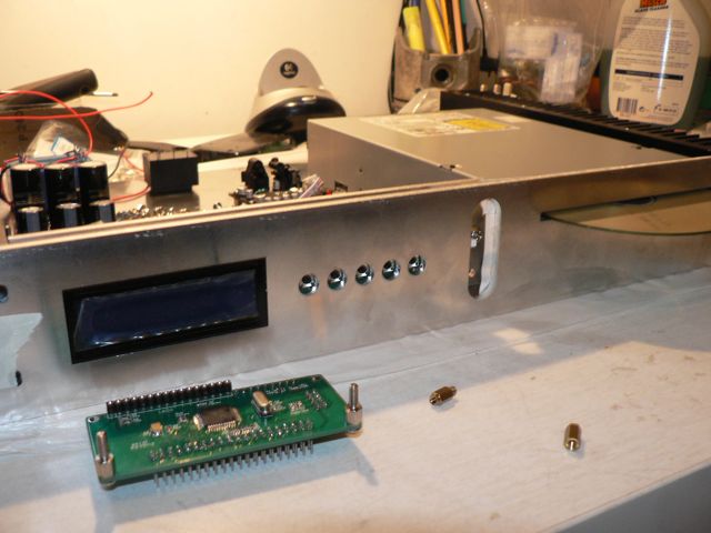

Having received kit a while ago the aluminum for the chassis arrived today! I thought you guys might like to have a look 😉. Its only in its very bare state at the minute. I plan to have the ali plates bead blasted to fit in with my amp 😀 So here are two pics for you.

can you tell us exactly how you are doing the buttons, part nubmers etc and what way you mounted the PCB behind the fascia...

Hi Vidalgo
Yer the heatsinks on this are just to make the walls! they are the 50mm versions of the 100mm i used for my amp, so purely a design thing. Oh and the voltage regulators and bridge rectifiers will be mounted on them, not that need anything like 0.5 k/w thermal resistant heatsinks. Part number for those is SK56 made by fischer elektonik. not easy to get hold unless you have an account with the uk supplier 😉
Hi Woodturner-fran
The for the control buttons I will turn some from ali rod on a centre lathe. The button will have a shoulder on it to stop it falling out the front.
The PCBs are mounted on to a vertical plate of ali using standard pcb pillars that i got from rapid electronics.
http://www.rapidonline.com/Tools-Fasteners-Production-Equipment/Fasteners-Fixings/Fixings-PCB-Pillars/Hexagonal-male-to-female-spacers-brass/64767
I'll try an submit some more images latter if you'd like
