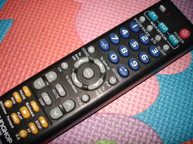

Hi fredlock, the controller is the same as one I post before, but the remote changed to a big UNIVERAL remote handset. With this remote handset, you can even control other audio/TV sets
Total price is 30 USD, airmail shipped
regards
Lu
