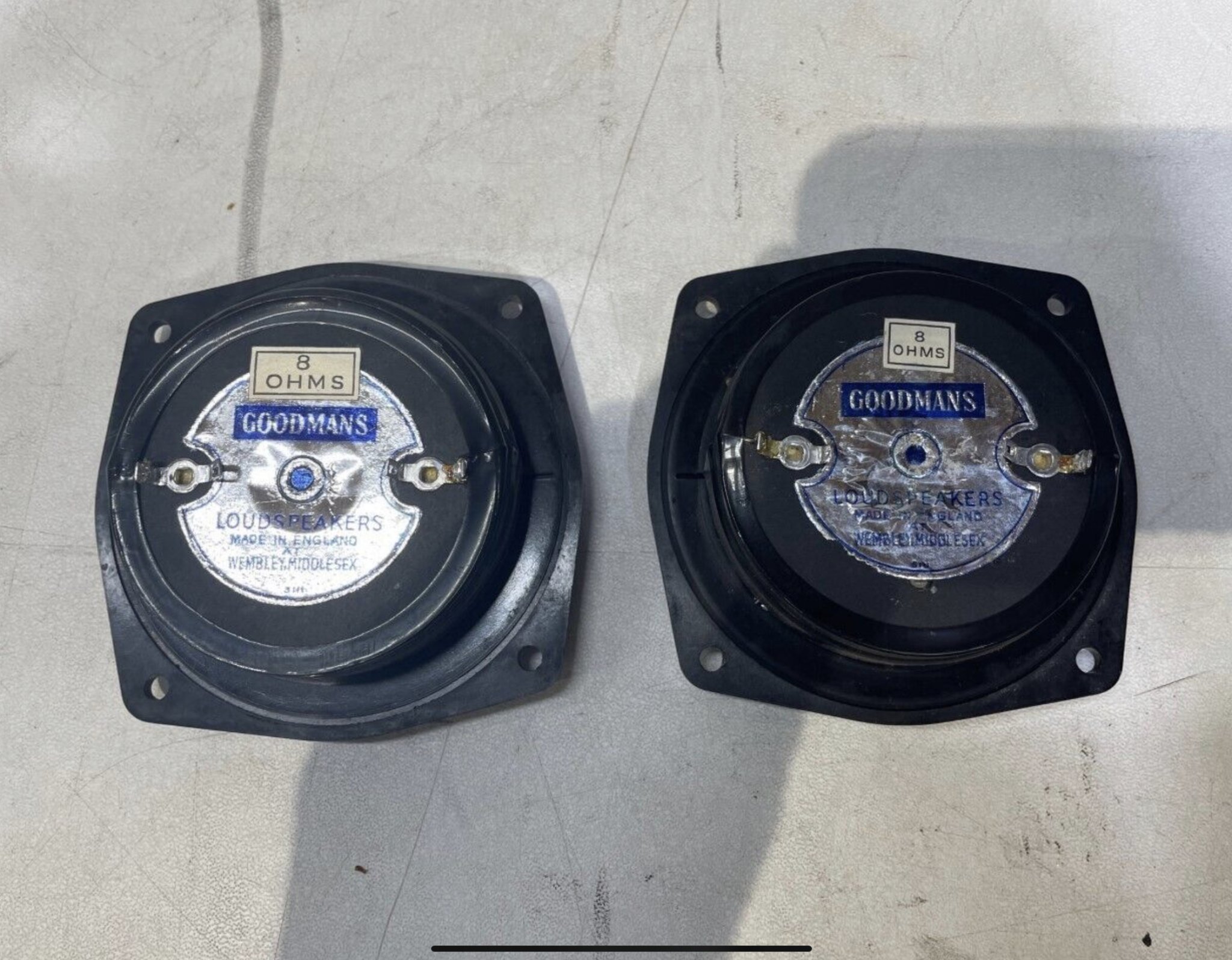

I’m terms of the oily residue, I don’t think that would alter the sound measurably, but it does draw your eye. Do you know what capacitors the tweeters were recapped with? If they’re electrolytics then you could start by swapping out with polys and see if that helps.
In any case, you’ll definitely get an improvement from the DM3s over those…. How confident would you be cutting into some of the crossover wires and soldering in a small inductor? You’d have to trace the wires and compare to the diagram and make sure you don’t bridge something you shouldn’t. Else you could always try doping them. My DM3s in the K2s only have a 4.7uF cap and that’s it.

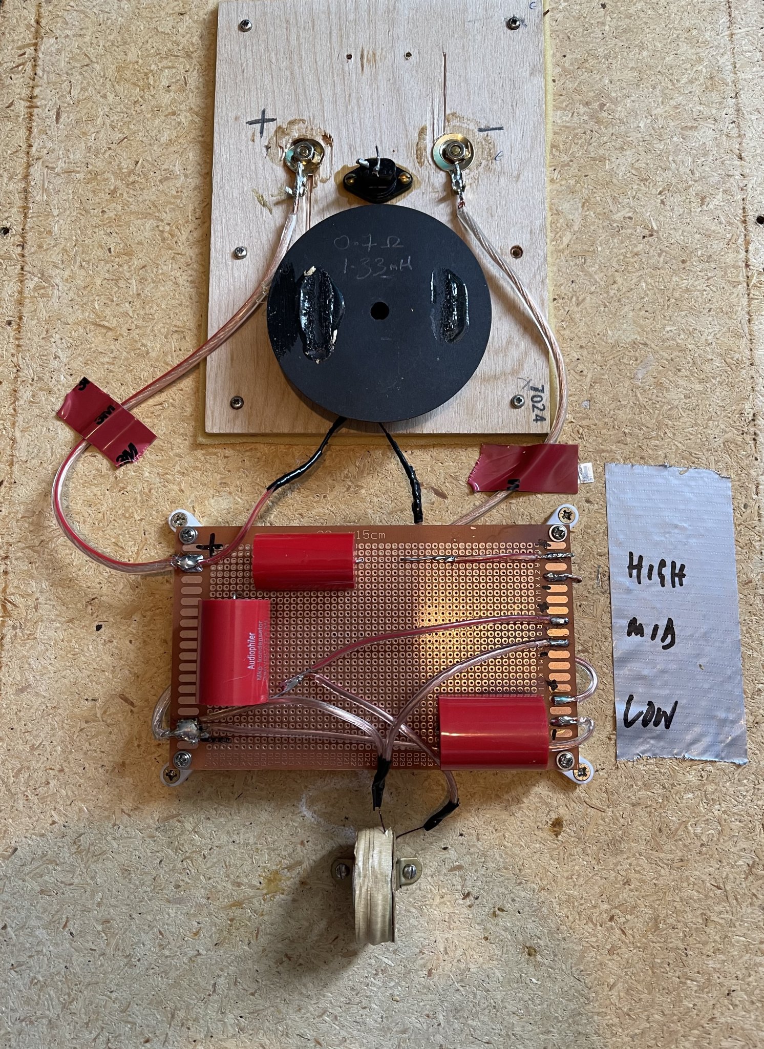

Ah! I see something. Looking at your crossover you appear to have 2 larger poly caps (the yellow ones), but that smaller blue one that is connected to the LPAD - that’s the LPAD for the tweeter. This won’t be helping, because that smaller blue one is electrolytic. Electrolytics don’t pass high frequencies very well (I don’t use them at all and whenever I get a pair of speakers I always recap with polys across the board). Polys are much larger than electrolytics (hence you have a custom bracket there holding them in place) and they can be a lot more expensive but the upside is they sound better and they don’t need replacing.

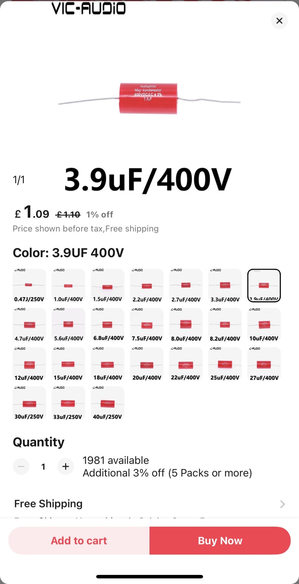

The value from the original crossover is 4uF. You don’t have to get 4uF exactly, a little bit either side won’t hurt. The lower the number, the less of the low frequencies it will let through. I know a very reliable seller on Ali who does decent caps for not a lot:
https://a.aliexpress.com/_ExjLzyF
I have measured his caps and they are always within tolerance. He says 3% but I find it to be less than that more often than not.
They are sold in singles. A pair of the 3.9s should do the job nicely. I’d probably try this first and see what they sound like. You may be surprised.
If you want to swap out the tweeters, you’ll need to visit this seller: https://a.aliexpress.com/_EzR5gPH
And get one of these:
And you would need to place it here:
So after the 4uF cap, with the other end to ground. You can do this easily. Just put one end of the inductor connected to the wire that joins the blue capacitor (hopefully soon to be red) to the LPAD and the other end connect to the negative post.
If those tweeters you’re thinking of buying are cheap enough, I’d say go for it, grab the inductors too then you have those as a backup plan.
One final thing, if you do go down the inductor route, you’ll need to place it on your rear panel in a certain way as inductors can interfere with each other. You shouldn’t have inductors close to each other if they are the same orientation so you should probably place it here or here:
But the same way (on its end) like the small one. That way the fields won’t interfere with that large one. The position by the letter A is ideal - but perhaps a bit further away - an inch more should do nicely. Depending on how much spare they give you on the legs, you can just solder a bit of extra wire to them. If the solder isn’t sticking it’s because the wire is enamel coated. Scrape the ends off with a blade and you’ll see the colour change (they probably will have done this for you though).

If I was you, I would remove the tweeter's Lpad for good, and definitely replace that blue electrolytic capacitor.
Although a little bit technical, if you decide to add an inductor (after) the tweeter's capacitor, you will need to
reverse the tweeter's positive and negative wires. This is because adding the inductor shifts the crossover frequency
phase relationship by 180 degrees. It's just how things work.
A capacitor of 3.9uF + inductor of .7mH will give you a crossover frequency of roughly 2.7Khz.
I would choose an inductor of .6mH rather than .7mH , = 3Khz.

I would definitely remove the LPADs. When I rebuilt the crossover for the scruffy Ks that I have, I made a point of doing this. I think they sound better fully open and it’s a point of failure removed. My K2s are completed, if you want more info, see here: https://hifisubjectivist.org/viewtopic.php?f=17&t=51631 this is my thread where I got some help before I started doping. Here’s another one: https://hifisubjectivist.org/viewtopic.php?f=17&t=47974&hilit=Doping+Magnum search the forum for “Doc mod”, you should be able to get a feel for the kind of modifications I’ve made to my K2s. Unfortunately it seems the resident expert on these kinds of mods has passed away, but the other guys there were very helpful.

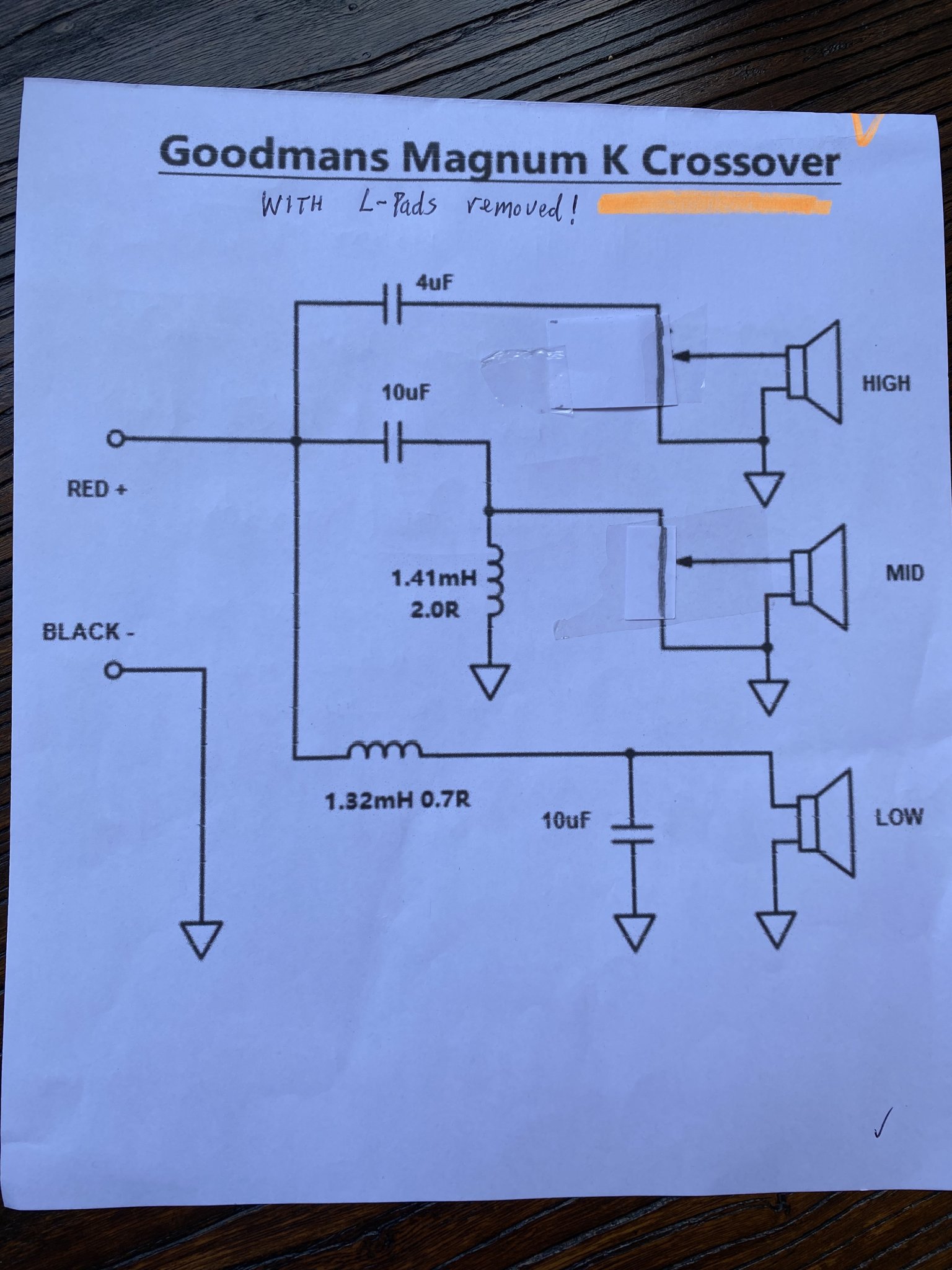

Hi ellnic ..... I love the look of your completely rebuilt crossover in the above photo ........ I want to do exactly that in my K rebuild as well . Have spent weeks reinforcing the cabinets and adjusting the front baffle to take a different tweeter ( sadly one of the original tweeters was totally bung so I am putting in some ScanSpeak Discovery Tweeters D 2608 / 9130 that seem to have terrific reviews and have very similar characteristics.). Please note that I know very little about crossovers , so I'm thinking that I could build what you have if I follow the modified crossover design below ( I have just taken out the 2 L-pads in the drawing ). Could you please let me know if this is correct ..... I would much appreciate your advice.
PS : Hi shauwnmaxr .......... we chatted on Stereonet about Magnum K mods a few months ago.
@mf4ever you’ve almost got it, but you still have the connection to where the lpad would have been on the negative side of the speaker so this will short. You need to remove it like this:
Sorry for the crappy edit on my phone. 🙂
Edit: I’m sure I had a diagram I did without the pads but I can’t find it. Perhaps if we smile nicely at @chrisng he could knock up another K diagram without them and we can add it to the first post. 🙂
Edit2: if you should find yourself doing this Chris, perhaps you could add markers for positive and negative on each driver? All K drivers are in phase.

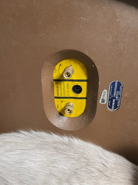

Also, if you can, disconnect that din socket and seal it from the back. This stuff works really well: https://www.builderdepot.co.uk/lumberjack-5-minute-polyurethane-wood-adhesive-liquid-750g it comes out like Vaseline, expands then sets rock solid. Run it round the inside of the cab too 🙂

Wow ..... thank you for the reply and the extensive advice given ...... armed with this corrected schematic I reckon I can have a go at your totally rebuilt crossover......... and with some further kindness from chrisng it will be better still.
I have sealed my cabinet within an inch of its life, so I am curious what the "pushing in the bass driver test " is ? The grills are no longer in the way as I have modified them ...... they will go back on with velcro .......... so I have easy access to the drivers.

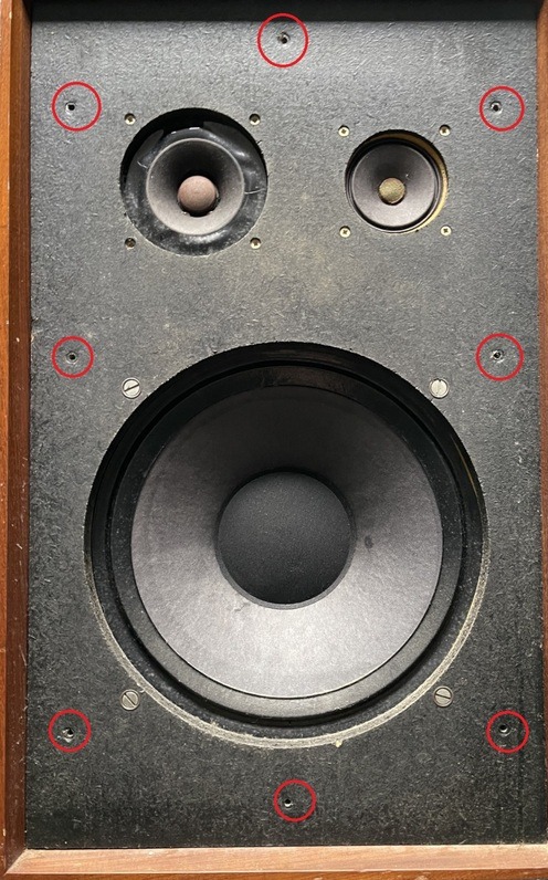

What you’ve done sounds perfect. You’ve eliminated what I think may be the single worst point of failure on the K cabs and the reason why the K2 cab design was changed. This:
Altering the design so that these grille mount holes are filled and the grille goes on with Velcro like the K2s is what I would do, great stuff.

The bass push test involves pressing on the cone of the driver gently but firmly and evenly. If the cab is indeed air tight, it will be firm to the push and immediately spring back out when released. This happens because the air pressure in the cab is briefly increased, then returns to normal on release (think how an unopened drink bottle feels when you squeeze it). If you find that it goes in with a sort of “sinking into cornflour” feeling (not sure how else to describe it) then on release is coming out slowly, you have a leak. This is because the air was slowly pushed out through the pin hole wherever it is, then slowly returns back to the cabinet pulled back in by the driver when it returns to its resting position. You will find some people / forums claim the opposite! I have heard this reversal is particularly common on some American forums - however it is absolute boll**** and should be disregarded. Not immediately springing back = leak.
Apologies, disregard that lumberjack glue I posted above. I’ve just realised that one is the liquid. It might work but I can’t vouch for it….
This: https://www.toolstation.com/5-minute-polyurethane-wood-glue-gel/p78519 is definitely the stuff I used. I got it from TS, too. It’s a bit pricey but it goes a long way and I figured is a great shed item ;-) once it sets hard, you can layer it as well, and it sands nicely. I ran it round all the joins in the cabs and fingered it in (ooh er), the post/crossover plate, the bass driver screw holes (I was getting air leaks there) and I have found it very versatile and well worth the money.
Edit: warning! It expands more than you’d think!
Edit2: Bass screw hole leaks only applicable to K2 because they’ve been adapted to secure from the front - with screws instead of the massive bolts.
