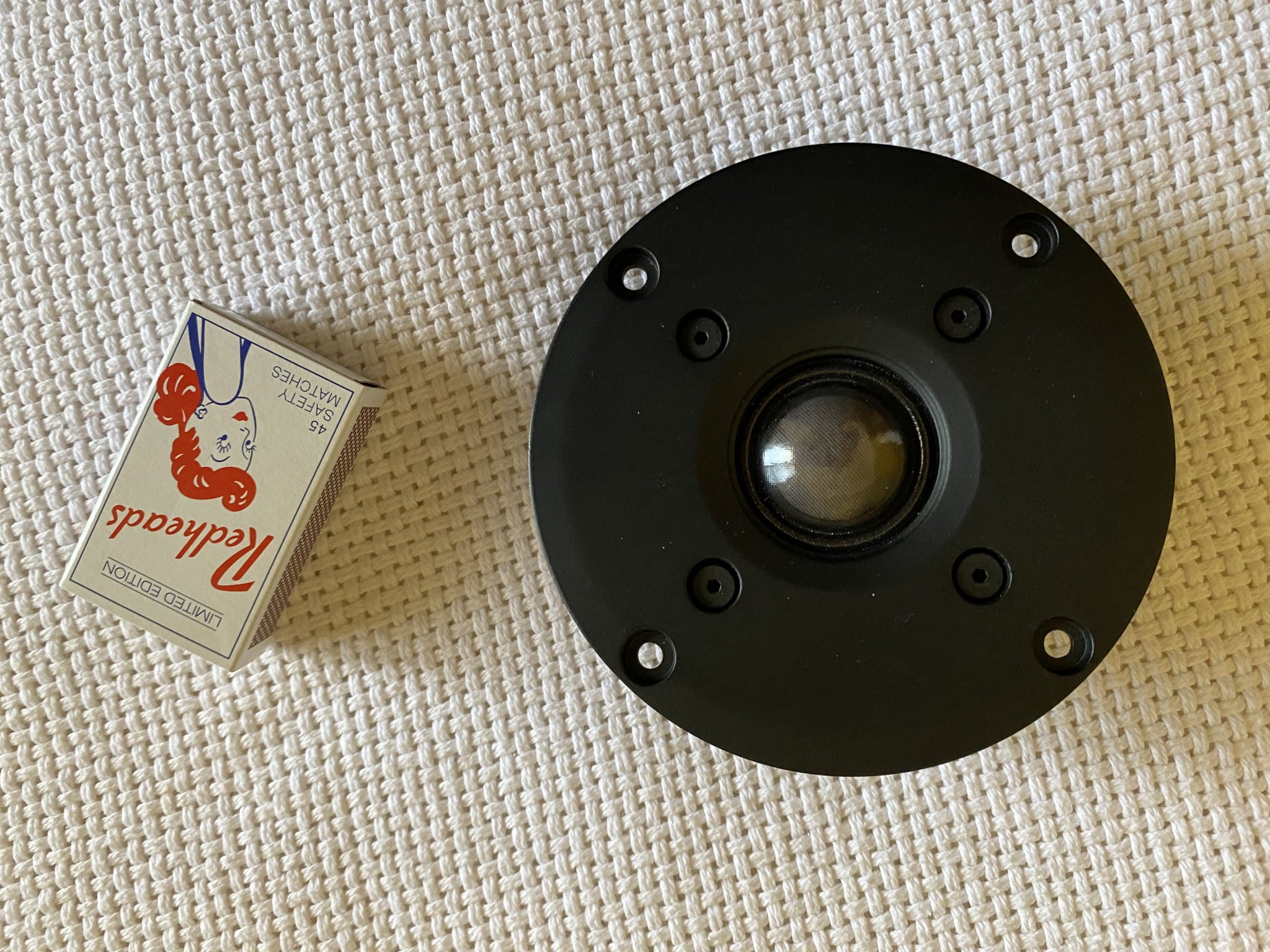

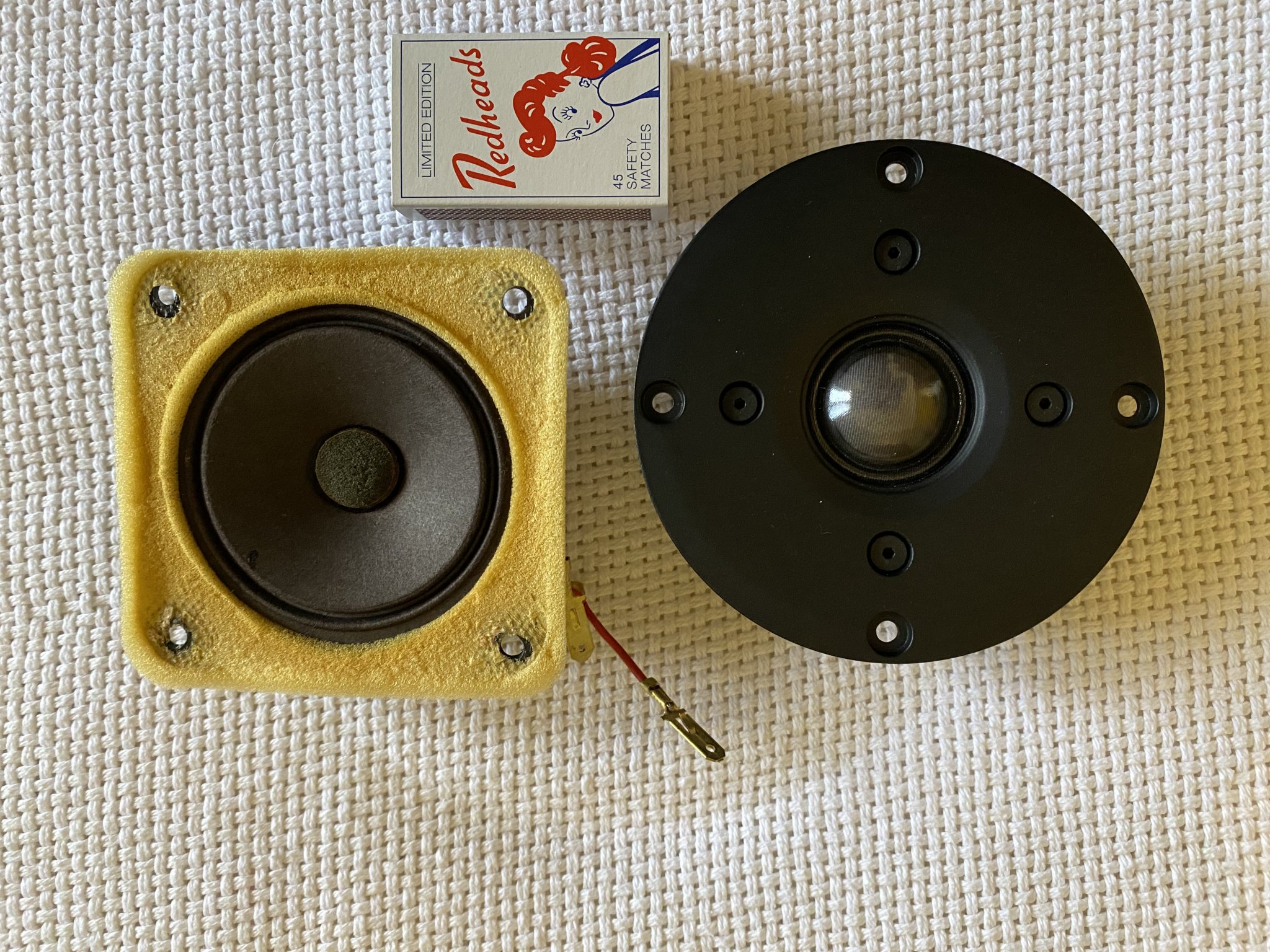

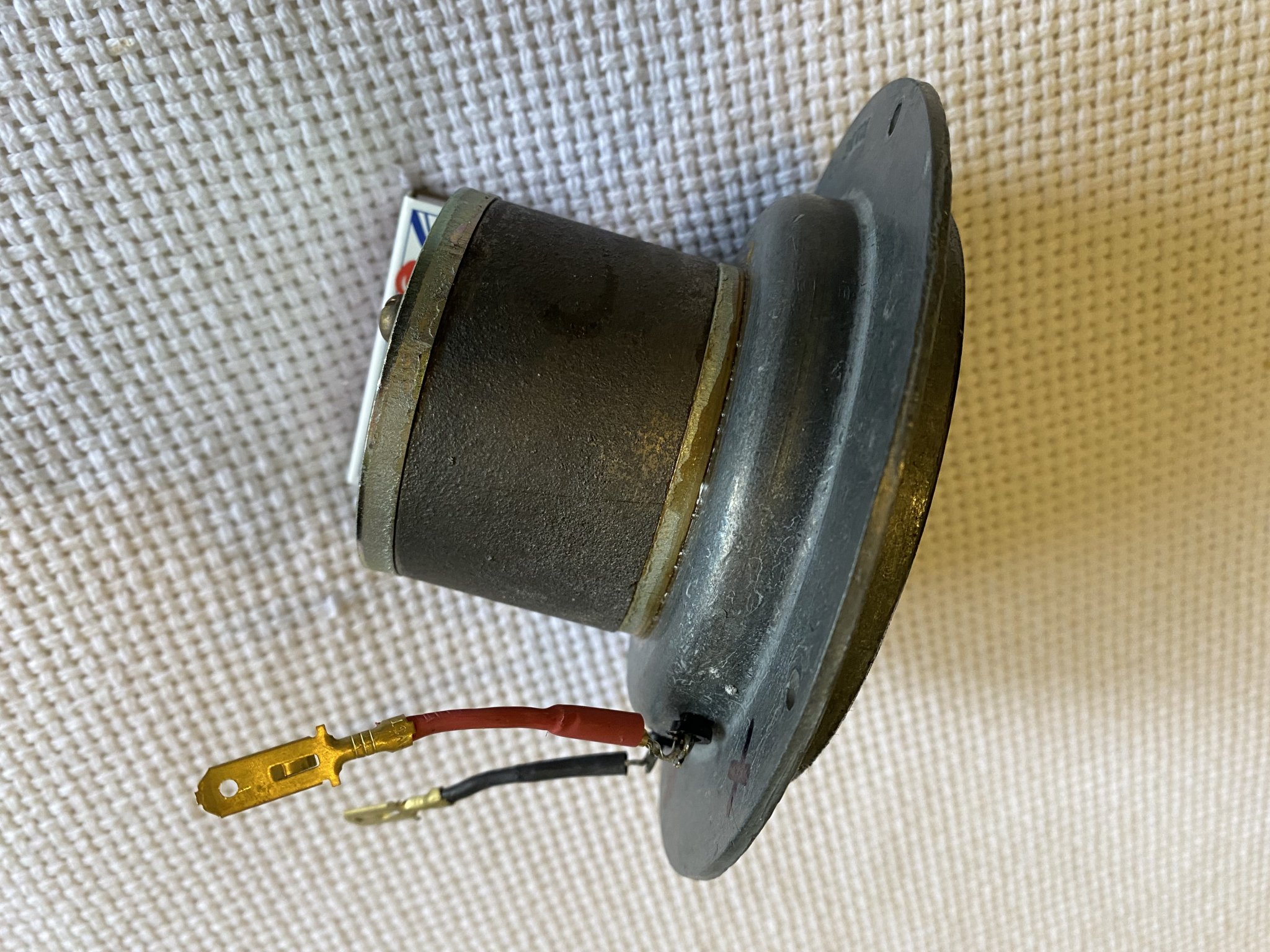

Thanks Mister Audio ....... with a new tweeter installed I may have to do some adjustment, so very grateful for your recommendation.

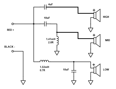

Hi @ellnicEdit: I’m sure I had a diagram I did without the pads but I can’t find it. Perhaps if we smile nicely at @chrisng he could knock up another K diagram without them and we can add it to the first post. 🙂
Edit2: if you should find yourself doing this Chris, perhaps you could add markers for positive and negative on each driver? All K drivers are in phase.
Roger that🙂
Thank you chrisng and ellnic ........ the task has now got considerably easier with the above diagram ........ but for now, back to the cabinets.

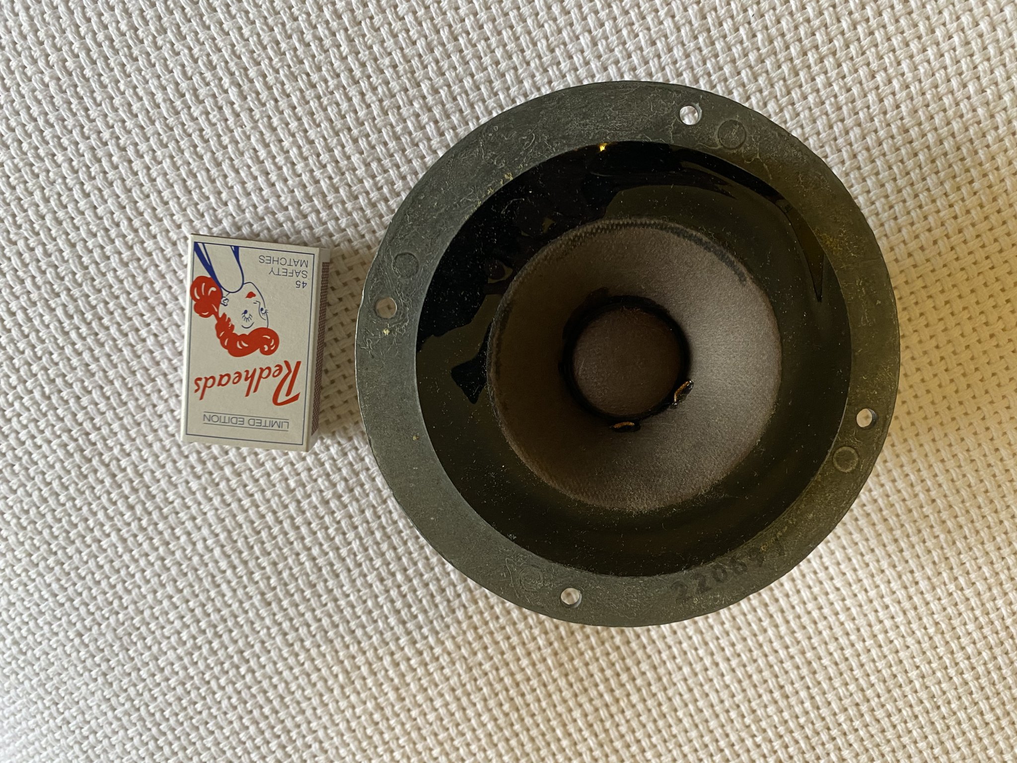

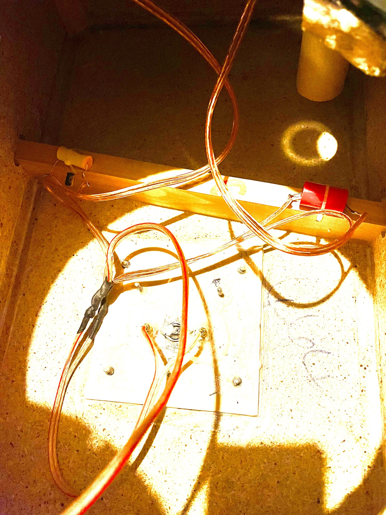

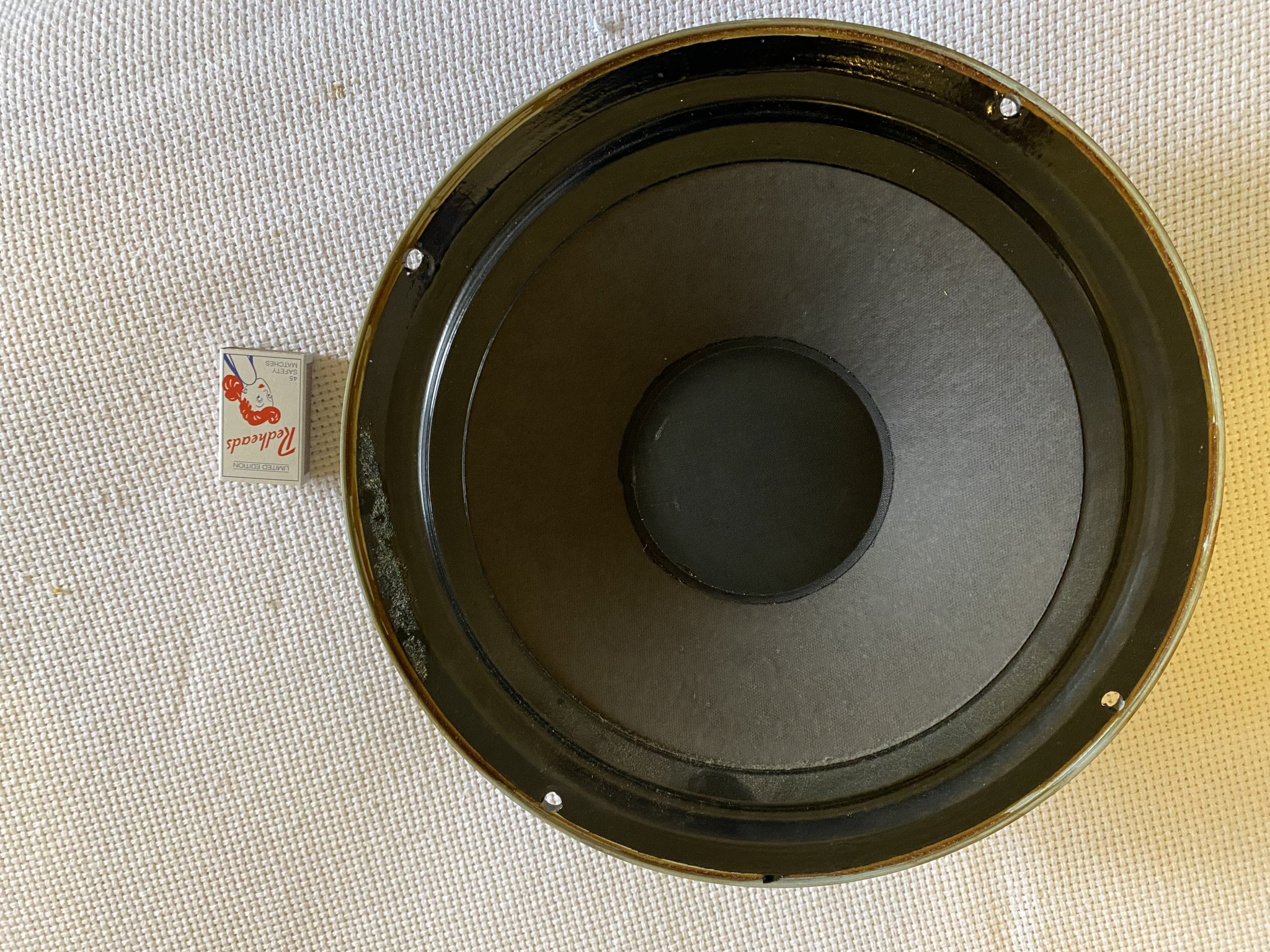

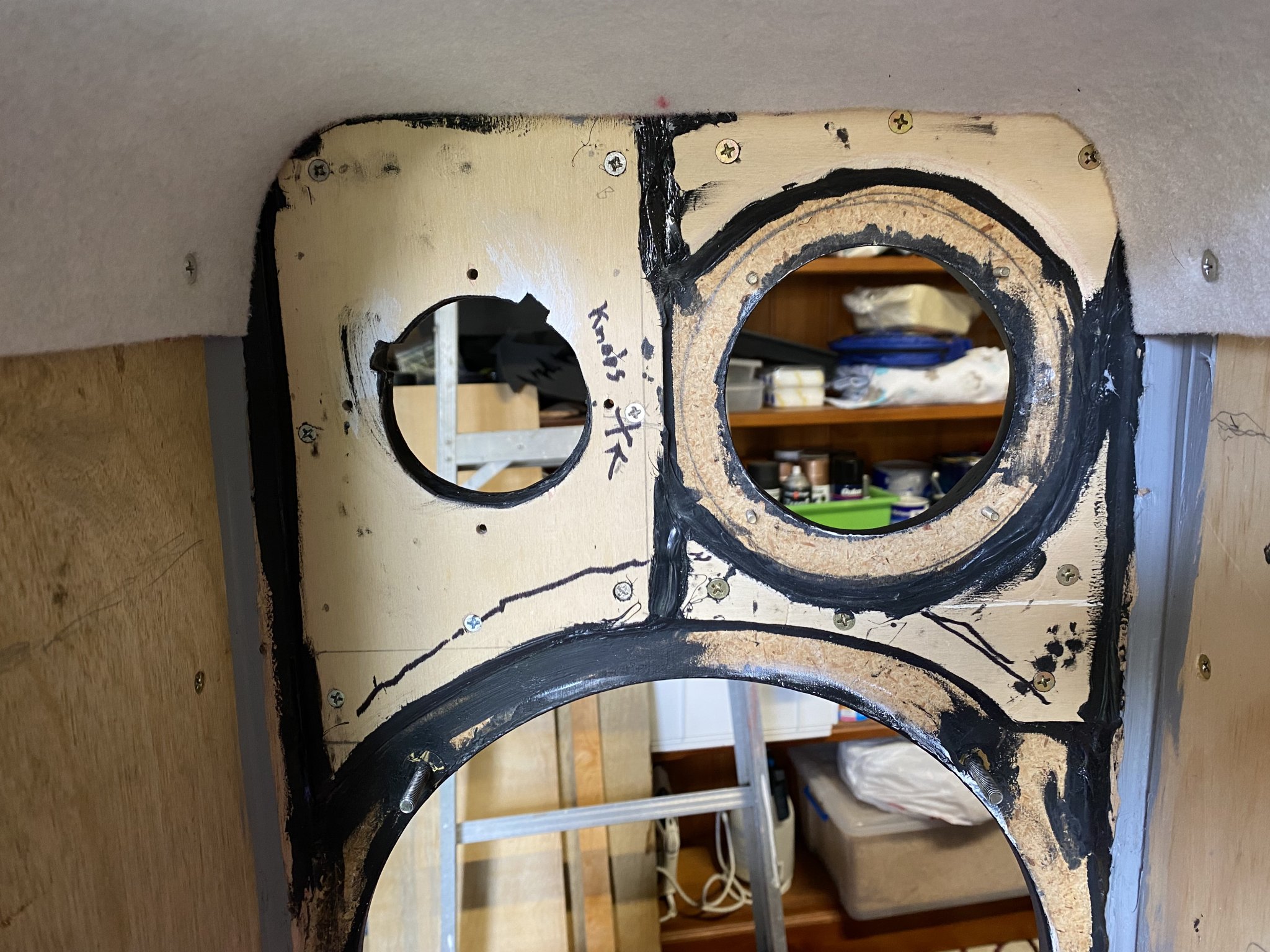

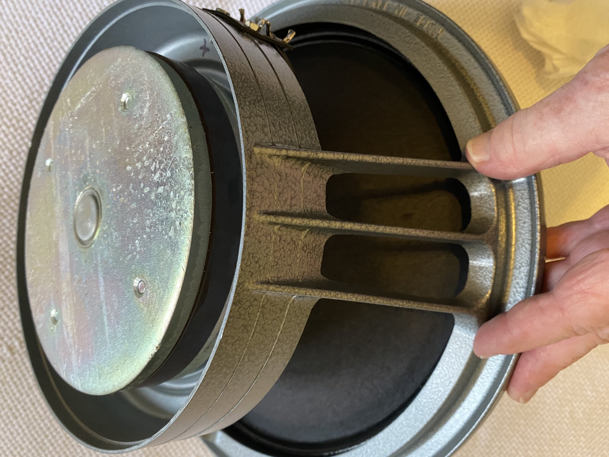

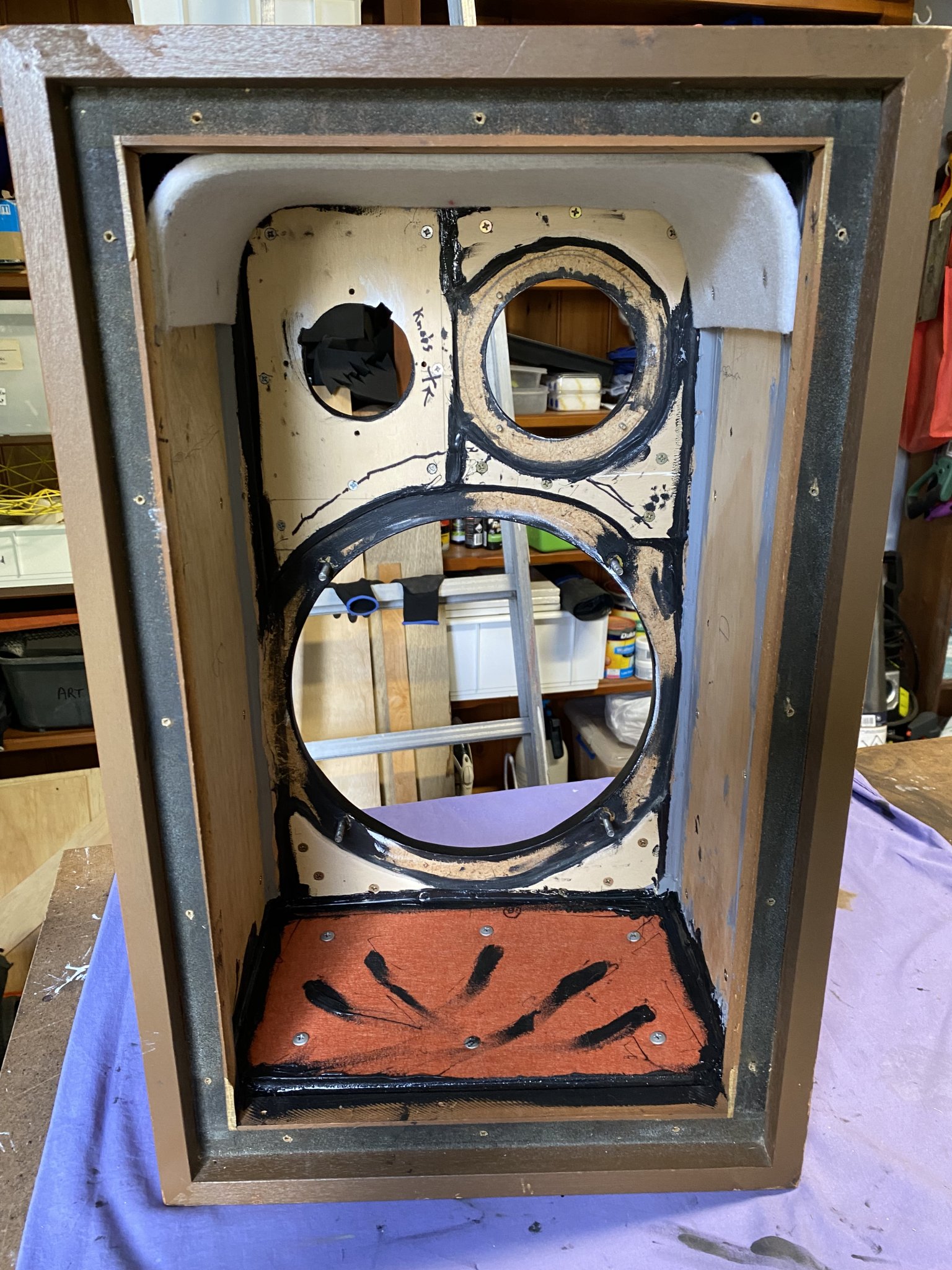

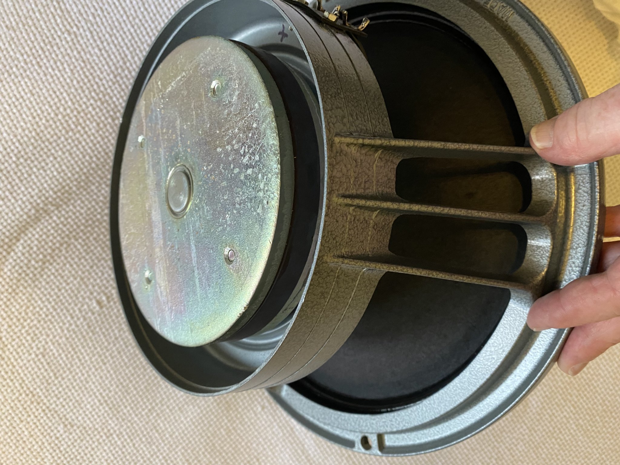

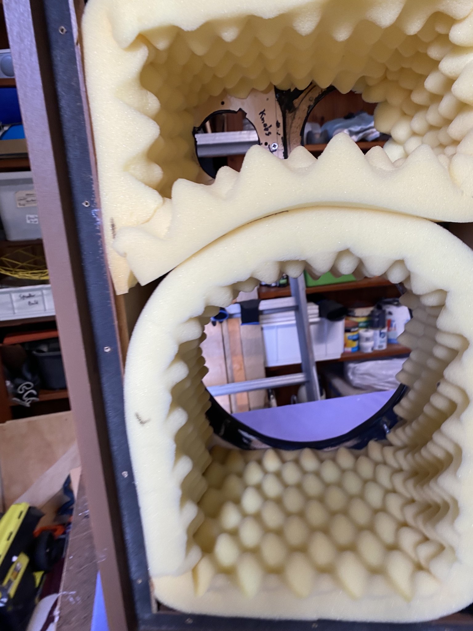

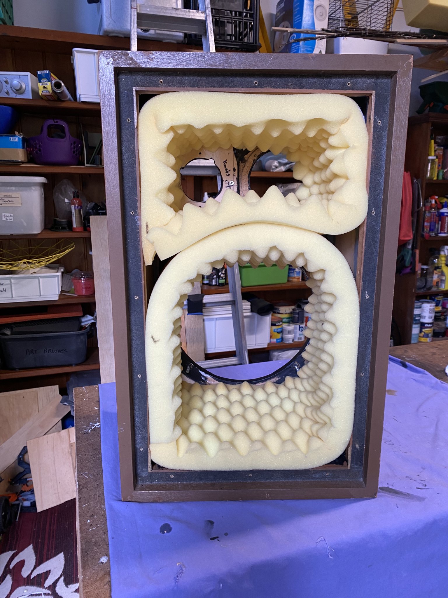

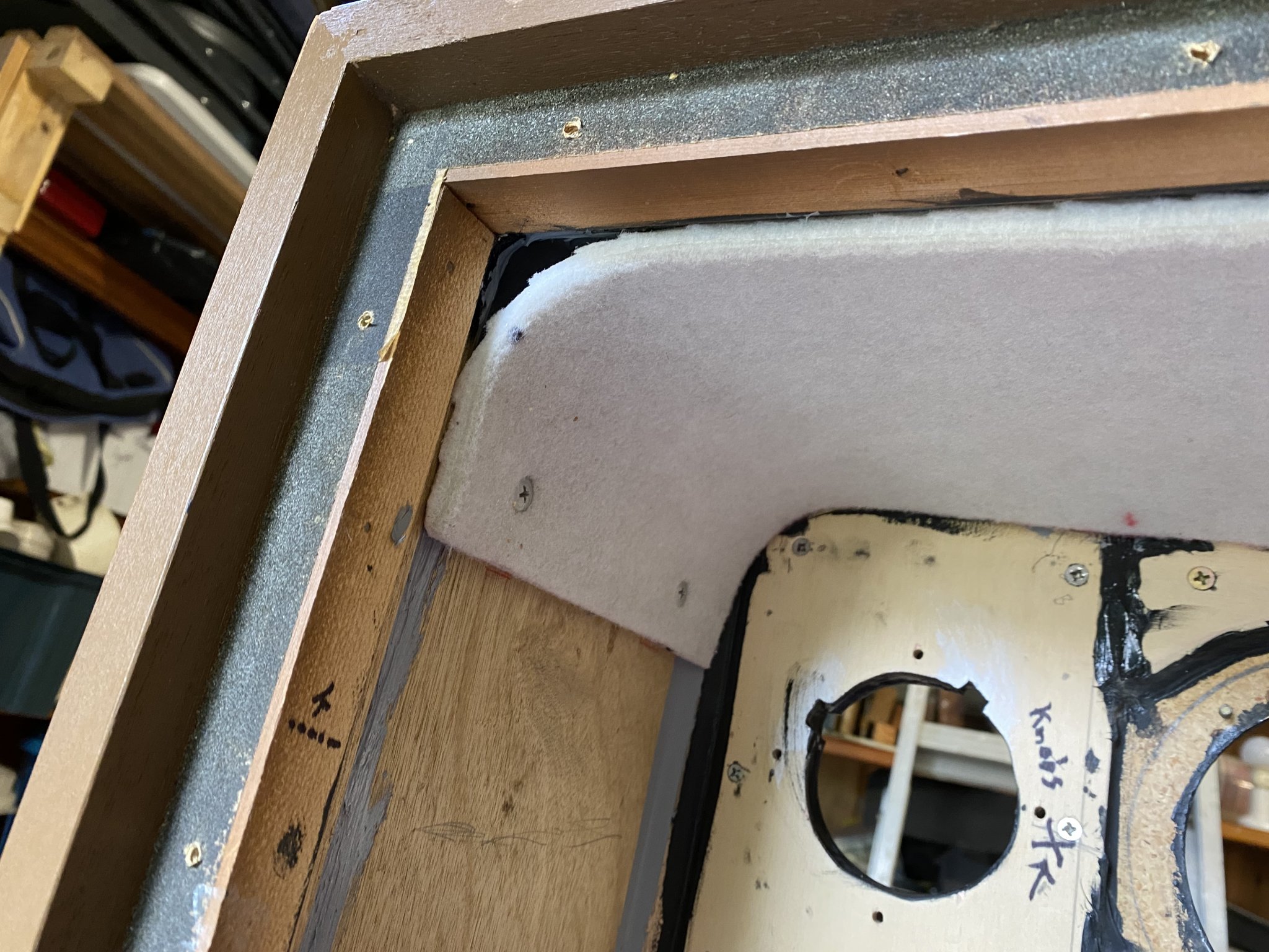

Here are some pics of cabinet bracing and the drivers. What always amazes me is the "brand new " look of Goodmans drivers when the cabinet is opened for the first time in over 50 years. As you can see, the woofers and mids are very heavily constructed....... I have included a picture of the original tweeter and my replacement ScanSpeak Discovery D2608/9130 ( I am hoping for a good match as both drivers are around 90 to 91 db, both 8 Ohms, with the Scanspeak very flat between 3000 and 20,000 hz ). I will be mounting the new tweeter on the front as I will get a more secure hold - I didn't trust those tiny bolts into the chipboard baffle.

@mf4ever looking good. Those mids are pristine. Usually the adhesive holding the PVC surround starts to drift in over time causing rippling. I had to heat gun mine and pull it back to its correct position. Those alnico mids are superb drivers with a lot of range and feeling. In the 2 way mezzo (I think it was the mezzo) they just use that and the bass driver.
Nice work on the baffle, too. I haven’t done much to my Ks yet except the crossover, I’ll be interested to know what this all sounds like when it comes together.

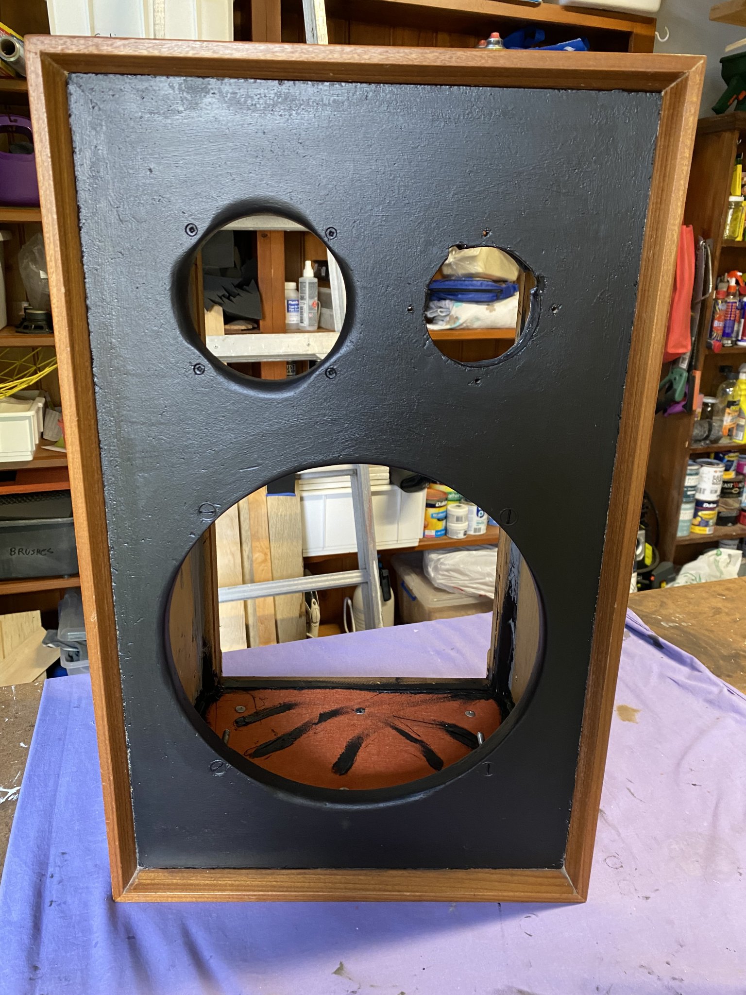

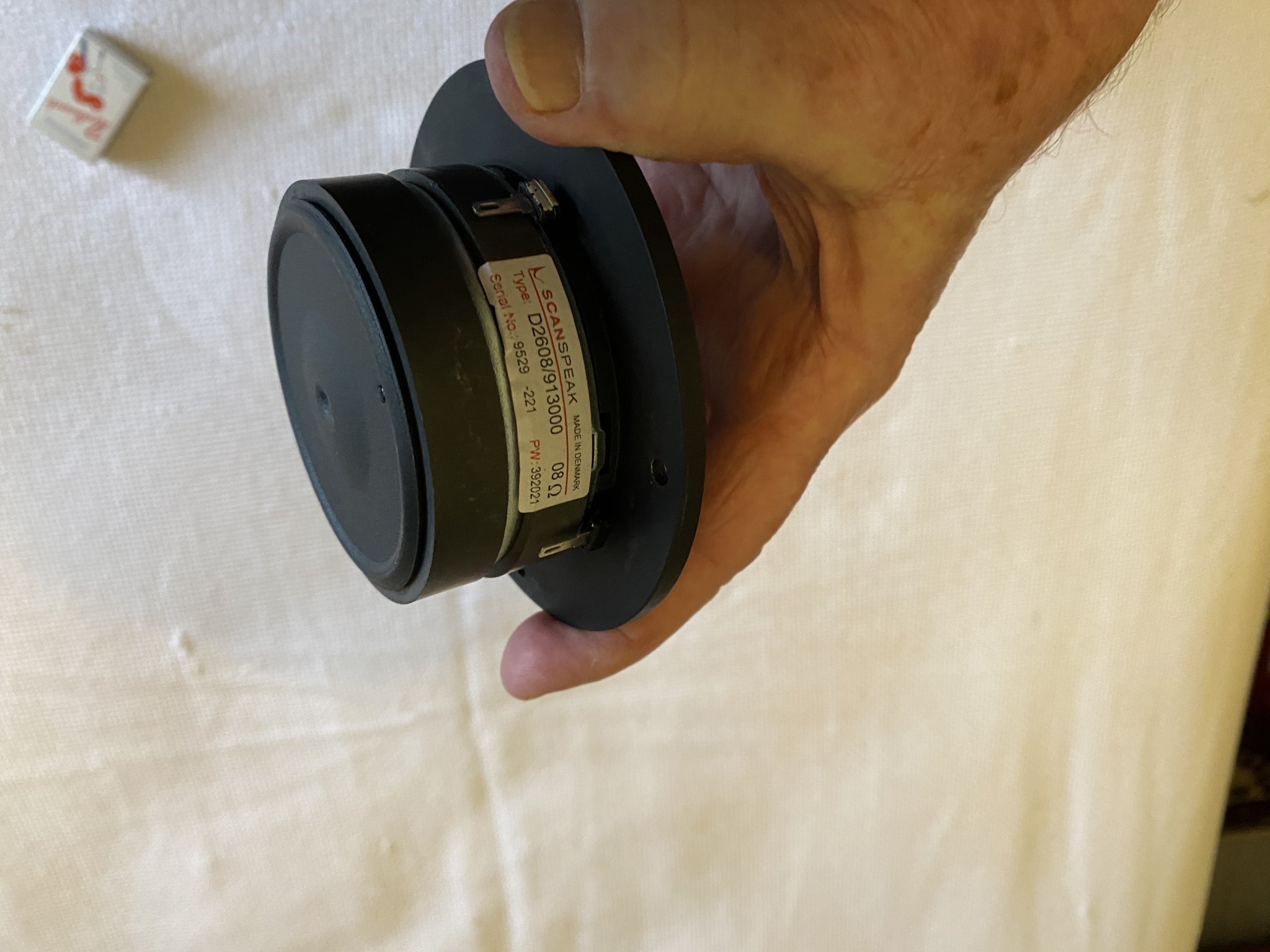

@mf4ever one thing I will say (you may have already thought of this) is that if you do front mount that scanspeak, you may need to add mounting strips of wood for the grille to sit on like the K2. Or if you are recovering them, cut the hole in the grille a bit bigger so that the front plate can protrude without touching it. Depends how you want the grille to look. Another option would be to ever so slightly drill out the scanspeak holes to facilitate slightly larger bolts if you don’t want the existing ones and return to rear mounting.

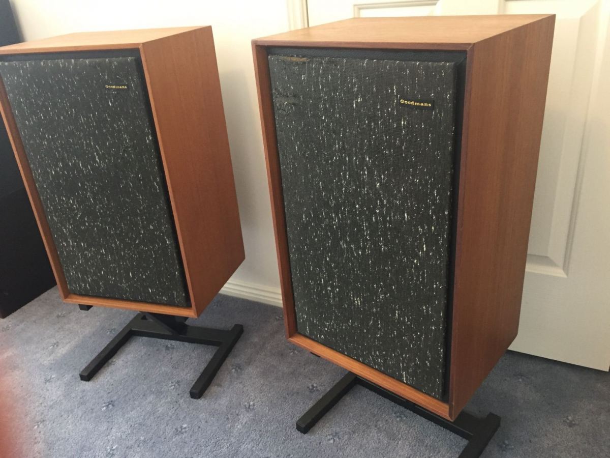

Hi ellnic.... Below is a picture of my Goodmans ........ totally original including the stands BUT since I am never going to sell them I feel I am not constrained by authenticity ....... so I'm thinking of refitting new grills with some crazily wild 1960s print ........ our house has every room in different wildly bright colours so the speakers will fit in just nice. ( some Goodmans fans may think this is desecration and I do understand that view as I have been a colonial cedar furniture restorer for over 40 years and absolutely insist that everything is totally original ....... but Audio should be fun )

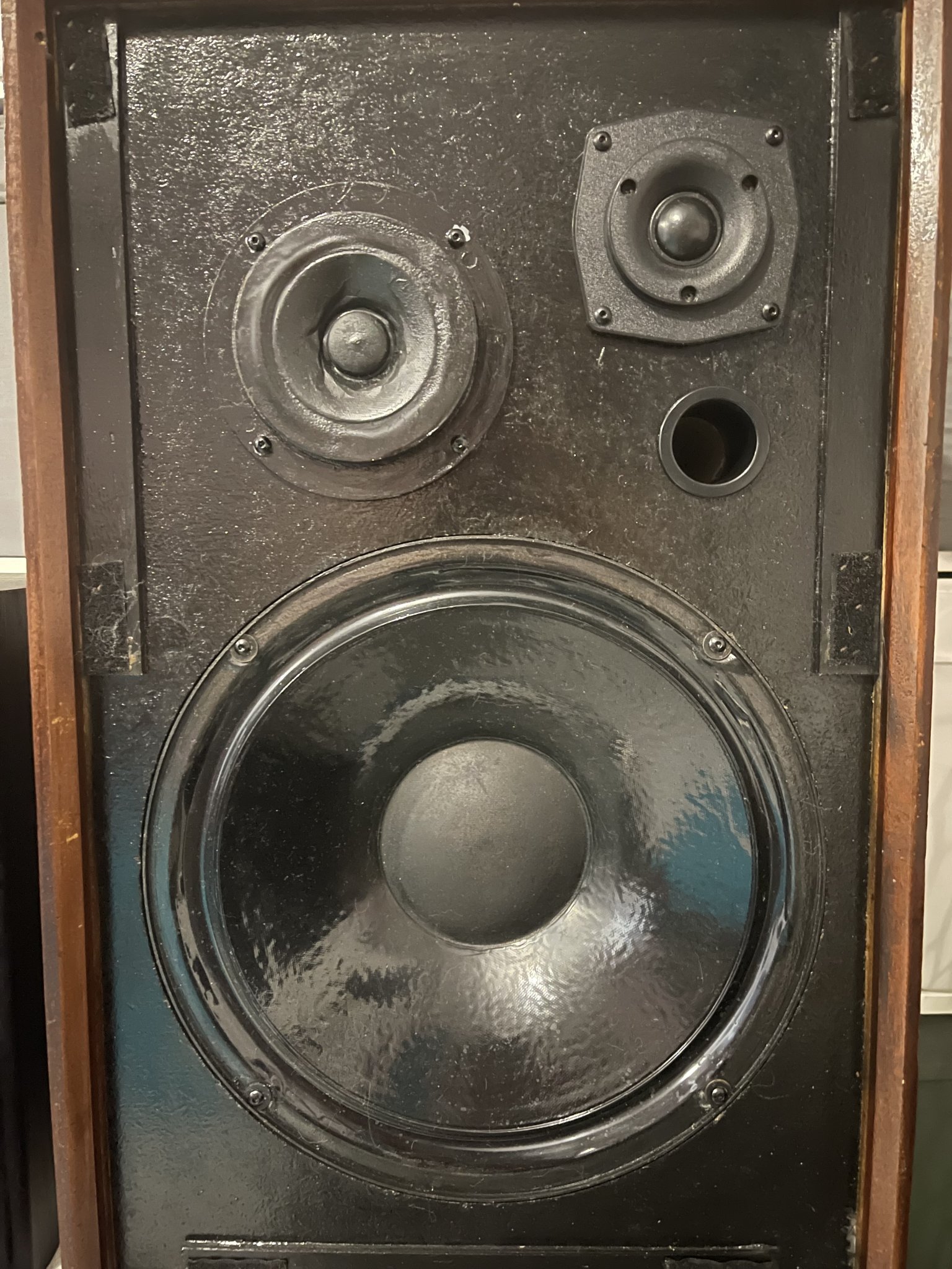

Here’s what the fronts look like:
I’ve completely blacked the drivers and replaced the screws with black hex bolts (yes there are some places that need touching up - where I’ve been removing and replacing drivers, some of the paint has flaked off). The veneer was an absolute s*** show. I’ve done my best but I won’t showcase that ;-) mid and tweets have been doped with plastidip. I risked the bass centre cap and found it wasn’t essential that it breathed so we’ve got an all black look 😎 I am not sure if the port is too small but it’s all I had an I figured the bass is so huge it probably wouldn’t need much. I tried to mimic the position of those I found, in the hope that it worked well 😛

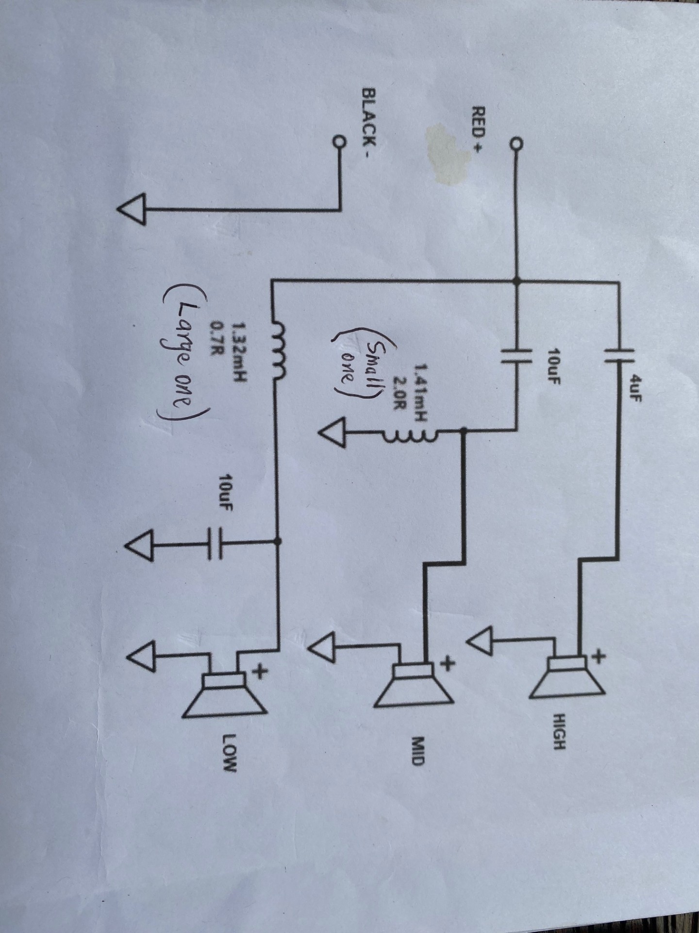

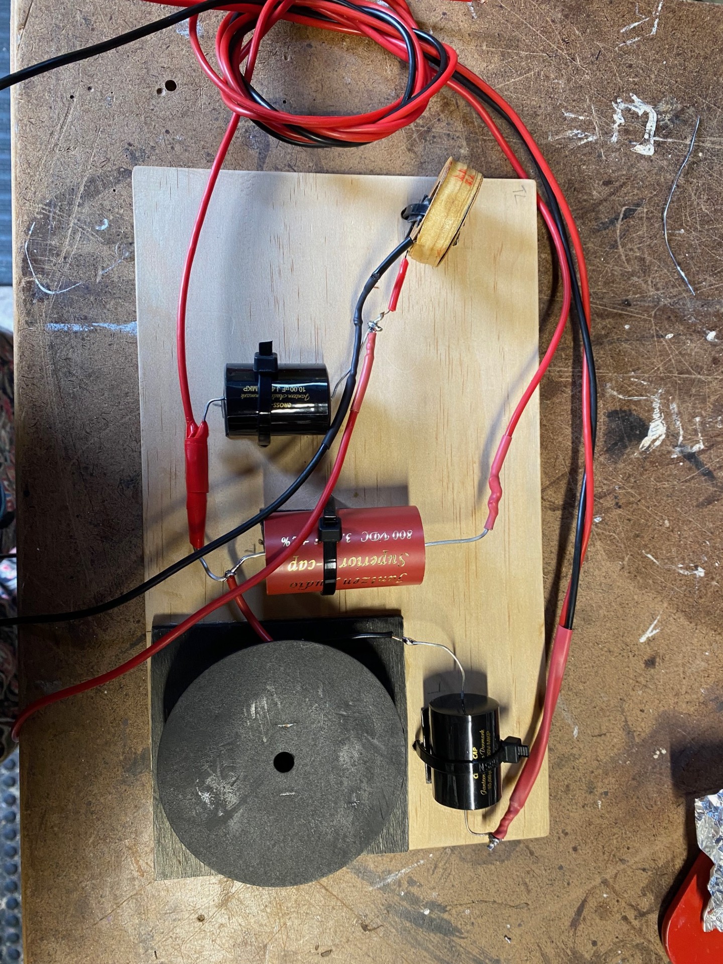

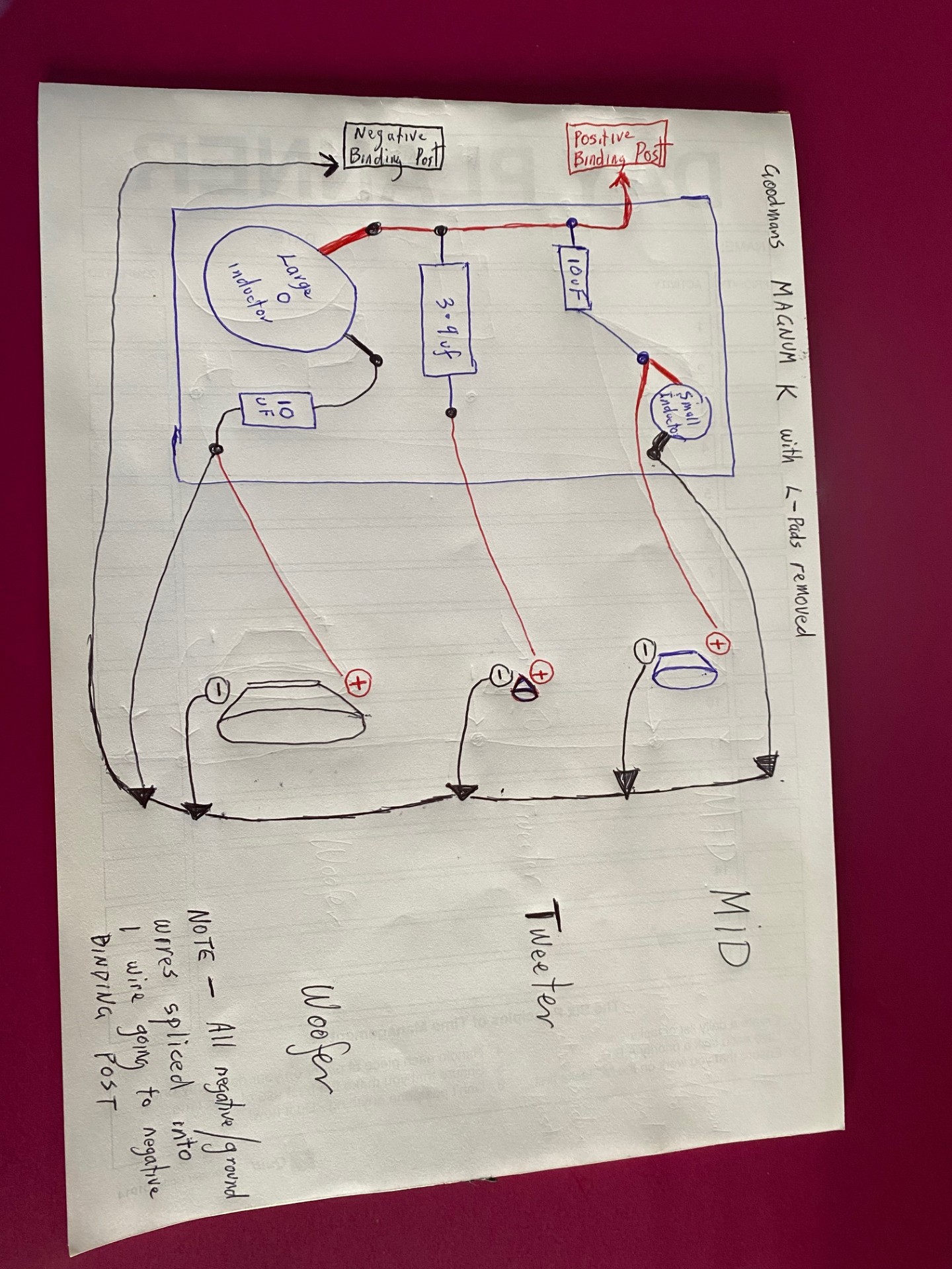

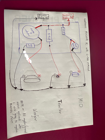

Hi ellnic ........ it's been a while but I have completed my rebuild of my Goodmans Magnum K with the L PADS REMOVED. Sadly I obviously got something wrong when I translated the cross over schematic kindly provided by you and Chrisng ( see first post in this thread ) ........ there is no sound and when I did a continuity test with the multimeter it stayed at zero.
Posted below is a picture of my cross over as well as a drawing showing what I did ......... I would be so grateful for any advice by the community here as I have spent sooooooooo. much time on this project and I feel very close to completion.
Chrisng ...... you are a lifesaver......... will do this today ....... will report on the progress....... truly much appreciated .....
CHRISNG ...... YOU WERE TOTALLY CORRECT ...............AMAZING !!!!!!!!!!!! Just finished , plugged in and they are really beautiful .......... mids and bass really smooth, the brand new tweeter will need 100hours as do the new caps ........ but could not be more happy with the results ...
Chrisng ......Started this rebuild 15 months ago so I am so thankful for your fine tuning here ........ and a big shout out to the diyaudio Community. Will put the second speaker on the bench tomorrow and begin the rebuild. Will let everybody know the final summation after both speakers finished and burned in ....... Cheers
