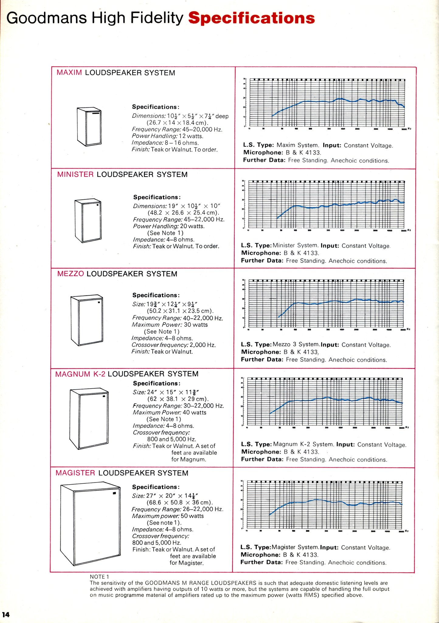

I was looking at these:
And it seems as though the crossover frequencies for the K2 are 800 and 5000 Hz. I also noticed that the rating for the K is 25 Watt, whereas the K2 is 40 Watt. Interestingly, I also got the woofer spec wrong in my earlier post. The Goodman's literature says both woofers go down to 30 Hz.. I could have swore blind I read somewhere that the K2 woofer was 20Hz. 🤔
This is going to change things if I want to mix up the drivers. Could I ask for your advice on this as you know way more about crossover frequencies than I. I would like to try dropping the K alnico mid in the K2 and also a K2 tweeter in the K. This would seem to give each speaker the best of both worlds.
The quoted bass frequency figures mean little. To compare the K and K2 bass drivers, you would have to measure their resonance frequencies when out of their enclosures and in free air.
The power ratings also require qualification. Note 1 in the second attachment is really stating the maximum recommended amplifier power. The speaker can handle the 'up and down' power variation of music signals from such an amplifier, but would not withstand a full 40W RMS of power applied continuously.

I'll add that the Magnum-K leaflet statement that there is "minimal distortion right down to 20 Hz" should not be taken to mean that the bass will have significant amplitude at that frequency, i.e., it should not be regarded as an indication of audibility.
A bass extension figure like the 30 Hz given for the Magnum-K should really be qualified by adding the number of 'decibels down'.
For example, a lab report might quote a bass extension thus: LF extension 30 Hz (-6 dB with reference to 200Hz).

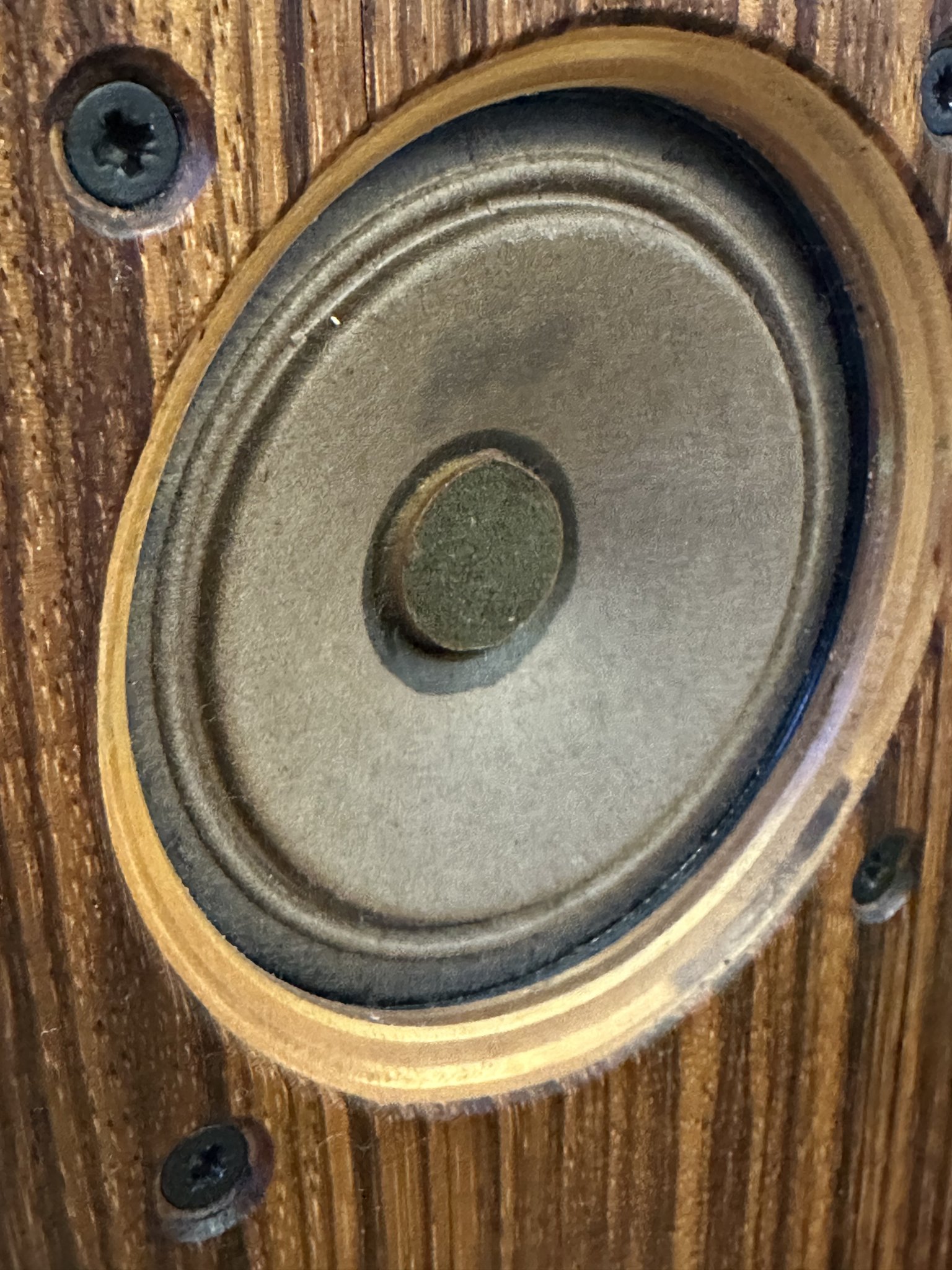

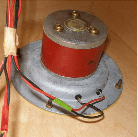

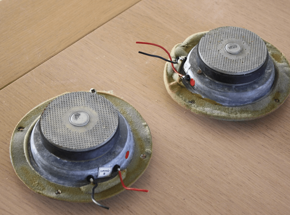

@Mister Audio I was surprised at this also but I think I may be able to offer some insight. One of the things I have been considering is modding one of the K (not K2) speakers using doping on the bass and mid and removing the crossover components. There are lots of threads about this over at Hifi Subjectivist. The process involves drizzling contact adhesive near the dust cap in the centre of the cone to mute higher frequencies, then coating the entire cone in a rubberised spray. I think it's possible that Goodman's may have already done something like this with the K2 bass. It's coated in kevlar, and there is often a lot of glue near the centre caps. Here is a historic post from someone trying to rescue the cap on the Magnum SL speakers, which uses the same bass driver: https://www.diyaudio.com/archive/bl...odmans-magnum-k2-sl-cone-rescue-dsc06847s.jpg there seems to me to be a LOT more glue there than is needed for a little paper cone. I believe this driver may be doped out the factory.
As for the mids, they are both paper 4 inch. You can swap them round and they fit exactly. The obvious difference is the alnico magnet, but as I understand it this is more a sensitivity thing, there are probably other differences you cannot see with the eye if the quality is superior. From the front, they look very similar:
Note the metal frame is present but behind the baffle on the K.
But from the back....
Similar until the magnet begins.
Just in case there is some sort of disparity between batches or even possibly a second revision of the K2, here is another crossover from a different pair. It still looks like the woofer is full range to me (now I know what I am looking for!) but perhaps @chrisng could cast an eye over this one too just in case it's different:
I like how the person assembling it wrote "go" in the corner 😀 This board isn't stamped with a serial so I am guessing it's earlier than the other one I attached.

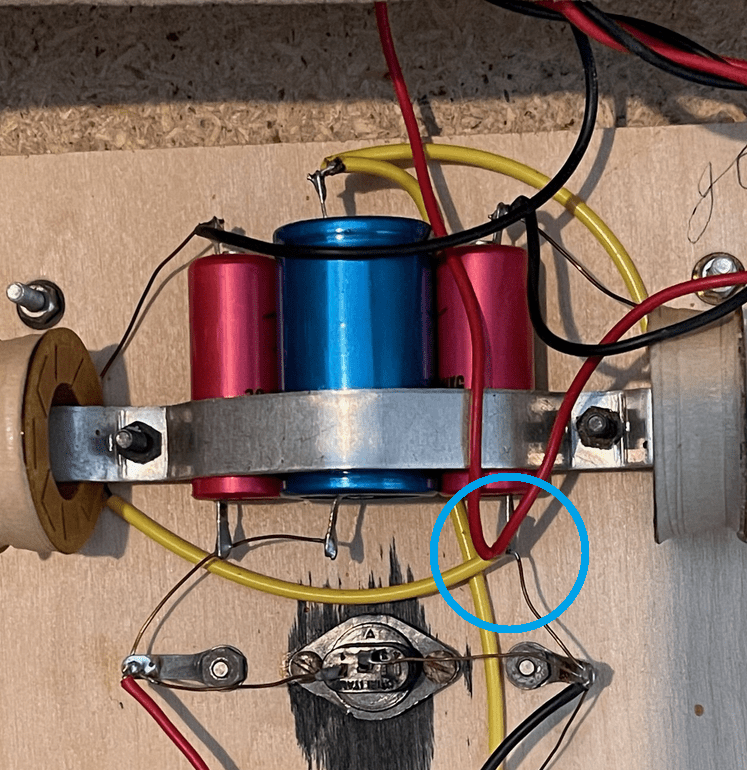

@planet10 in the above pics, the crossover was actually mine but the drivers were google images because I was out and didn’t have a pic of them. Mine don’t look too dissimilar, but there is some rippling of the plastic surround.
Here is a pic (that really is mine):
The photo makes it look a LOT worse than it is. Every little ripple in that shiny surround goes white but it’s really not that bad at all. I think the photographer in the google image photo just got lucky. If I compare the above to the shipwreck K2s that I’ve given to my friend, the centre was pushed in, the paper was unglued all around, the paper was looking ropey. Clearly an abused set. I think they’ve been salvaged though. These are quite resilient drivers!
And to me. The red and black wires at the bottom of the crossover are connected directly to the input terminals and presumably also connect directly to the bass driver terminals.
It's not unusual to find bass drivers that have been designed to have a high frequency roll off that requires no additional support from an LC filter.

The positive mid & tweeter terminals go to - ground due to the crossover design.
CHEERS🙂
Reactions: ellnic

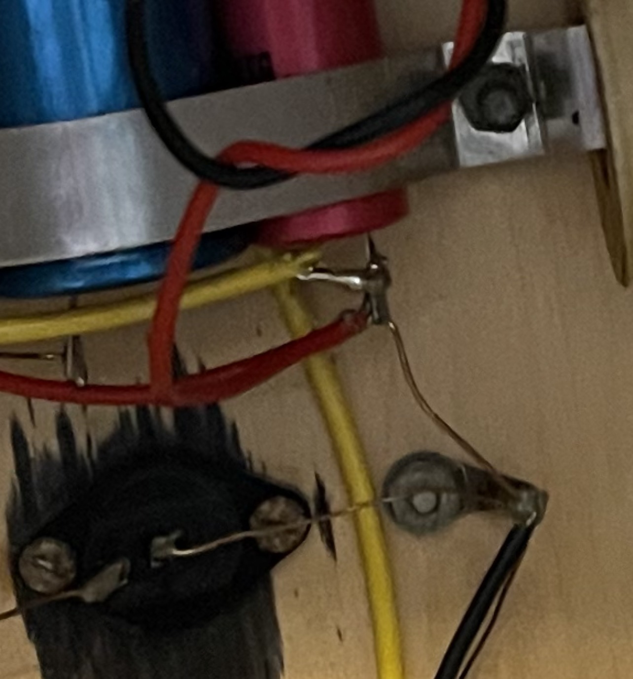

But on the second K2 crossover photo I not sure both high and mid driver red leads are connected to "ground" post, what I see is a single red wire bend to a V shape rest on top of the crossover (please take a closer look of the blue circle on the photo).
Reactions: ellnic
@chrisng that really does look like one continuous red wire in the first photo doesn’t it? But I’ve just opened it back up and:
It’s 2 separate wires connected to ground.

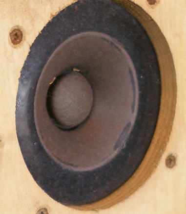

Also, for anyone who’s interested, this cabinet has a good example of the doped bass:
You can see the abundance of glue from approx 1 o’clock to 7 o’clock.
Just some info for the thread as well, I have since learned that what I believed to be excess doping material under the PVC as in the above pic, was actually the PVC layer separating from the paper layer. So apologies for the misleading post. If you find this happens to your K2 (and SL or Magister) bass, this is fairly easily fixed:
1. Heat gun, keep it moving, around the outside of the dust cap then as the glue starts to soften, use a small flat screw driver to separate the cone from the PVC and remove. You may need to lift slowly whilst applying heat in stubborn areas. DON’T PULL HARD, if it’s not coming off give it a bit more heat. When pulling pay extra attention and care to the part that’s separated, else it’ll just rip. Never leave the gun in one place. You’ll melt the PVC quicker than you’d think.
