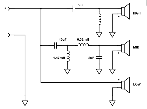

If I were to attach a pic of the K2 crossover which I happen to have on my phone, could I persuade you to run your eye over that too?
Also, made a note of the inductors for this one: bottom inductor was 1.47mH, top right was 0.32mH, hadn’t got round to disconnecting and measuring top left. Cap values are 5uF and 10uF.

It took me a while to figured out where the 1.47mH coil connected to until I saw the photo on post #17. 🤔Also, I wasn’t expecting the bass to have no filters.

I read earlier that the cross-over frequencies were meant to be 1.5Khz & 6Khz. (I am assuming the drivers are 8 ohms)
I was looking at the component values in the circuit just above, and some things just don't add-up.
I will start with the tweeter and work down to mid and then bass.
With a (Tw.) capacitor of 5uF, the corresponding (mystery coil) should be .5mH giving a XO. of 2.5Khz. (that is not 6Khz)
In fact there are no 6Khz filters using 5uF without severe impedance implications.
Now, the Mid 'hi-pass' using 10uF & 1.47mH = a XO. of 1.1Khz. (not 1.5Khz)
The Mid 'low-pass' using .32mH & 5uF is problematic, giving a XO. of around 3.5Khz but with an output peak and
corresponding impedance dip. (certainly not 6Khz)
With the woofer having no filtering, I don't really see it rolling off naturally at 1.1Khz, surely it would go higher.
I would love to know more about the drivers and see a picture.

@Mister Audio I’ll need to apologise I think as I may have created some confusion. The original reason for this thread was the magnum K (not K2) crossover. But since @chrisng traced it with ease, I asked him to look over my K2 pic as well. So we’ve unintentionally got 2 different speakers in the mix here. The crossover frequencies posted by @Galu of 1500 and 6000 in this link: https://worldradiohistory.com/hd2/I...ecording-IDX/IDX/ATR-1966-4-OCR-Page-0025.pdf are for the K not the K2.
I’d have to look into the K2 frequencies when I get back from the school run, I will also have some time today to measure the inductors on the K. I’ll repost the crossover pics with additional annotations.

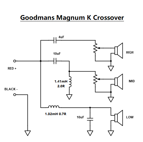

With the K's (not K2's) I saw 2 coils and 3 capacitors.

Here is the annotated K crossover:

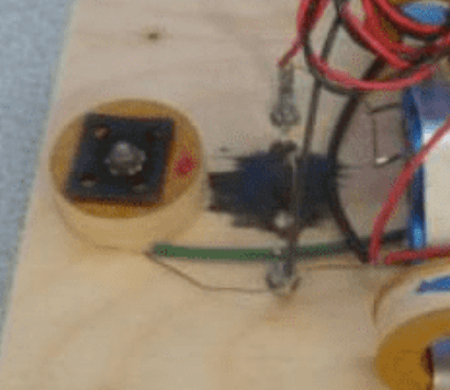

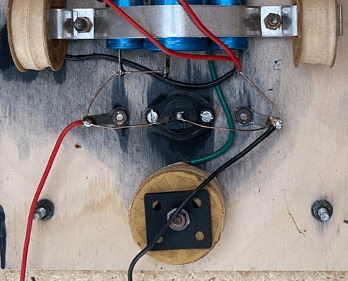

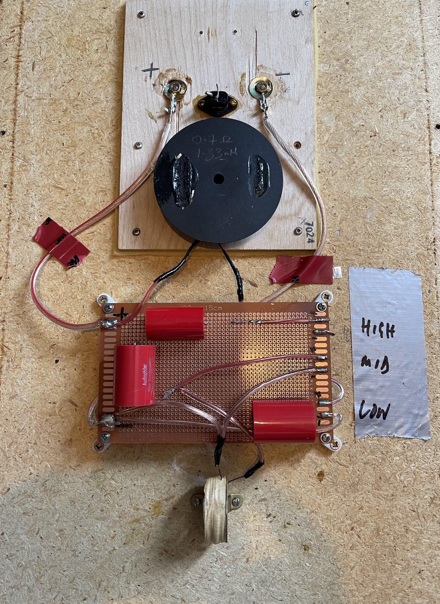

Well, one is done! 🙂
I developed new levels of hate for these Goodmans crossovers removing those Lpads and don’t get me started on the bolt securing the cap clamp. Everything was glued and lacquered. The mind boggles how they can put effort to secure those sorts of things, then use the crappiest wire in the world for the drivers. 🤷♂️

I forgot to mention a few things >The just above 'Attachment' of the crossover is correct & a functional design. Good that that's solved.
For the tweeter, I would use the circuit 4uF and not the old 5uF value in your box.

The XO. frequencies of the 'correct' K circuit are: 1.2Khz and 5Khz, depending slightly on the impedance of the drivers.
2 times 2.2uF caps in parallel will give you 4.4uF. That would probably be better than 3.3uF.
