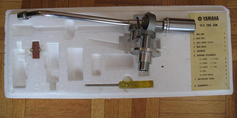

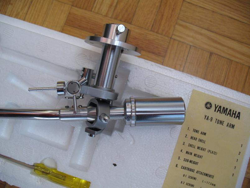

I sold my Yamaha 801BL of course I kept the arm ,soon I test it on my Elac.
The arm is Yamaha YA-9, very nice 9 1/2" arm.
Of course not a $$$$ arm but probably better than my old square aluminium pipe Elac with plastic head shell (similar like Dual but not same the head shell)
Other question I have a Signet TK9LCa it is worth to spend $300 for a new stylus?
