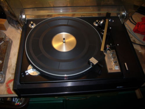

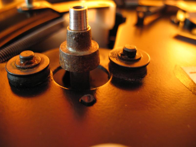

er , that looks pretty bad....
if that's what your motor spindle looks like, I'd dry to clean it up a bit. How do you measure the speed? If you use something that is not powered by AC, then clean up the spindle and check the speed . Or try to get an accurate measurement from a good ELAC of the same model as yours and have a motor spindle machined.
The ELAC is reportedly very good. Jean Nantais of Lenco "fame" stated that he started out with an ELAC and that he thought they were very excellent. I can't remember model he had (10H, 20H????).
Having never had the experience that TerryO hads had regarding a comparison, I can say that a beater Dual 1214 that I own, with a DIY tone arm compared very favourably to my Oracle , and my friend's Roksan Xerxes. The beater Dual cost about $60 including plinth and tonearm.
TerryO: I 'll PM you regarding "Kevin the Barber". Oh, and Merry Christmas and a Happy New year to all.
I think Stew is right on the money, it appears that there is a lot of corrosion on that pulley. I'd clean it up carefully with solvent and paper towel, see what I could get off first. Worst case some clean up with Scotch Brite bearing in mind that you could cause some serious damage to the pulley if not careful. Pits might be filled with body filler and smoothed by hand.. You need a very smooth running surface if you hope for quiet operation.

Yes that is the motor spindle. the 33 is clean that is one on the top.

Strong motor to. I think I will have to replace the motor suspension rubbers. I don't know where I get 2 PC.

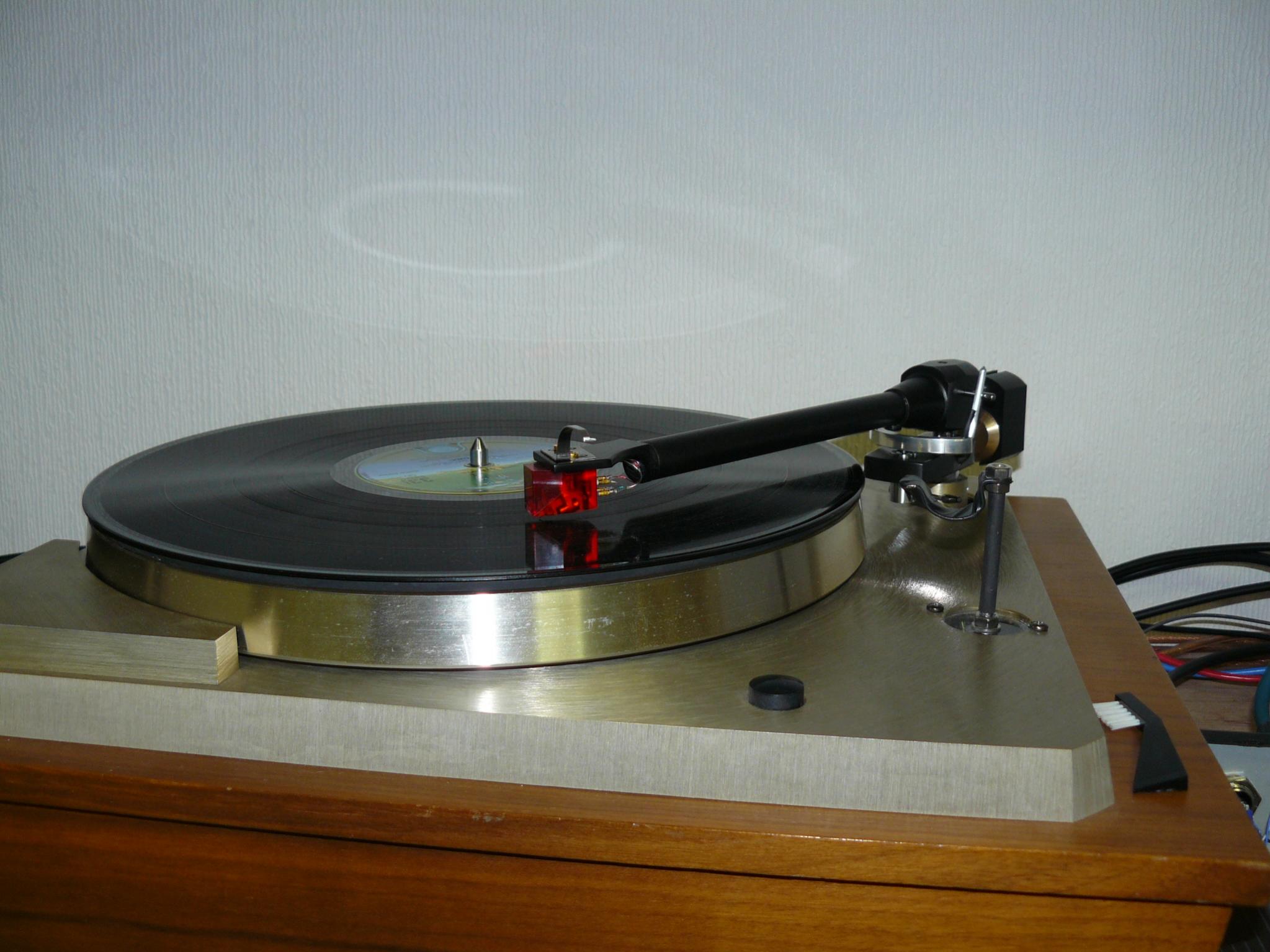

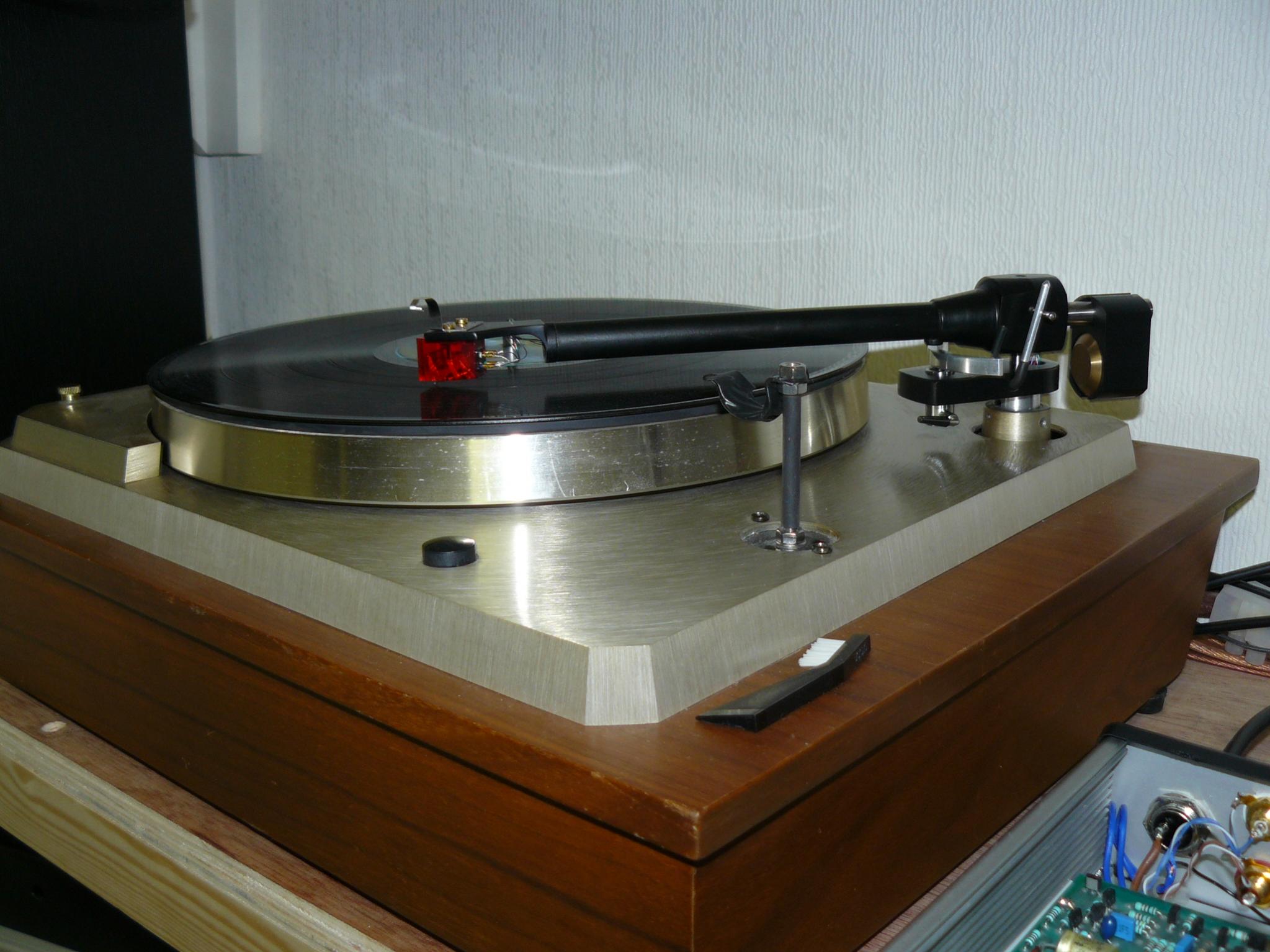

keep the ELAC...
... it's the right thing to do.

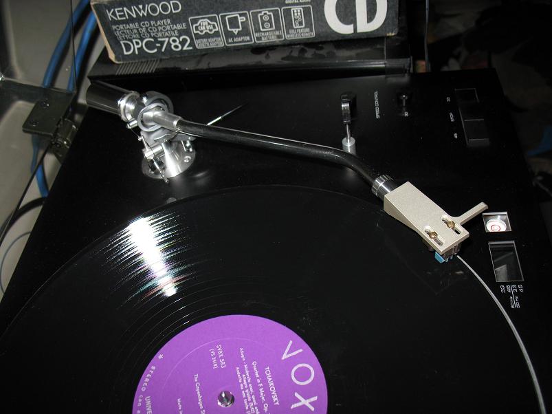

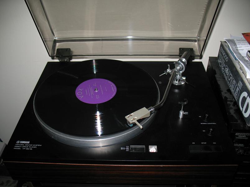

Which Dual?
gaborbela: I've gutted a couple of Dual 12XX models (a 1216 and a 1225) and a Garrard Lab60, basically removing the changer parts and as much of the linkages to make them manual turntables. I'm not fond of the old Dual arms so I make an arm (as per Altmann) or re-use an existing arm (I have a few kicking around). I have never gutted a Dual 10XX turntable, but I think it would be quite good as well.
Part of the issue with idler wheel noise can be attributed to the rather small size of the wheels (the Dual and Garrard Lab series) when compared to the Lenco style of drive which are quite large. Another part can be attributed (I think) to the use of bushings rather than bearings in the idler wheels themselves. I have a dislike for springs in any analog playback system, so anything you can do to remove springs in a Dual or Garrard Lab series turntable will help (I guarantee it!).
I never recommend using a good working turntable as a donor for a DIY project, unless you are willing to risk it. As I have a dozen or so turntables, I usually take the plunge. I have an old Garrard Lab80 that I will refurbish rather than take apart for that very reason.
Let us know what you might like to do, I'd be more than happy to help you along in any way possible.
